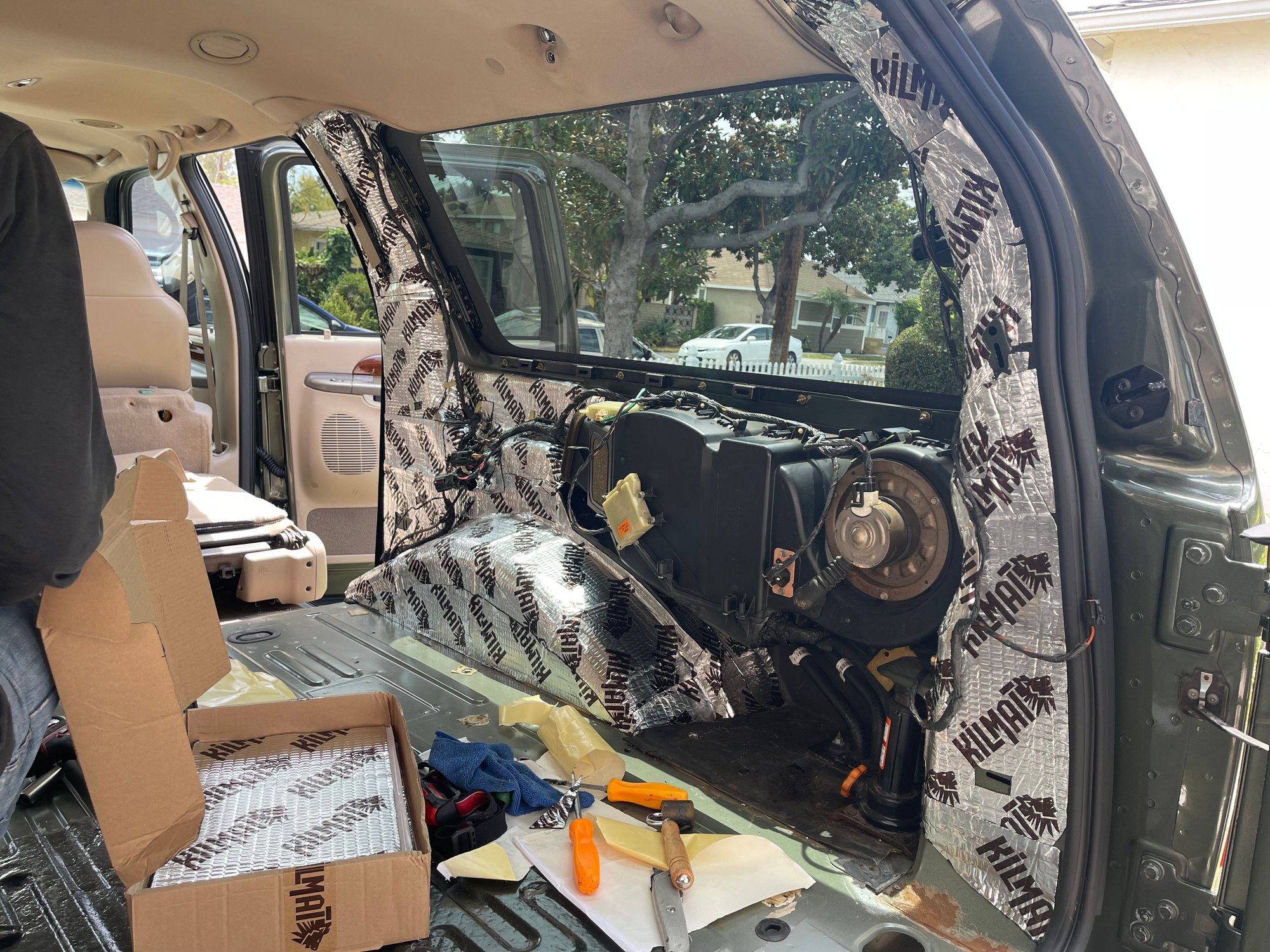

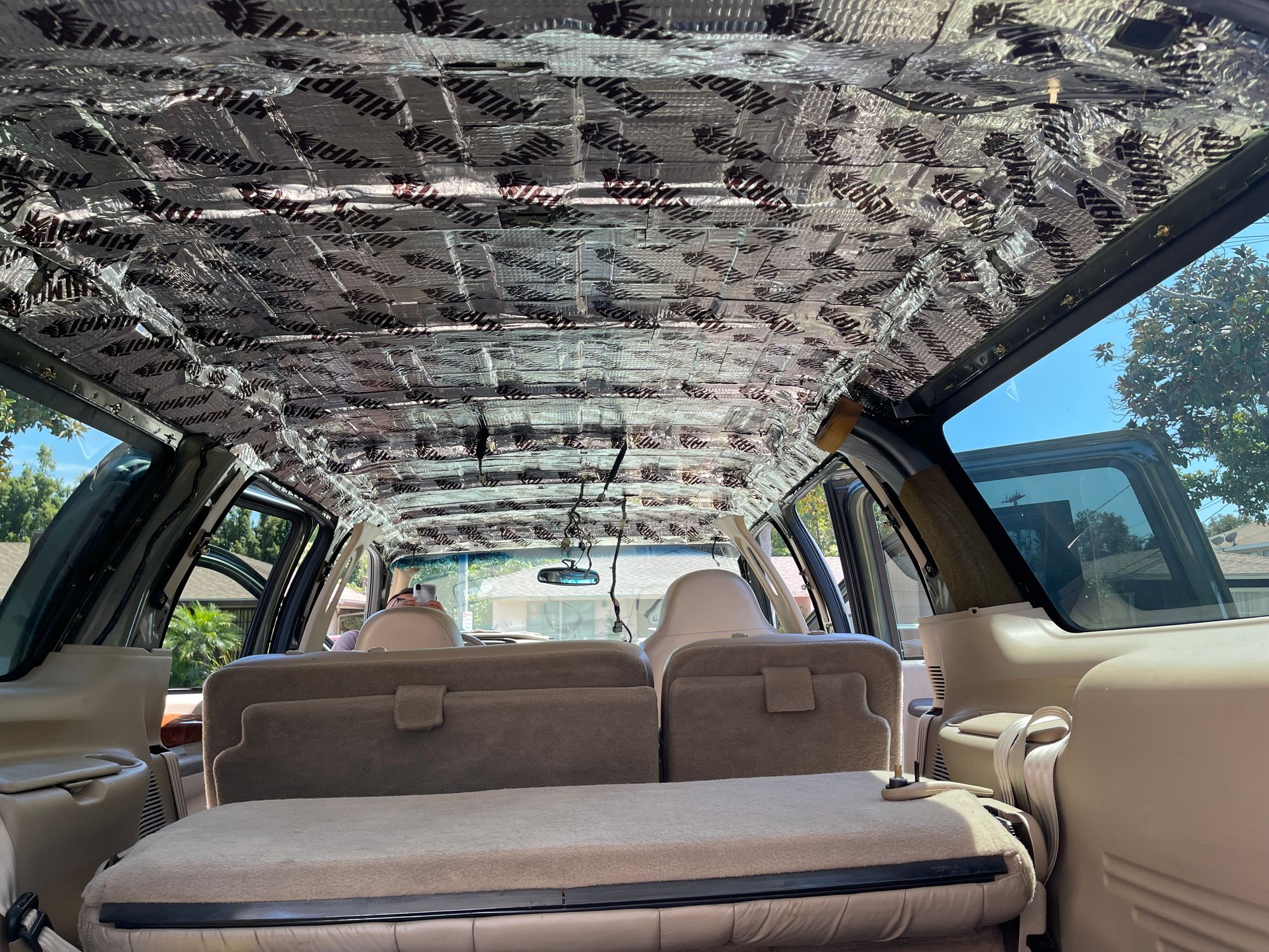

Sound treatment results

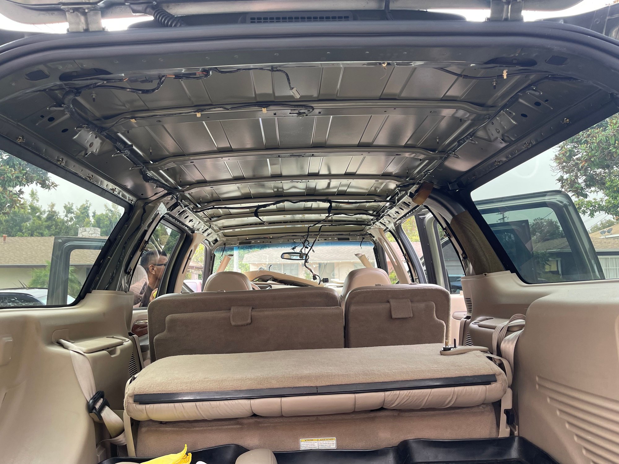

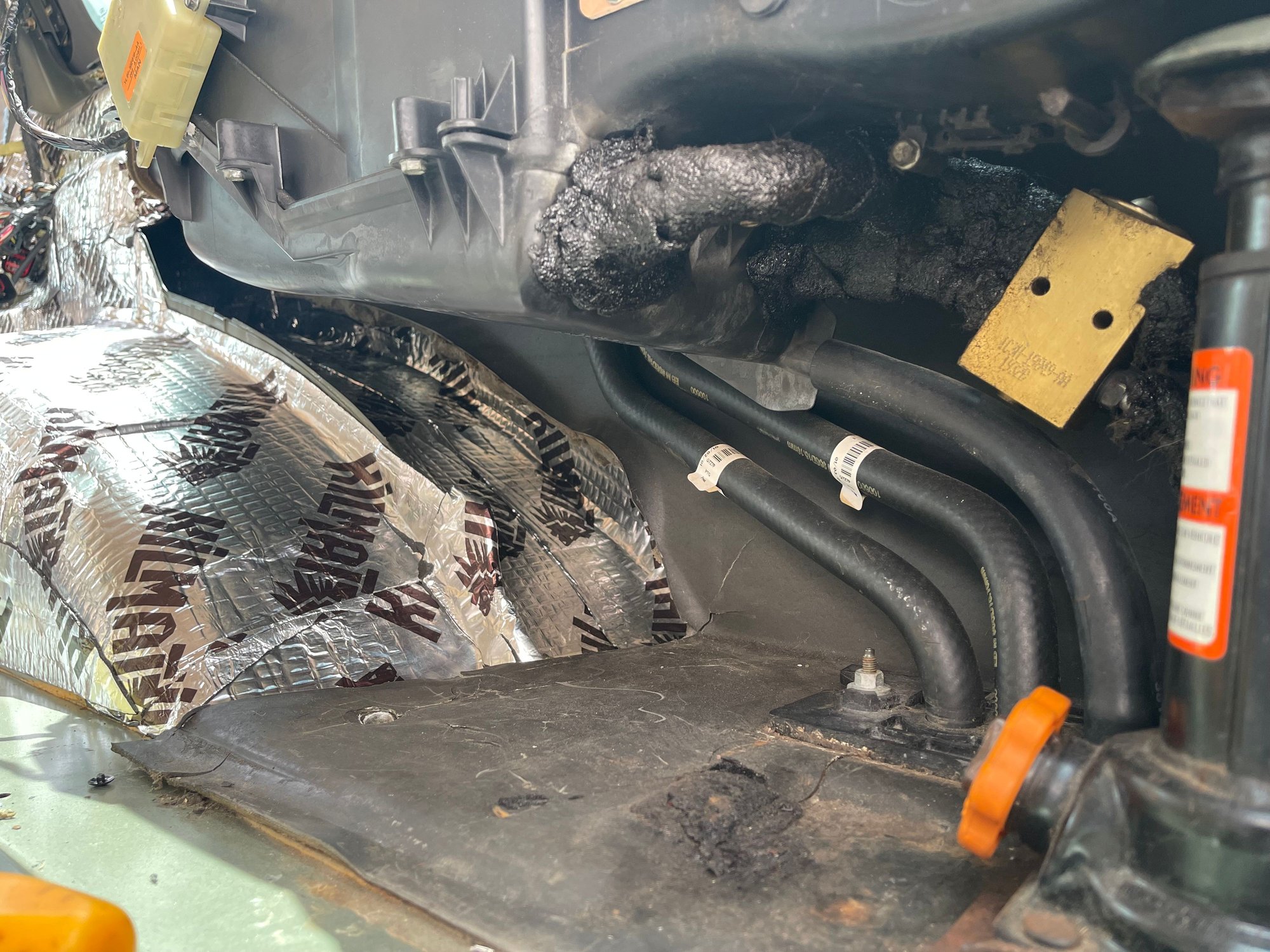

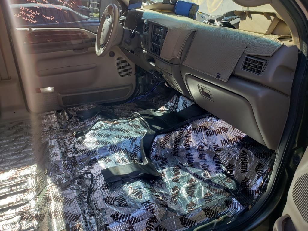

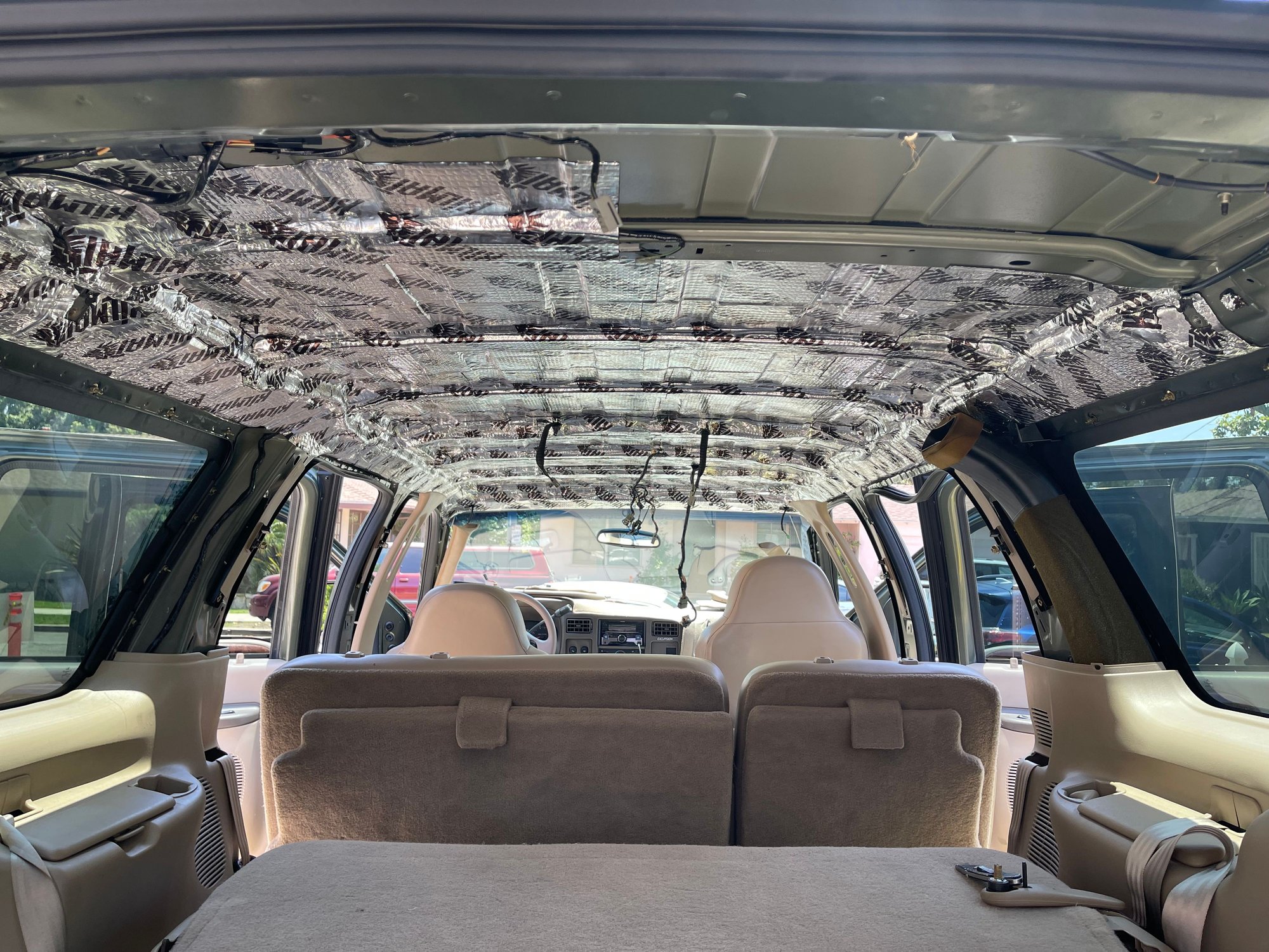

I thought I’d report on some sound pressure readings after all the sound insulation after enjoying the comfy quiet ride. The picture shows multiple screen clips from stopped and idling and at 70mph. Acceleration and deceleration were not recorded, only at stop and at speed. Readings were taken using A Weighting. The “Average” and real time values are to note rather than the Max.
It was a process over time but most everything has been treated including inner/outer door skins (all 6), the entire floor, rear quarter panels, and the entire roof above the headliner. Under the hood has been treated and color matched LineX on the roof.
The A/C is much more efficient as hoped as well.
The first and last readings are at still and idle.
The interior treatment included two layers of 80 mil Kilmat (butyl rubber equivalent to Dynamat) throughout. Even under the carpet and above the headliner. I don’t have the pictures but all six doors have treatment on both outer and inner skins.
Last edited by Rainmaker1; Jan 1, 2025 at 11:43 PM. Reason: Pictures of the interior treatment with Kilmat

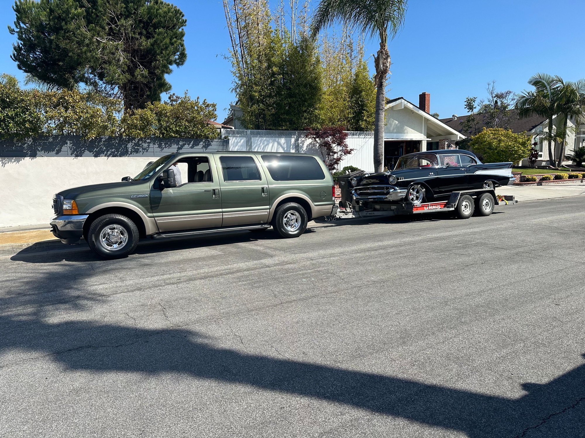

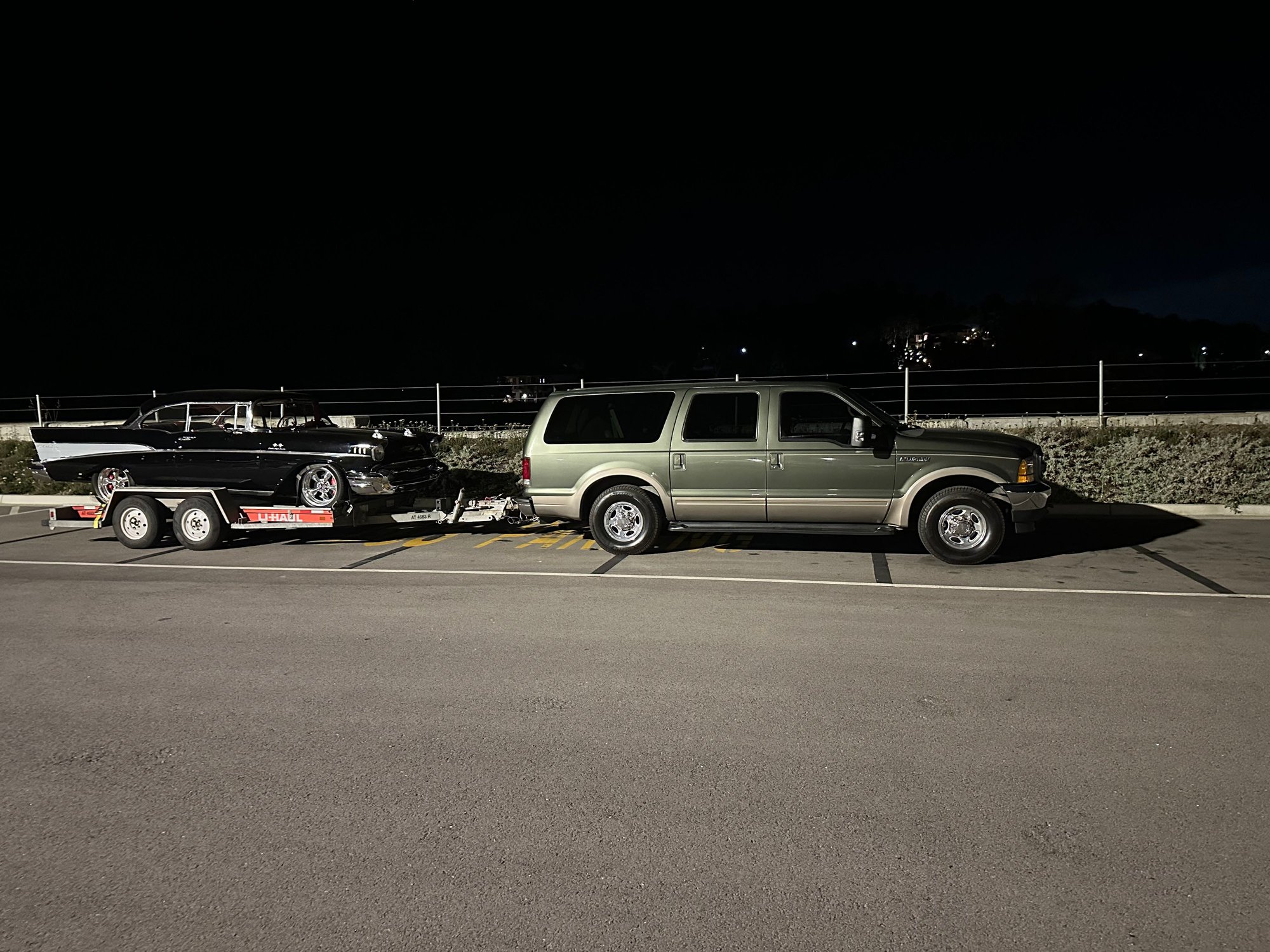

Transmission cooler installed today
Took it for a 300 mile test run with a friends 57 Chevy in tow. Driving over the Grapevine between Los Angeles and Bakersfield was effortless. My ISSPro transmission temperature gauge and 3-gauge pod overhead console arrived today but didn’t get it in for today’s drive. I can only assume everything is working great but don’t have any ideas of temperature. My hopes are to have the gauge installed in the next couple weeks. It’s unfortunate because I would have liked to see what the temperature was.
I’ve read many articles about where the sensor should go and popular opinion suggests where the test port is located. The claims are that it’s a much better place than in the pan.
Any thoughts or recommendations from the experienced experts?
