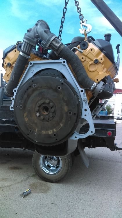

No need to take out the radiator support for engine removal. I can't remember if I took of the turbo, but the Up pipes and collector stayed in placed when I removed mine.
Now that I zoomed in the first pic looks like I did remove turbo, and had a head off when my power plant gave up
Here's a few pics of the new engine going in

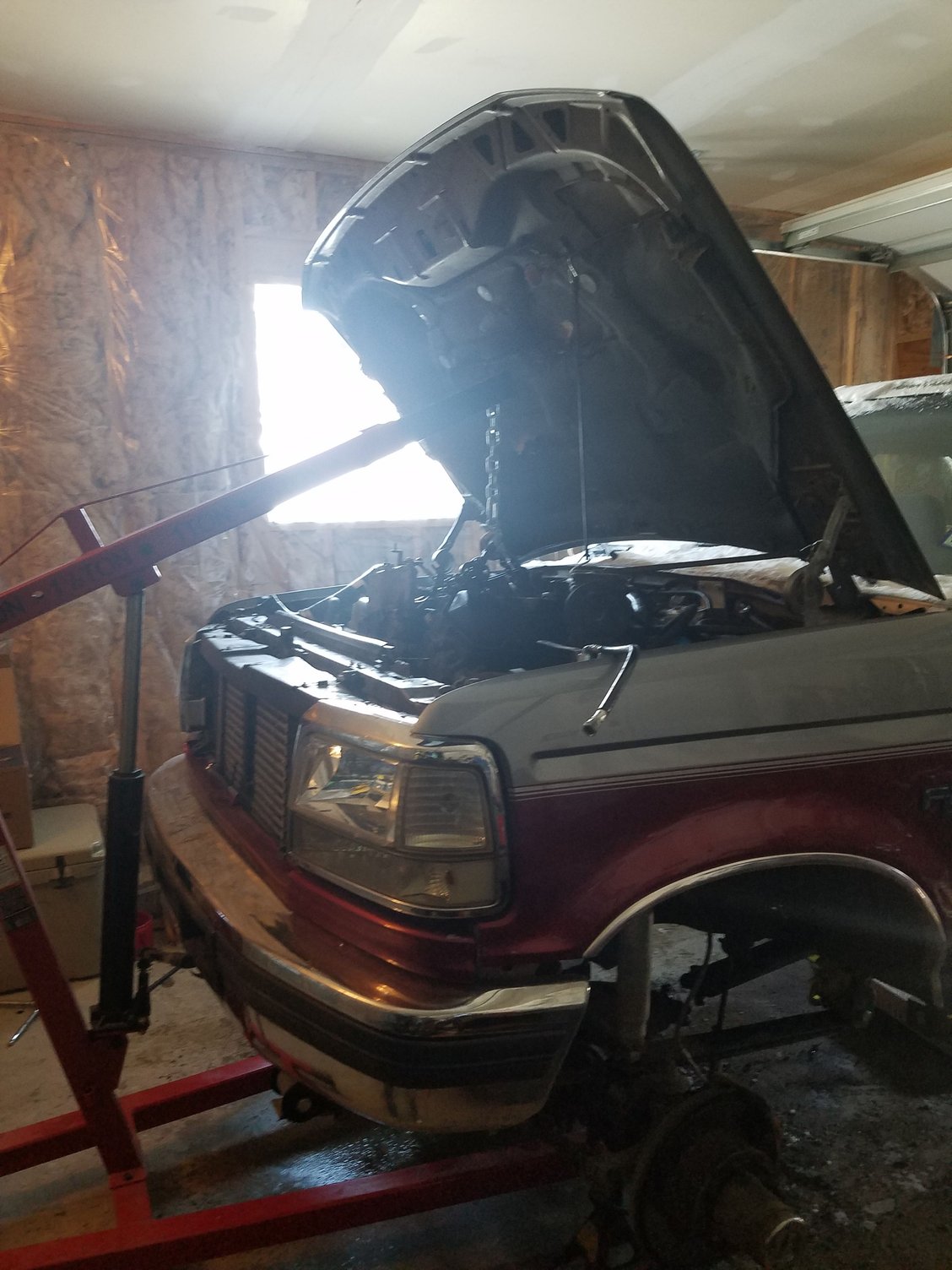

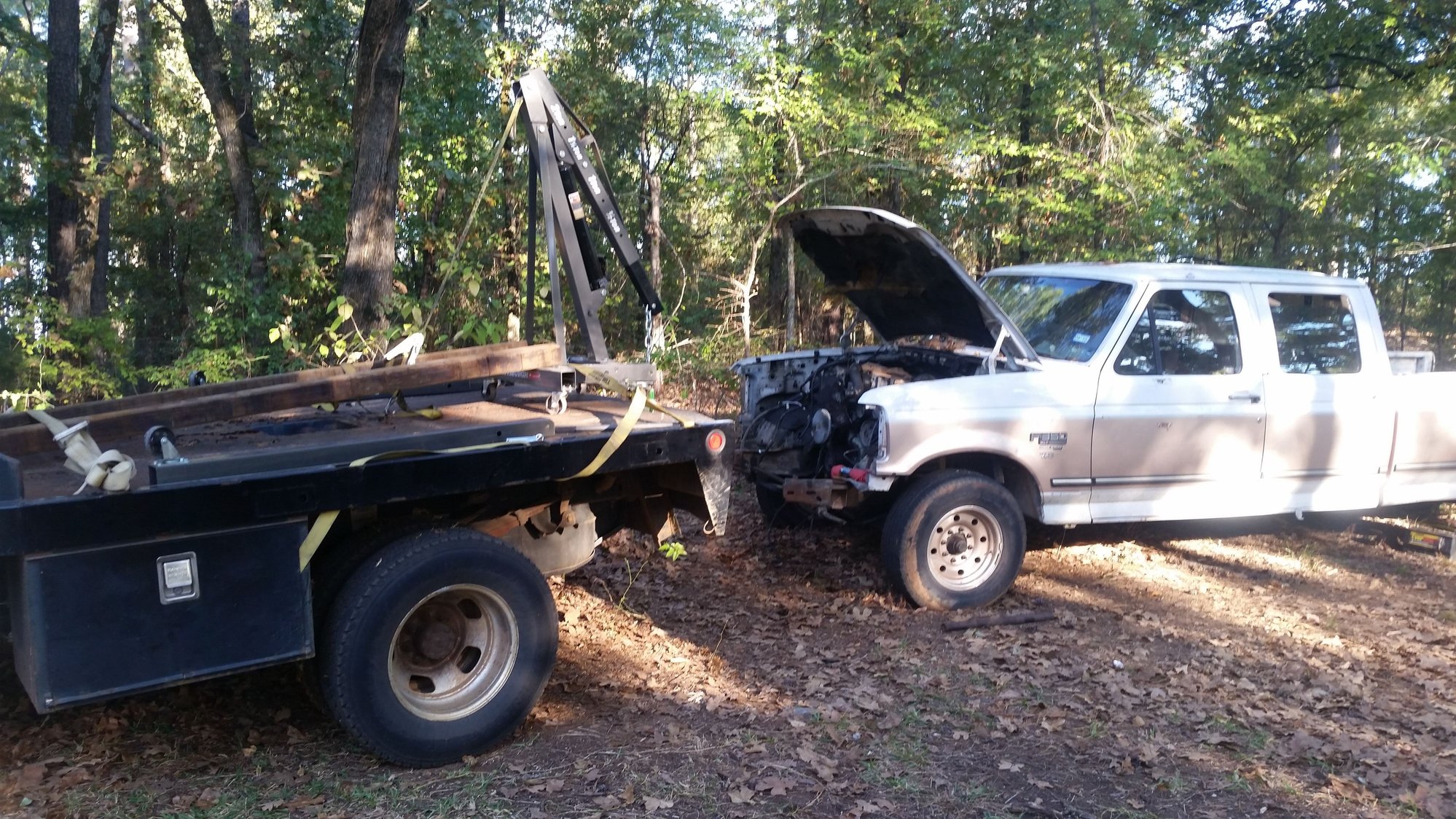

I have photos of three engines I've pulled out. Two had a removed rad support and one did not. The ones I removed the rad support, I left the turbo on. The one I didn't remove the support I had to take the tires off the truck, set the axle basically on the ground, and remove the turbo.

Was not able to get my engine out without pulling the hood. After that it was no problem. did not have to take tires off or anything. Guess it depends on your picker. Turbo had to come off.

Holy Crap, That's high up. I am using the same hoist. HF. That scares be a bit working by myself. LOL. I have the time to pull the rad support. I can clean everything up and check all the grounds and lube all the fasteners. They all came out ok.
