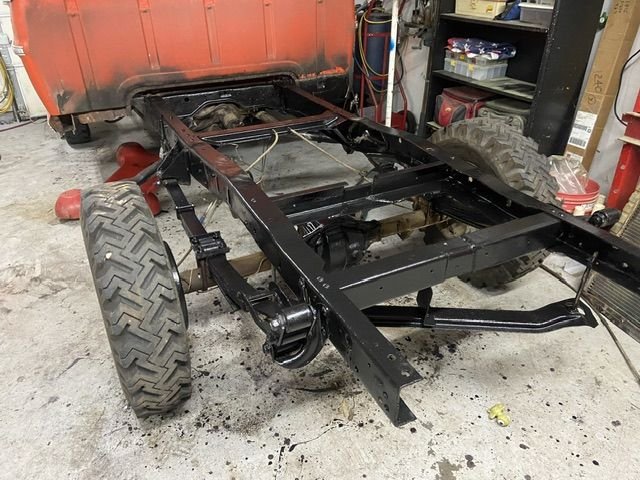

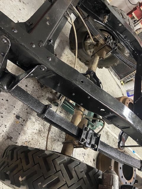

Rear frame painted

Nice . Is that the poor paint. Rust oleum?

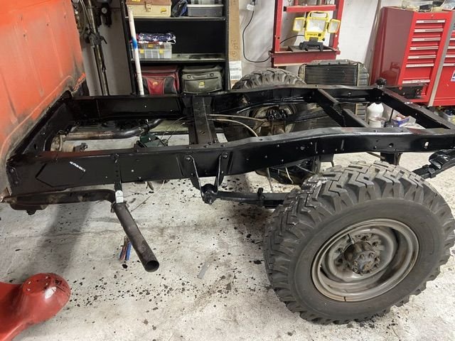

This is not a knock, just a pure question. Is there a reason you didn't Z the cut instead of going straight up and down? Seems that would be a little stronger but I'm not an engineer. Again just a straight up question.
The other thing I would do is probably throw a few bolts in the plate you welded over. I've seen welds crack and things fall off. Cheap insurance. Probably overkill though.
Looks good regardless.

I thought about it when I cut the frame but with the difference in width it would be more difficult. The 2wd frame is 6in and 4wd frame is 7in. Also the bottom of the 4wd frame was thin going any future back. I am no expert on frame repair but did research it before. While doing z cut would defiantly be stronger I think this splice is more than adequate. I will be the first to know and time will tell. I work on buses and trucks as my day job and the way they splice frames on them looks terrible. Mostly cutaway f450 and e350 torch cut and weld in extension. No grinding or paint removal, but never seen any crack.

Yea I’ve seen a few truck extended and shortened and it’s amazing they don’t brake. What you have is sufficient I was just curious.

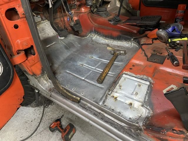

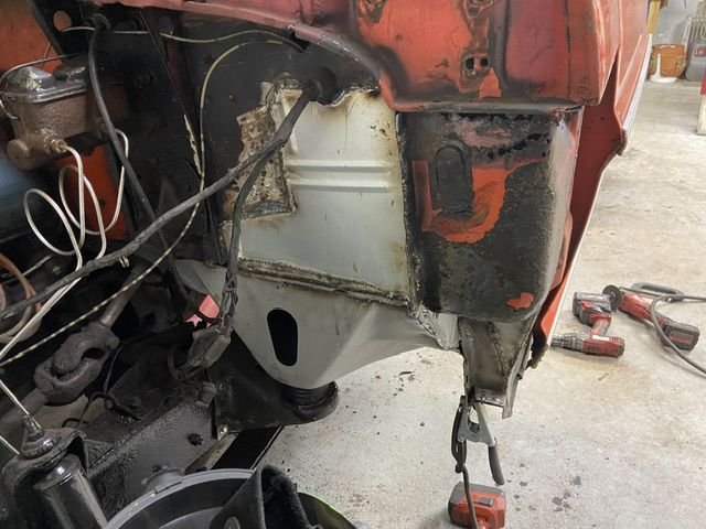

Where did you get the panel that goes in the door jam and curves? Lower front edge of door? Also the inner kick panel?

Everything came from tabco, the inside kick panels and firewall patches I made. The lower rocker to cab panel is from tabco. It did not fit very well but I was able to cut it up and make it work. I cut some panels from old crown vic hood.

The tabco rocker panel is too short, I was able to find perfect piece in my scrap pile. The u channel off of a stake side panel fits great. It slides inside of rocker and lower section of cowl. It is the black bottom piece in this picture.
