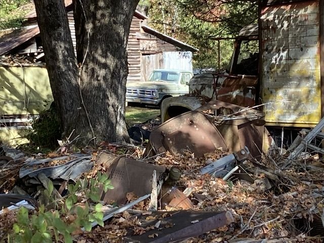

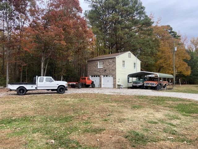

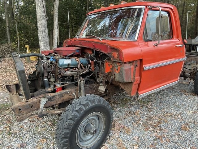

Found another truck while working today, body is rusty but hood and grill look mint.

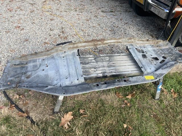

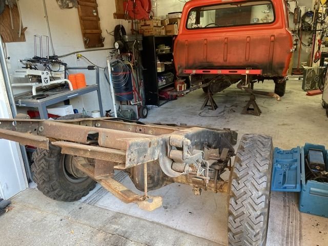

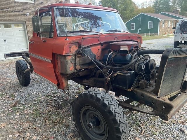

Removed the rusted out radiator support and fenders. Both inner fenders are in good condition, hood is decent besides smashed corner. I have a good condition radiator support for as 76. Looks like it will work with some small changes and a few new bolt holes. I have a useable bed that needs repair on front floor.

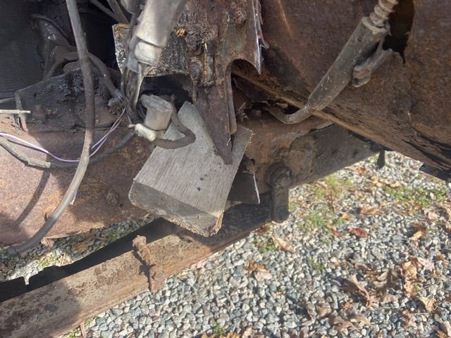

Cab is ruff and needs cab mounts, floors, inner and outer rockers. Fire wall has some rust along pinch welds above cab mounts. The cab mounts on frame are shot also. I have good parts truck frame that can donate a pair. On the positive side roof and drip rails are solid.
Old Nov 5, 2023 | 08:41 AM
  #36
Vabow's Avatar
Vabow
Joined: Jul 2018
Posts: 954
Likes: 575
New cab mount installed

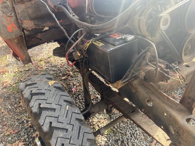

Battery tray installed to keep it mobile

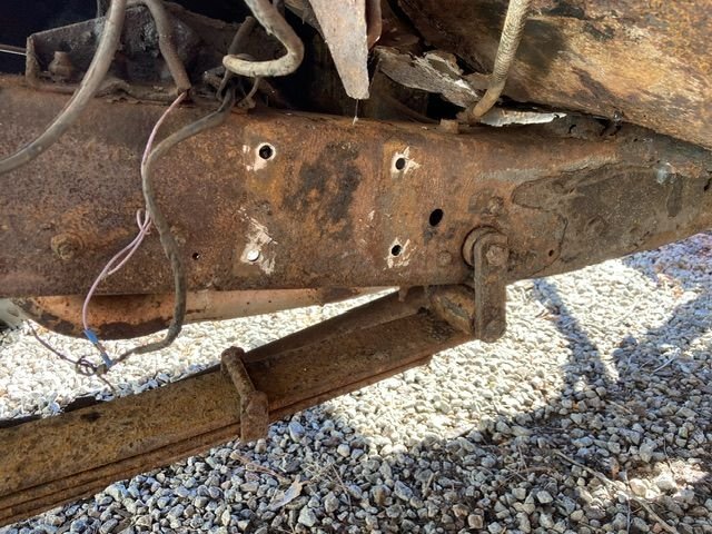

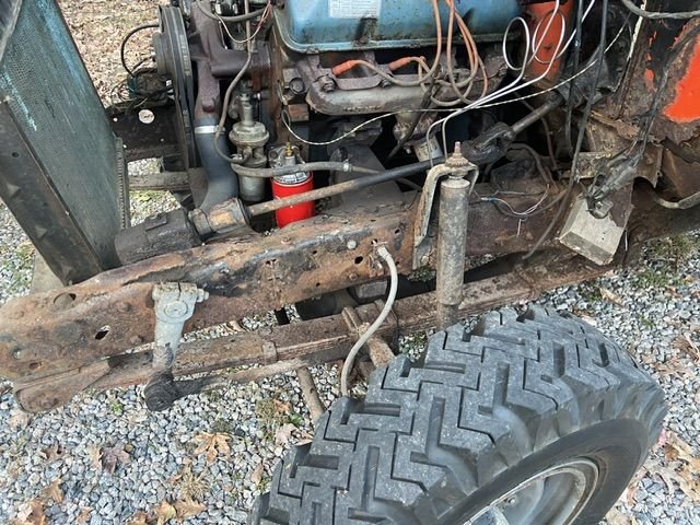

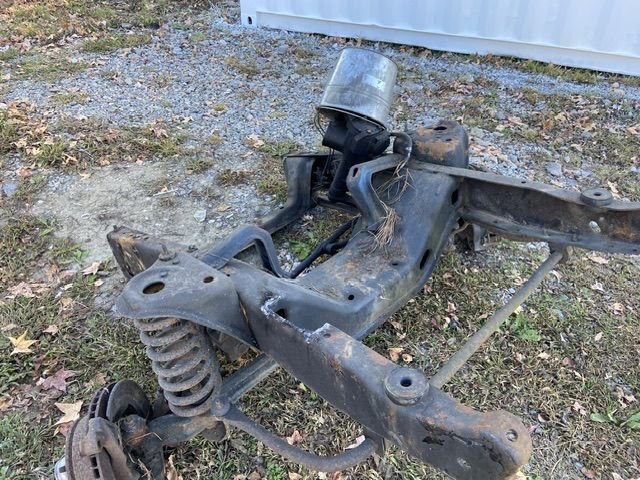

Cut the cab mounts off the frame and cleaned up the frame some with needle gun. Also pulled spark plugs and checked condition. Everything looks good, confirmed it is a 360.

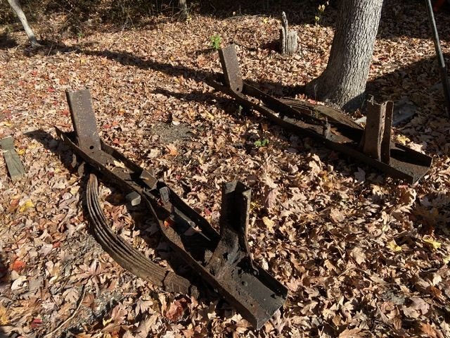

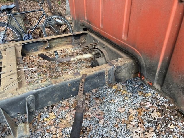

Took parts truck to work and cut off cab mounts and rear section.

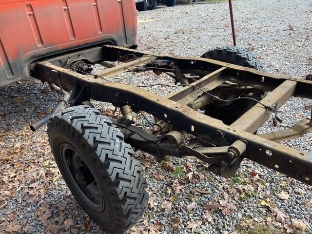

Anyone need any parts of this before it goes for scrap. Nice tight front power steering and disc brake 68 camper special.

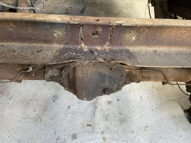

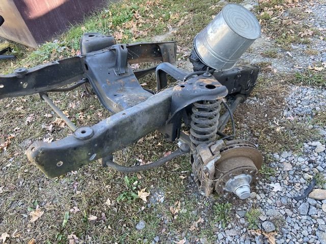

One way to cut the rust off

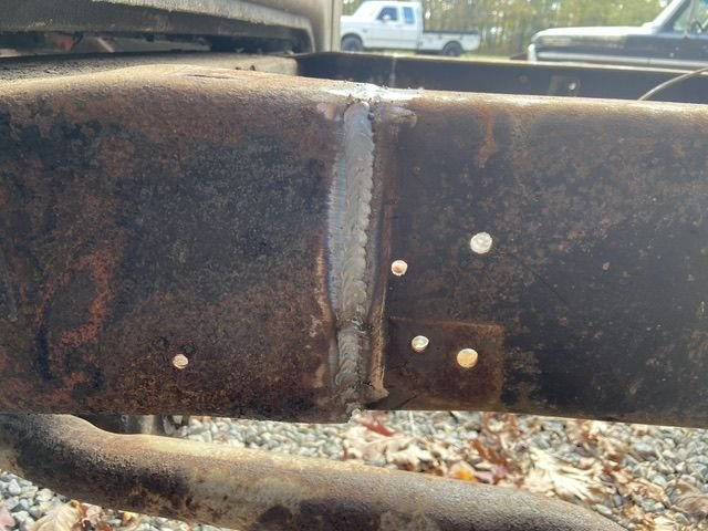

Old Nov 12, 2023 | 11:00 AM
  #43
Vabow's Avatar
Vabow
Joined: Jul 2018
Posts: 954
Likes: 575

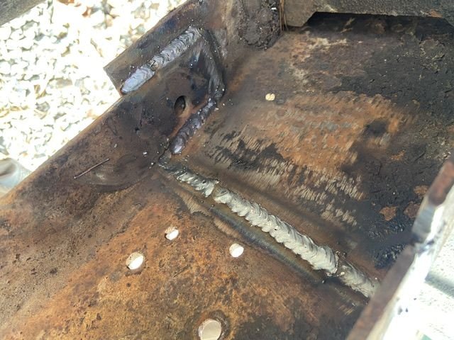

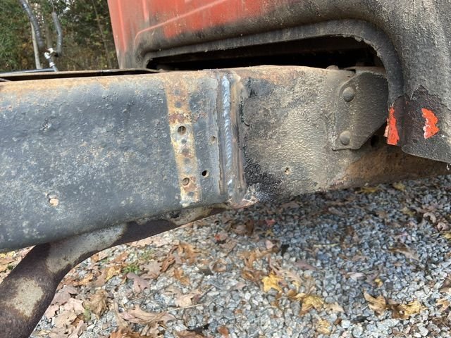

Back together, I will make some fishplates to weld in over splice in frame.

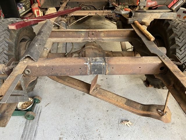

Repaired crossmember that was cut up
I think it had some hitch that was cut off, still need to repair forward one.
