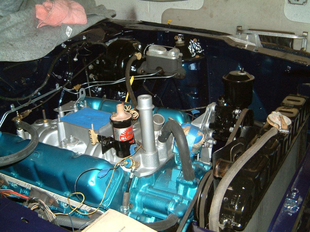

The first motor in my drag car was bright yellow.
When I had to build another I went with the factory color for a 70 AMC
My street AMC motor started like this
A good cleaning and factory color looks like this
Set in place what one would you want to see when you pop the hood?
Dave ----

Old ford blue on my 351c.
I painted my bronco engine ford grey
