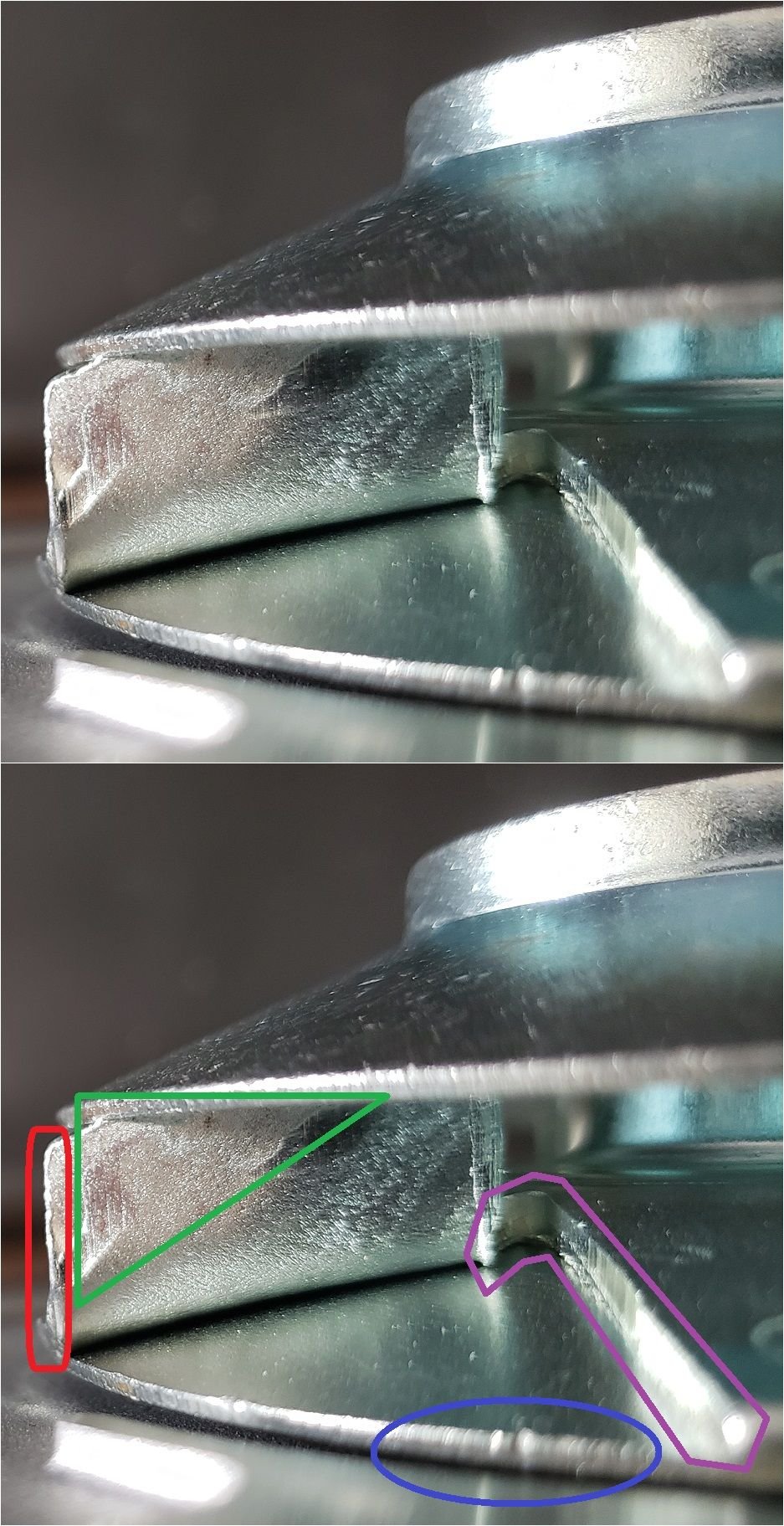

Generic question: Are Gates water pumps built by walruses or something? I've used Gates for a long time and had good luck. For this vehicle, I needed a new water pump and ordered up a Gates unit. It has great reviews, and I bet it will last a while, but this caliber of manufacturing has me astounded. The other choices at Rock Auto and other sites looked to be of similar caliber.
Warning: This picture is of a water pump for a non-Ford engine. There is no non-Ford section at FTE, but I felt that my best bet for getting viewed by someone with useful answers would be here.
- Is this edge chewed to shape by a beaver?
- Did this section of sheet metal sit in the weather for half a century before being stamped and zinc plated?
- Was this hand-cut by a 50 year old press in a dusty shop at the end of a small footpath on another planet?
- Was this ground to dimension by a guy eyeballing it and mashing it against the coarsest grinding wheel in history?
. . . or has Gates gone downhill while I wasn't looking?
The OEM pump that was installed by the dealership 120,000 miles ago wasn't much better looking in these regards.
While I'm here: Has anyone gone about smoothing corners etc. to reduce cavitation or improve pumping efficiency or the like? Hopefully this one is installed for the next 100,000 miles so I'd just as soon make it slightly better before I put it in if I can.
Yes, a little bit of a rant, but also curious if others have seen this elsewhere.

I see what you mean. I'm not looking for polished and perfect, but this just seems like poor quality and finish for a Gates pump. I guess the "Made in China" stamped on the box means something. As long as it has a Gates quality bearing and seal I'll be happy. If I were a shop, I'd slap it in there and not think twice about it.

I agree. I've been bit a few times doing that too, often when Napa had changed ghost-manufacturers on me. Most water pumps that I've dealt with have been open impellers, not enclosed like this one. Those tend to be cast or single-stamped, and the single-stamped ones look way better quality than this.

Thanks, I appreciate it! I just looked at pictures at Rock Auto. 5.4 open- and enclosed-impeller pumps generally look like what I'd expect from an upper-tier brand like Gates. Smooth stamped edges, unblemished flat surfaces, etc. I'm curious what you find when you look at yours.

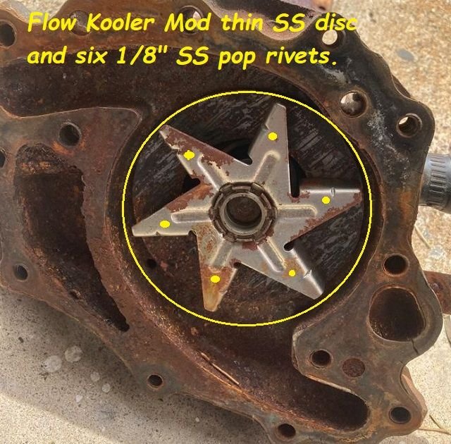

I have added a stainless steel disc to the impeller to keep coolant on the vanes, using stainless steel rivets. My first one was on a "Flow Kooler" water pump, I liked the idea. They used to offer the disc alone as a kit, or whole water pumps
Like that
Like that
Sorry, just saw this. How well does this hold up? I'd be concerned that the rivets would rot away or loosen with heat cycles or something.
