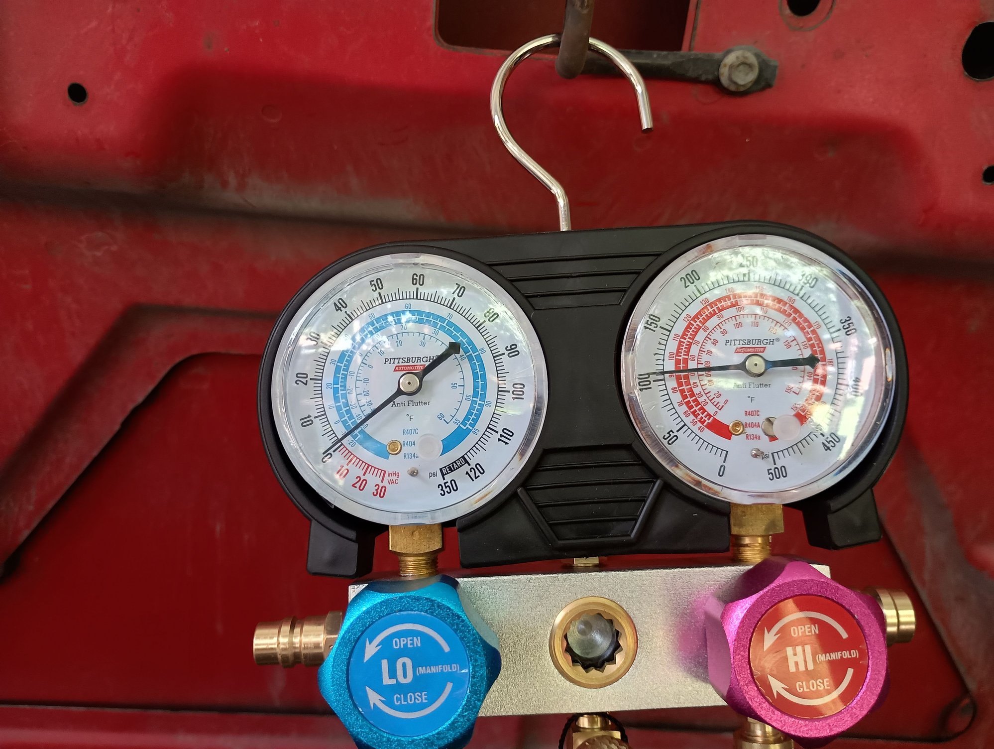

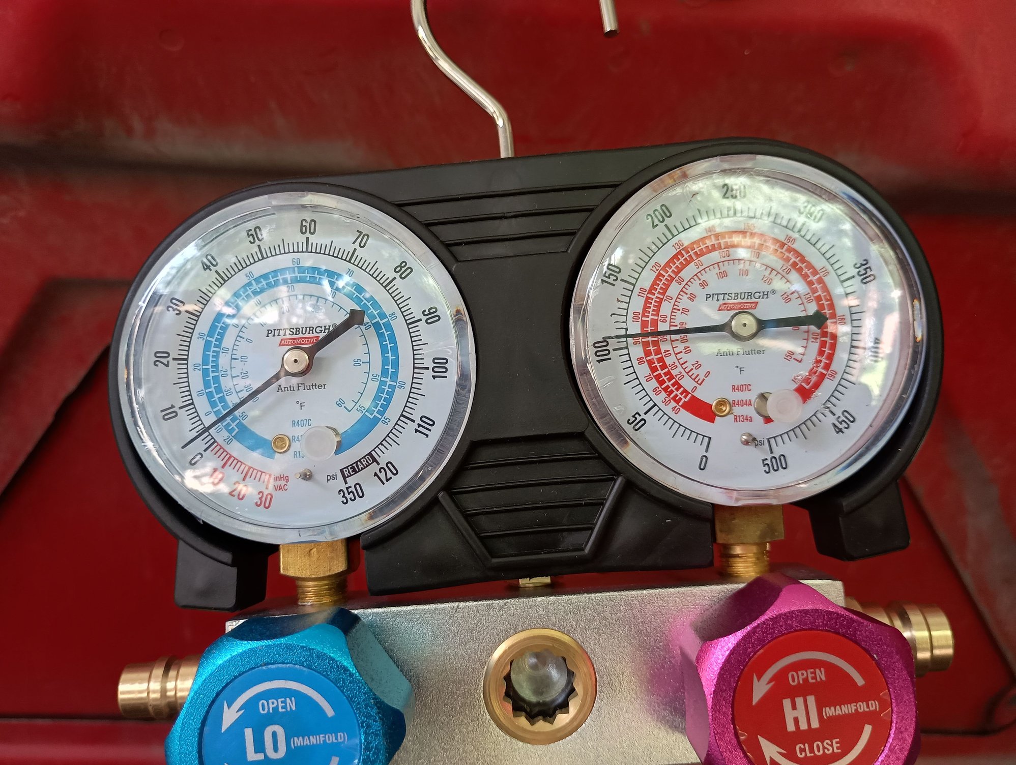

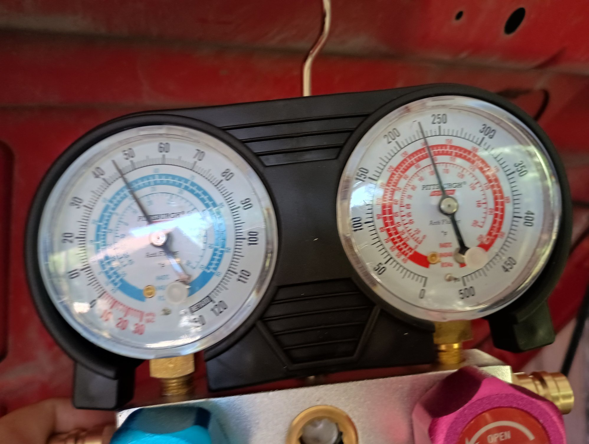

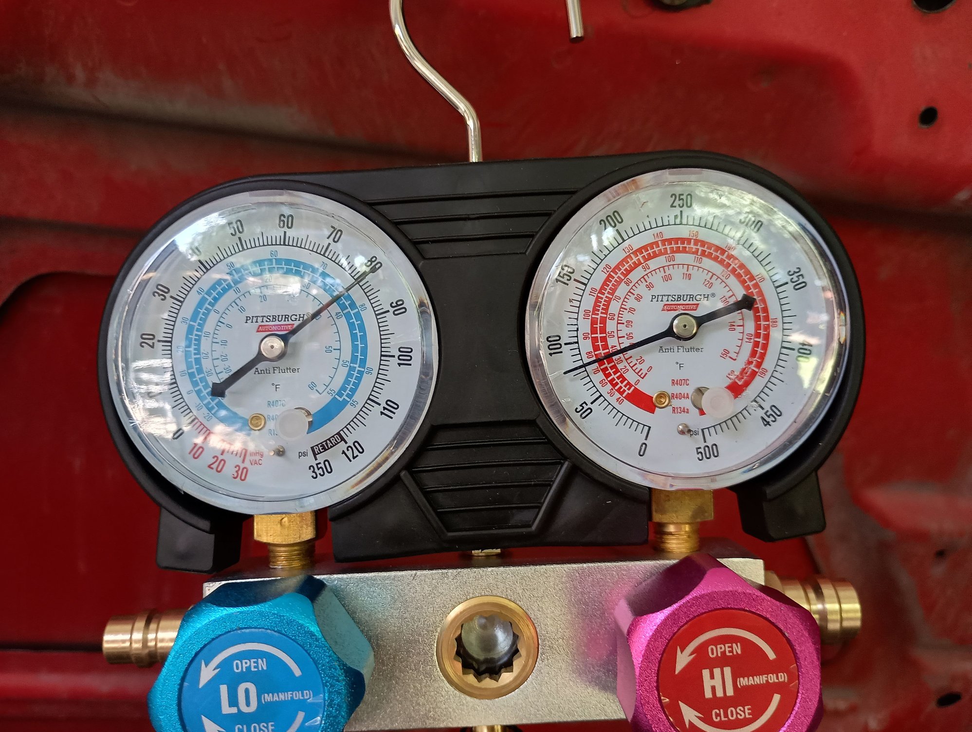

Anybody wanna take a look at some gauge readings
Engine off AC off
Engine on AC on
After running rpm to 2000 momentarily not much change
Engine still running AC off
Disclaimer: I don't know anything
It looks to me though like a restriction in the system. However doesn't it look like the low and the high are trying to equalize somewhat quickly?
Watching videos etc I thought if the expansion valve was stuck closed it the high and low side pressures would take a while to equal back out.
Any suggestions welcome thanks

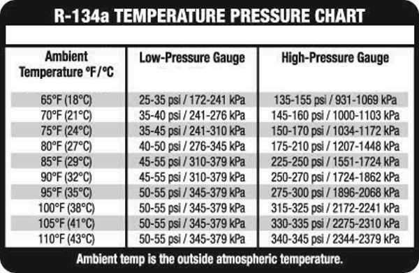

you are very low on charge. engine off and engine running ac off readings mean nothing.
i charge by this chart:

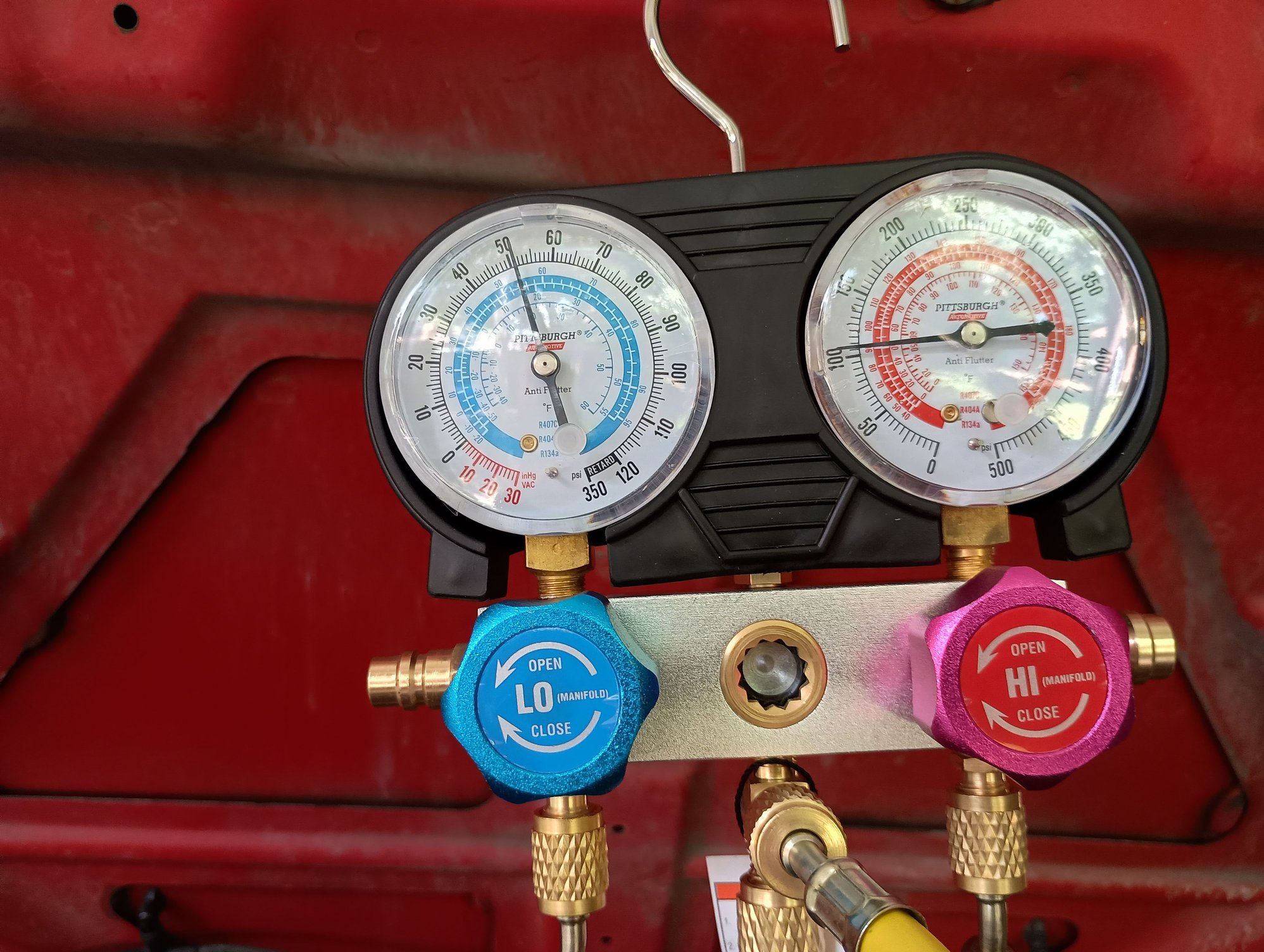

Old Sep 4, 2025 | 03:08 PM
82_F100_300Six's Avatar
82_F100_300Six
Joined: Jun 2008
Posts: 2,875
Likes: 30
Thanks Boss
Put in one can
Sorry that's all I got before I saw your reply
Hope it doesn't leak out.
I guess time will tell.

those look good. hopefully you do not have a leak.
