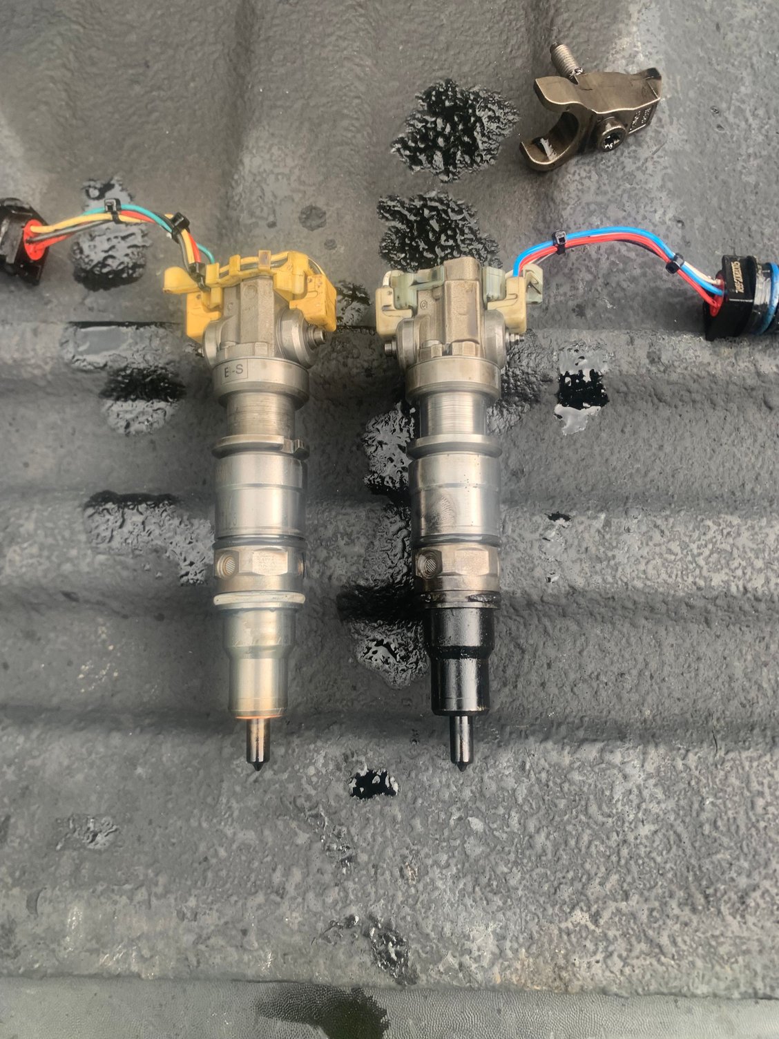

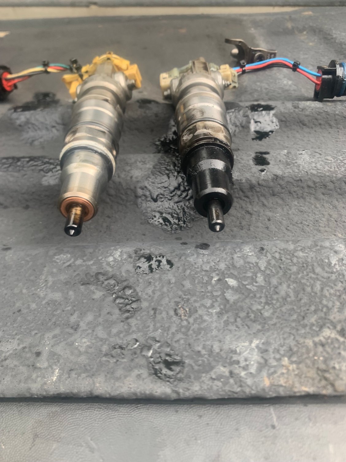

On the left is an injector that I pulled one that was not replaced. On the right side is the brand new injector that was replaced (cylinder 5). O ring is broken and no copper washer.

I think you found your problem.

A 6.0L owner has to buy quality parts!

And then actually install them. I expect the missing crush washer caused the oring failure. Tech prolly found it on the floor sweeping up later.
