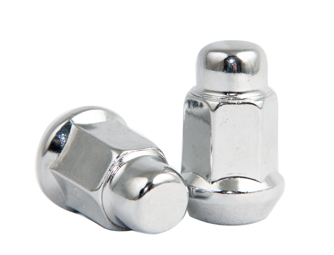

What type of lug nuts are installed? Stock open-ended style? Or the closed-end "acorn" style, as seen below?:
If the acorn style, maybe they are bottoming out (and seem tight) before the wheel is 100% clamped against the brake disc and hub.

@kr98664 Factory lug nuts. Highly doubt its this issue.
