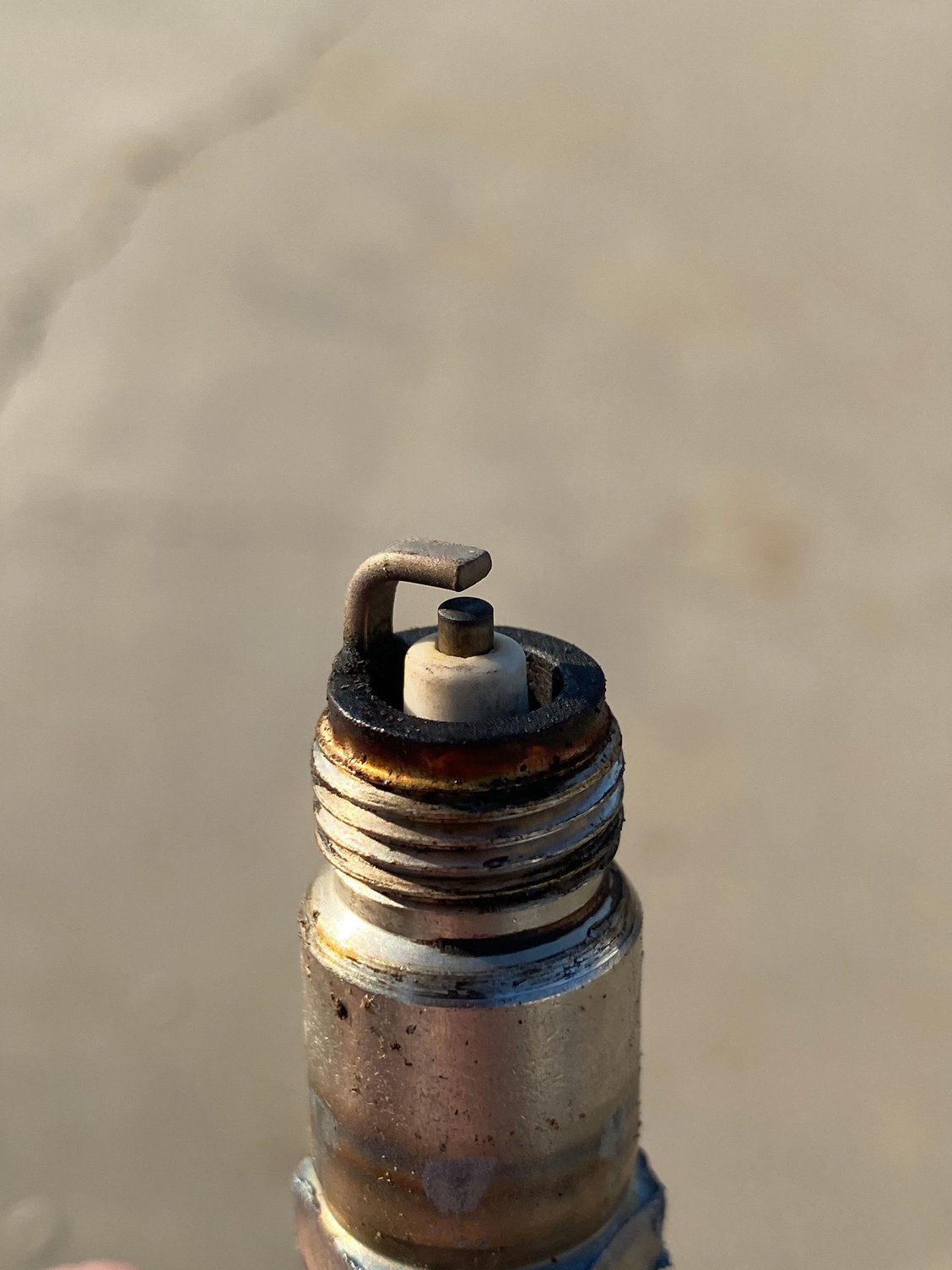

Update maybe misfire
I did some test driving and inspecting today. I don’t see an issue in the drivetrain and the vibration has lessened and I can feel a periodic quick shake at idle and accelerating. U joints looked good no play in them. I pulled KOEO codes got code 32 CM. And then did KOER got codes 44, 77, 52. I didn’t do the brake petal smash or turn the steering wheel. I forgot to do those 2 things. I just did start it press test, mash accelerator and read codes. I didn’t think my truck had a pressure switch as well. But apparently it does I’ll redo test but I can’t right now.

I didn’t shake it up down, in and out. I will do that. The only rotational play is in the parking pawl both yokes move with the driveshaft in that play. Also I didn’t feel it as much when cold but I was on my dirt road going back and forth a bit so when it started to warm up was also when I went out on the roads. But I didn’t feel it when accelerating the first time on the road and then I stopped at a light and started feeling a periodic shake.

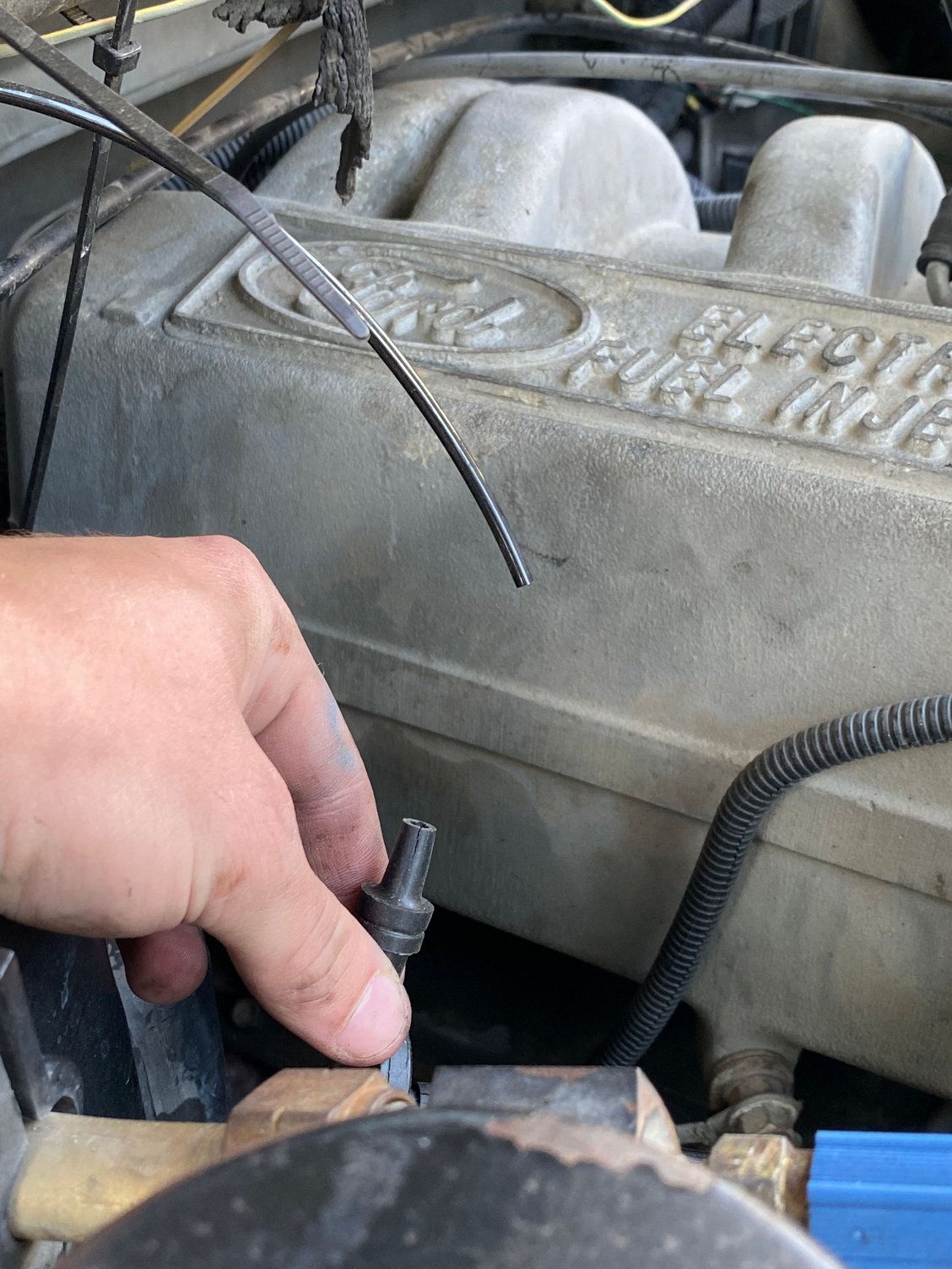

Why do these keep cracking I’ve replaced all the ones I’ve touched and all the new ones crack and the dry rotted ones are still going strong after 30 years.
Is there another brand besides dorman that sells these? Most of the ones I see are plastic ones.
