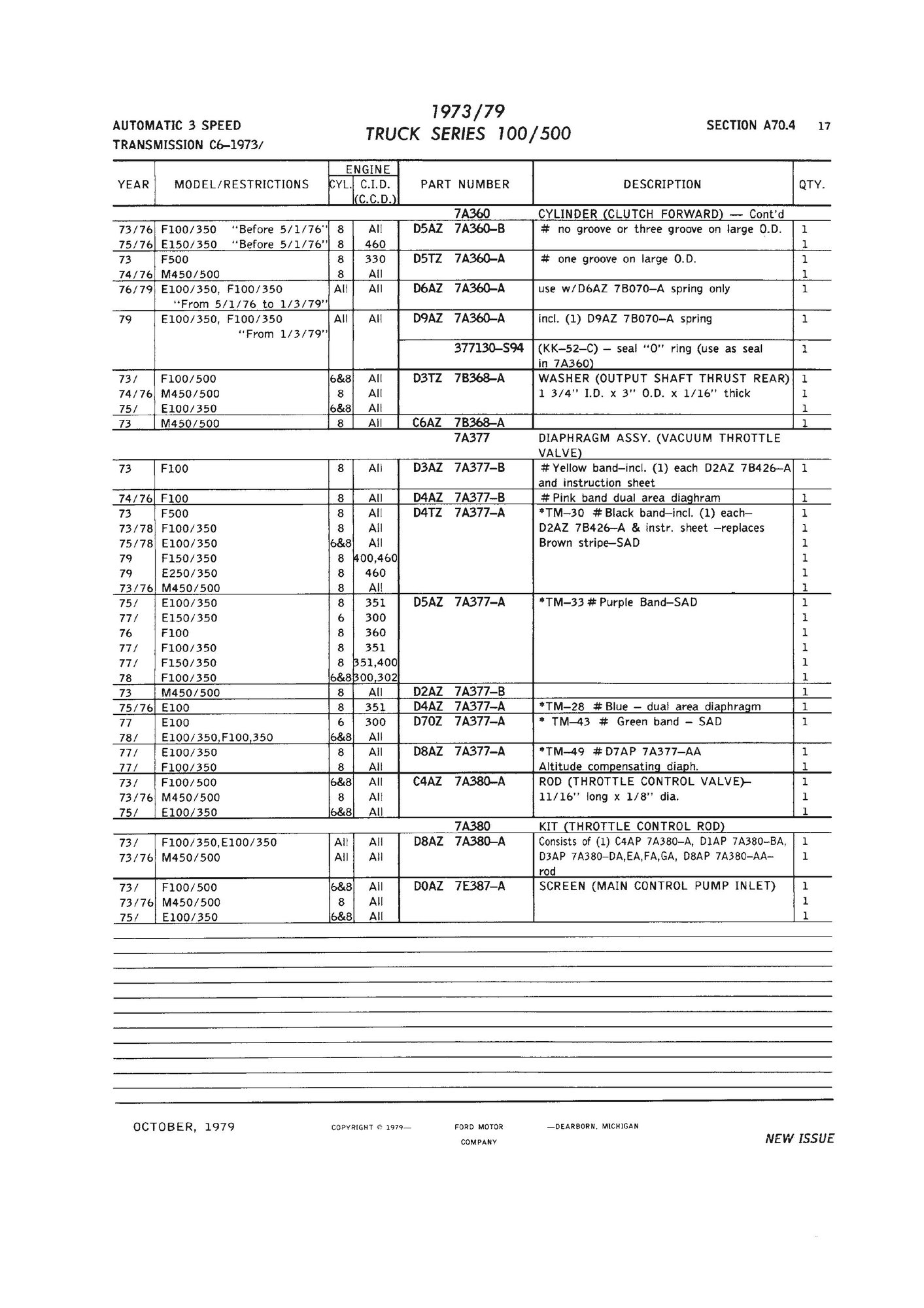

That "about 3 inches long and about 3/16" diameter" seems way-way too big.
C6 Modulator valve pin - Ford Truck Enthusiasts Forums (ford-trucks.com) is a thread with some good information.
Modulator valve pin - Ford Truck Enthusiasts Forums (ford-trucks.com) is another one.
Google " c-6 modulator valve pin " and you'll find more on this pin, length, etc. Not to "pass the buck", but none are near 3" long.
