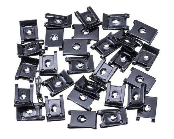

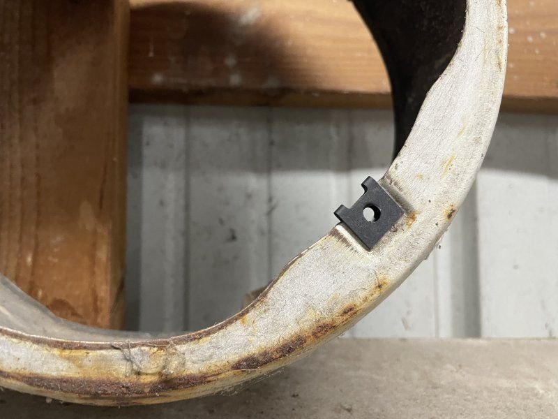

On the headlight bucket to grille hardware: they're C-Clips, not J-Clips. (Sometimes called U-Clips) At least they are on a '53.
You can buy them almost anywhere. Lowes, Home Depot, AutoZone, etc.
I used Hillman 10 X 11/32 and #10 stainless screws. Your mileage may vary.
