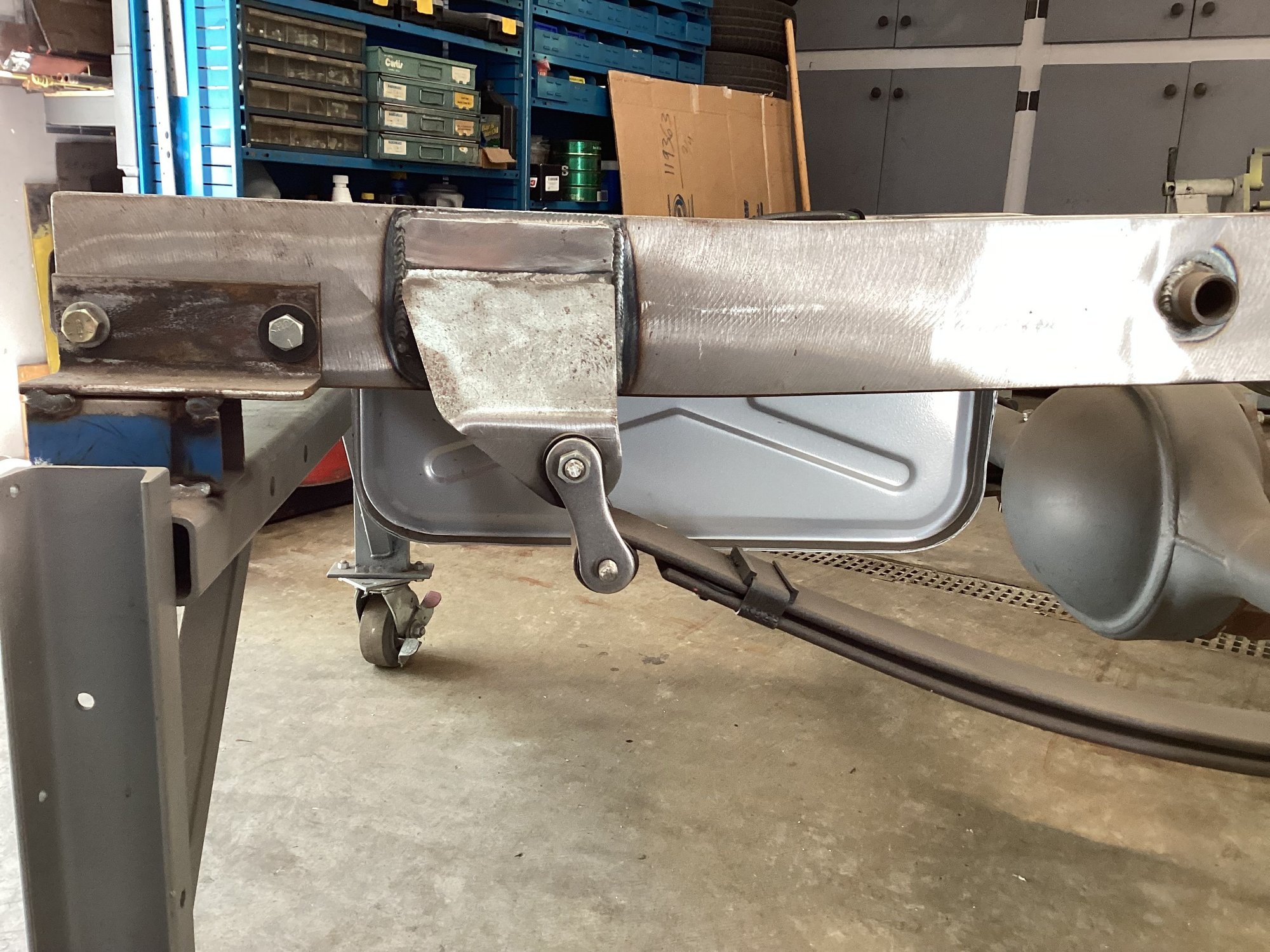

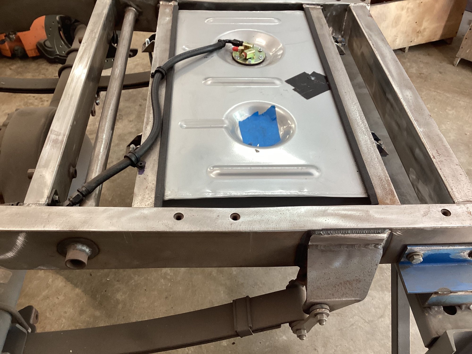

I used a Tanks gas tank and straps on my TCI frame. Angle iron. 3 1/2” between the rear tank mount and the frame rear crossmember.
