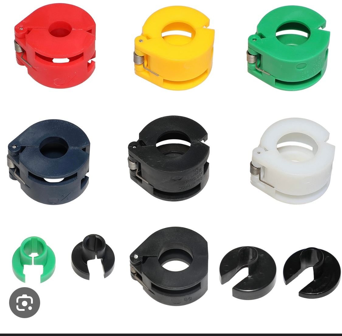

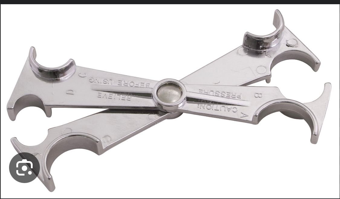

Originally Posted by Anonymous12
Which one of these is the right one? I see both when I Google it.
Get the colored ones and use blue. The hole w the lip goes down, inside the blue tool. Put tool on the line under neath the spring lock. Pull it up snug; then pull till it feels like it went into the spring lock. it will come loose.
