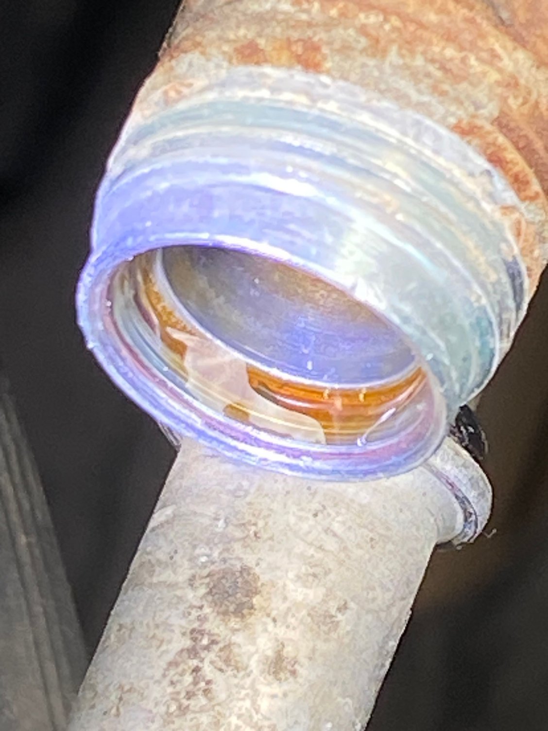

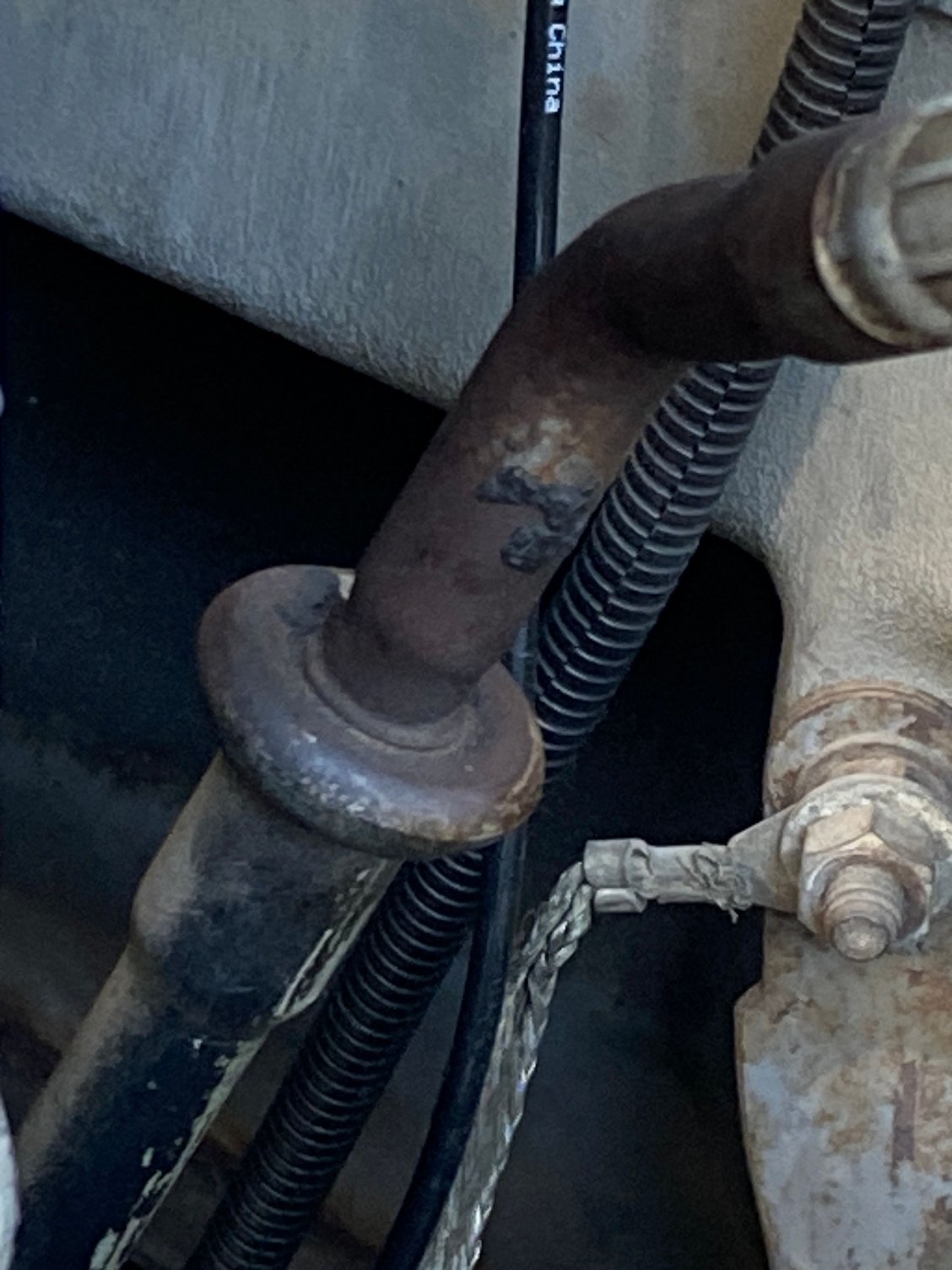

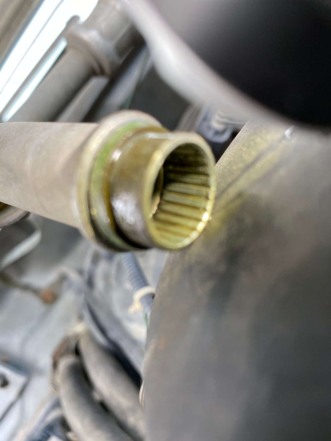

Here’s photos of this hose. Is there any clues as to what refrigerant is in this?

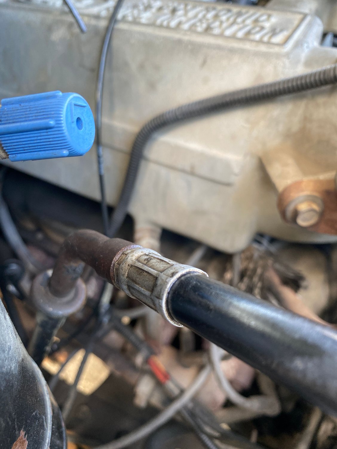

I didn’t take the hose off above the intake manifold because it’s got those high pressure clamps.
Is there any way to tell what refrigerant is in it now at all?

Refrigerant is a gas or liquid, depending upon its state. You have no pressure so that is empty... judging by the 134A tit on dryer, probably had that as a quickie 'retrofit'
BUT
I have an R12 car with those **** as I built a new line set and easier to use my quick disconnects.
Pull your FOT from the evap and see how nasty it looks. Dark grey or has 'wood chip' looking bits (Teflon) means compressor checking out.

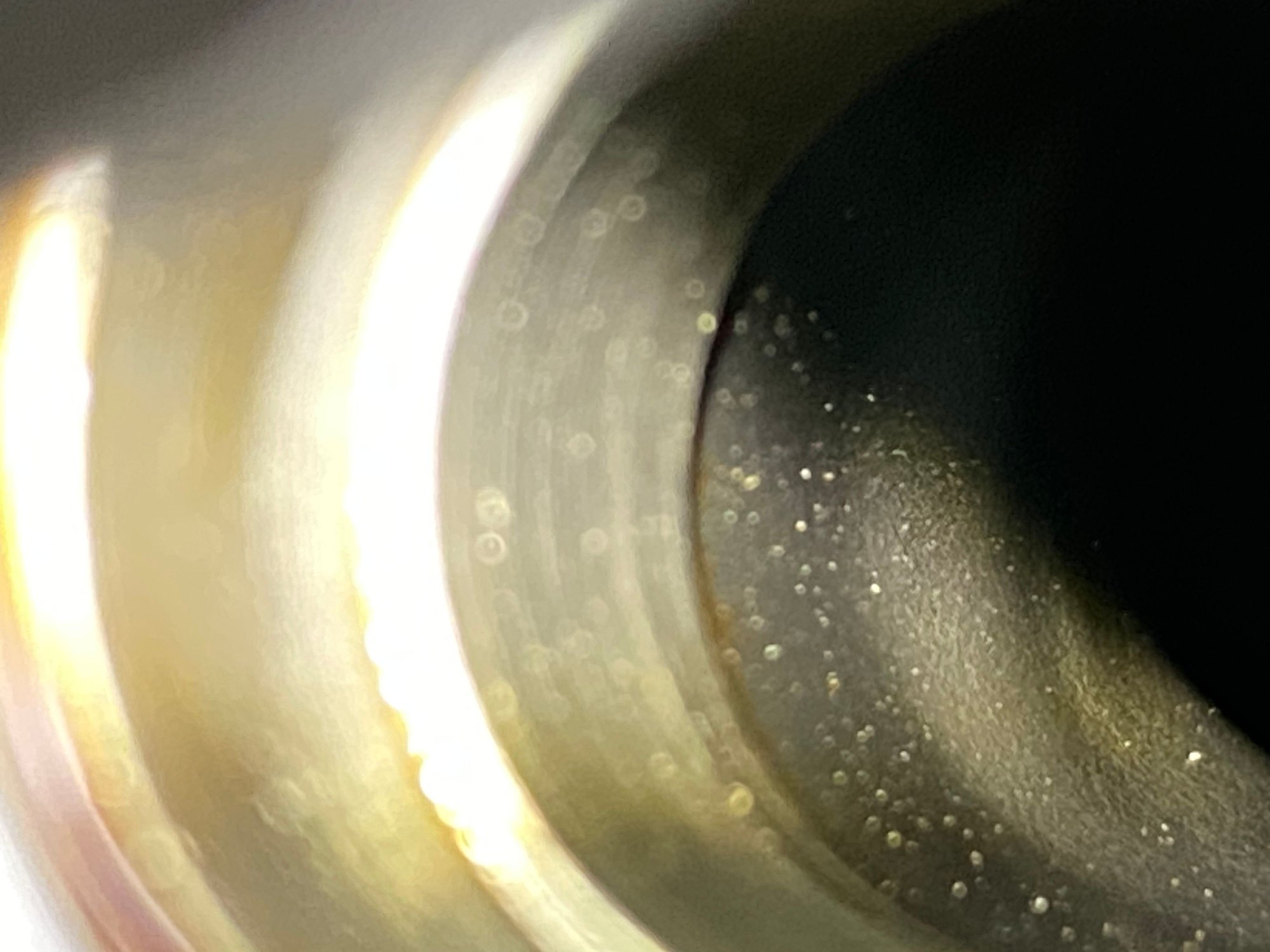

I was messing with hoses looking for what your talking about and this thing had residue on it and i smelled it making sure it wasn’t atf from dipstick the residue smells fruity

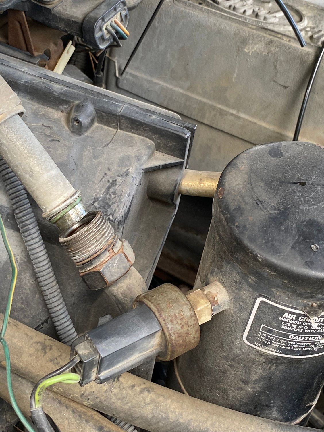

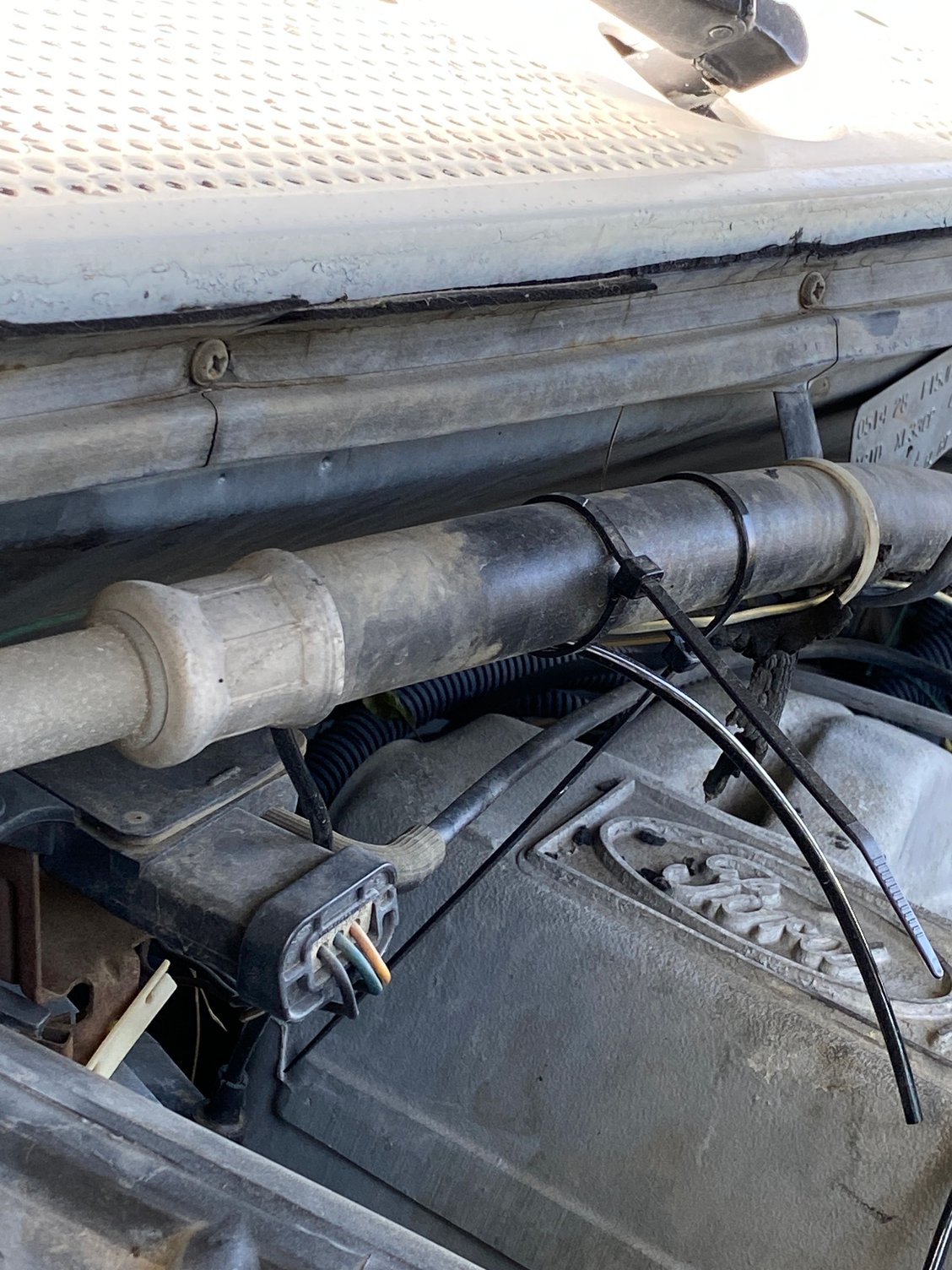

Is this the FOT? If not where is it? I see that solid line next to the dryer going into the black box with the evap is that it?

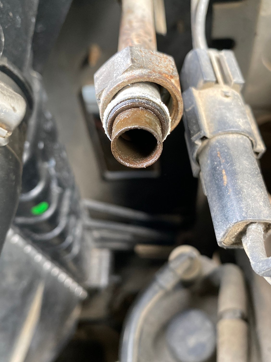

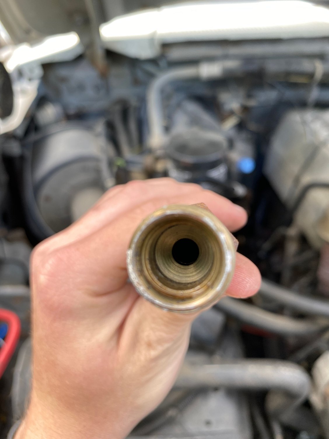

How do I take this off?
Old May 19, 2023 | 06:45 PM
toolman60's Avatar
toolman60
Joined: Apr 2018
Posts: 551
Likes: 151
From: King and Queen Virginia
It uses a disconnect tool to remove it like on the fuel line quick disconnect.

Is there a way to do it without the tool, or do I need to go buy the tool?
Old May 19, 2023 | 06:52 PM
toolman60's Avatar
toolman60
Joined: Apr 2018
Posts: 551
Likes: 151
Well you just rip your ac apart you going to be buying or renting a truck load of tools. I never tried to take 1 apart without a tool. You will need something to slide up into the backside of fitting to open the release spring.
Why you taken it apart now if you do not have the stuff to put it all back together. There no reason to take it apart now. Every day your ac system is open leaves more chances of contaminants getting into the system.
All you going to do is open it up to look at the orifice tube. For what a FOT cost new buy 1 new for it only around 10$.
Old May 19, 2023 | 08:20 PM
Hit Man X's Avatar
Hit Man X
Joined: Sep 2002
Posts: 9,550
Likes: 2,034
From: North Texas
System was empty. Full of moisture anyway.
Need a tool as he and I stated. I think you can rent them but Lilse (sp?) makes great ones.
