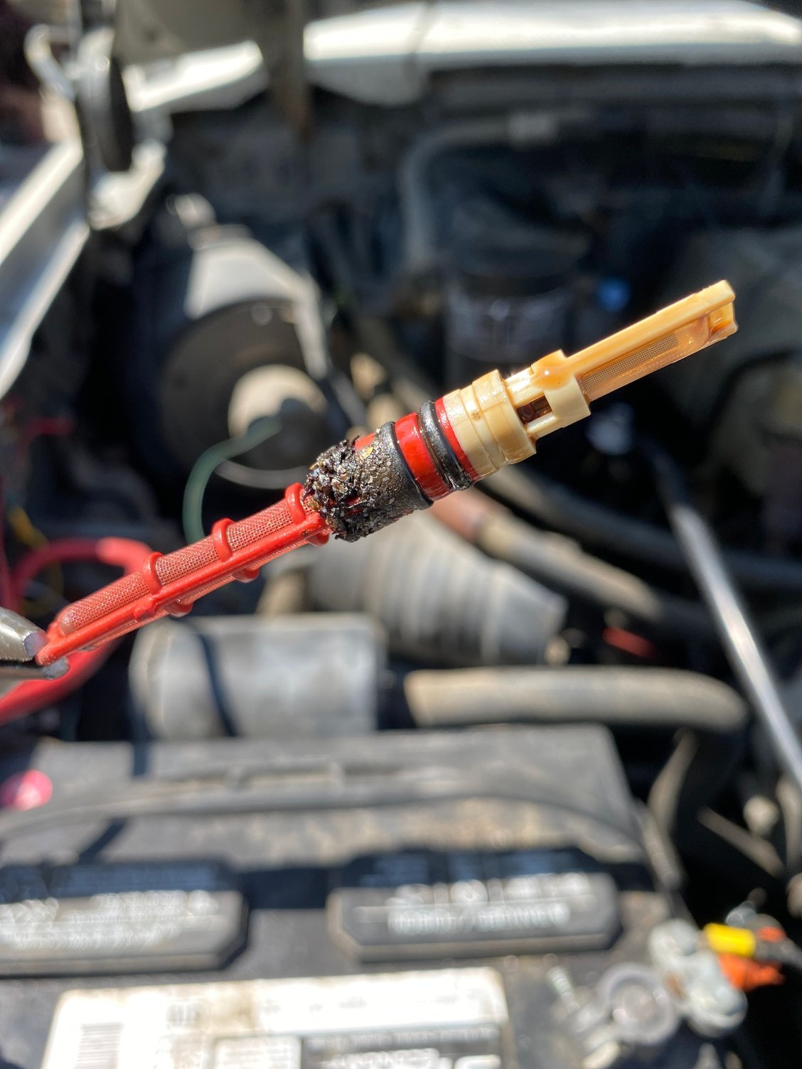

Old May 23, 2023 | 04:58 PM
  #41
Anonymous12's Avatar
Anonymous12
Joined: Jan 2023
Posts: 1,172
Likes: 114
Good or bad?

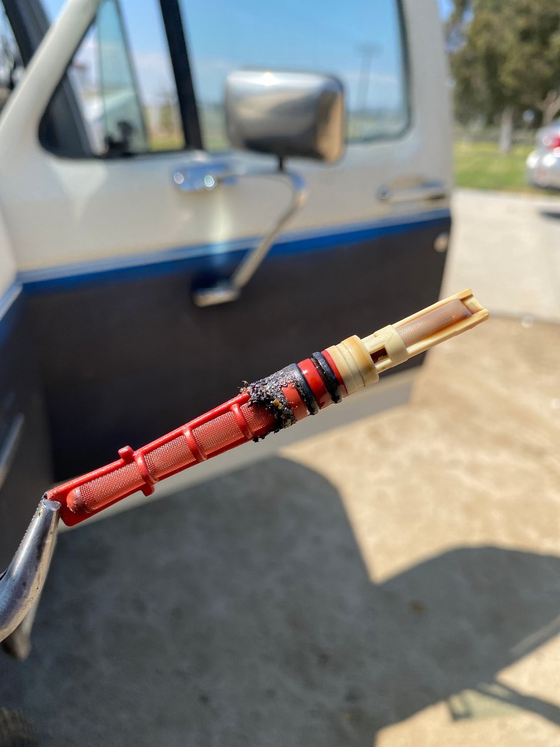

Old May 23, 2023 | 05:18 PM
  #42
Anonymous12
Joined: Jan 2023
Posts: 1,172
Likes: 114
Was it in backwards as well? The side im holding with pliers was facing up. Shouldn't the white part have been facing up? By the looks of it can I get away with temporarily running the system as is by just flushing and repairing the leak? Why is it all collected in one spot as well? Shouldn't it be spreader through the screen?

Old May 23, 2023 | 10:38 PM
  #44
manicmechanic007's Avatar
manicmechanic007
Joined: Jul 2020
Posts: 10,522
Likes: 2,654
From: Near Salt Lake City
Fords way is
You flush each heat exchanger separately and you do not flush the hoses, you replace all the rubber hoses if it needs flushed.
You should be replacing that compressor with the metal and piston ring material it has been sending thru
Ford PAG oil is what you use for your system and R134a
The orifice was in there correctly
