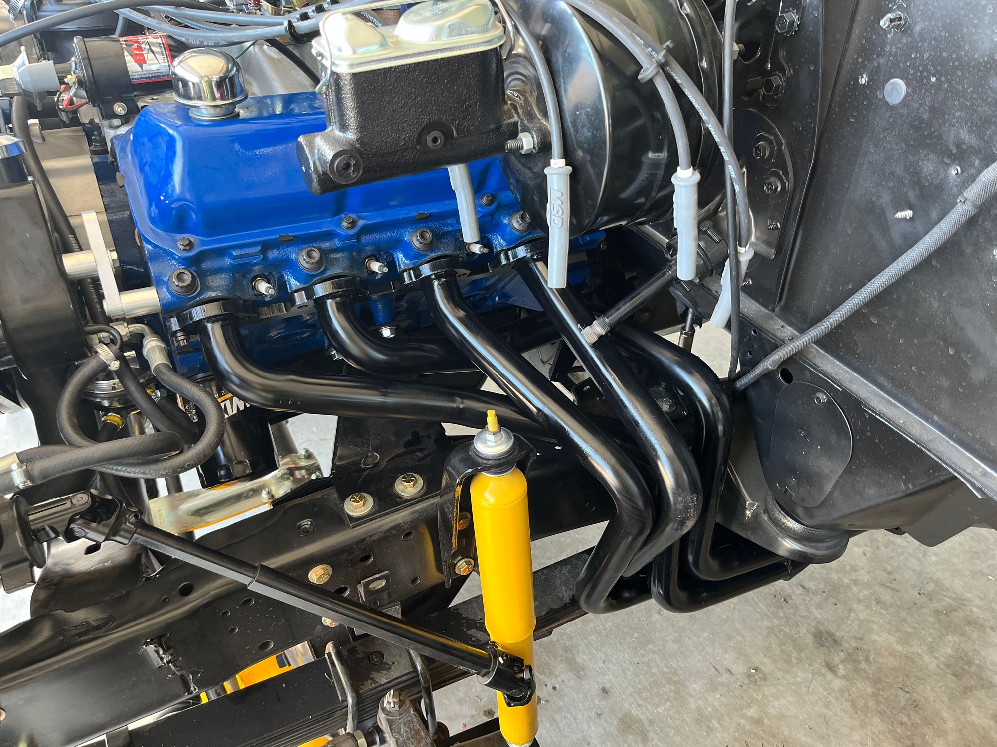

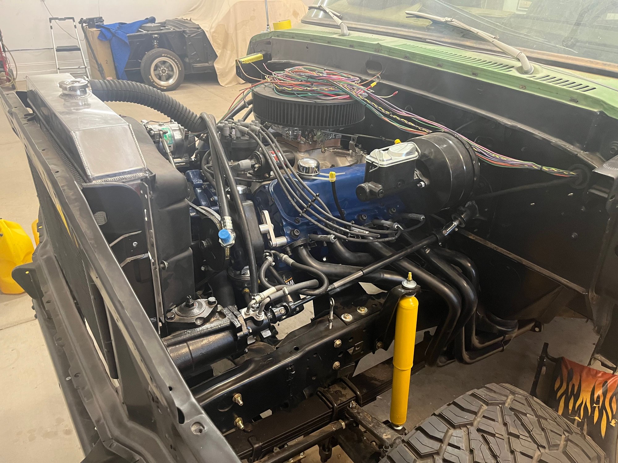

So I have a Frankenstein of a highboy
stock 4wd 73 Column
Benchworks power steering
460 swap with l&l fender exits
as you can see the shaft is hitting number 8 tube and I cannot put the u joints on
If the joint was a few inches higher there would be no clearance issues.
I think the most expensive option is a tilt Col that would put it up higher
I could cut it and then section it back in
Cut it have the shaft re Keyed
Or this u joint #BRG-014964 that I could weld to the shaft that would adapt to 3/4DD
any other options or options on what is safest is more than welcome

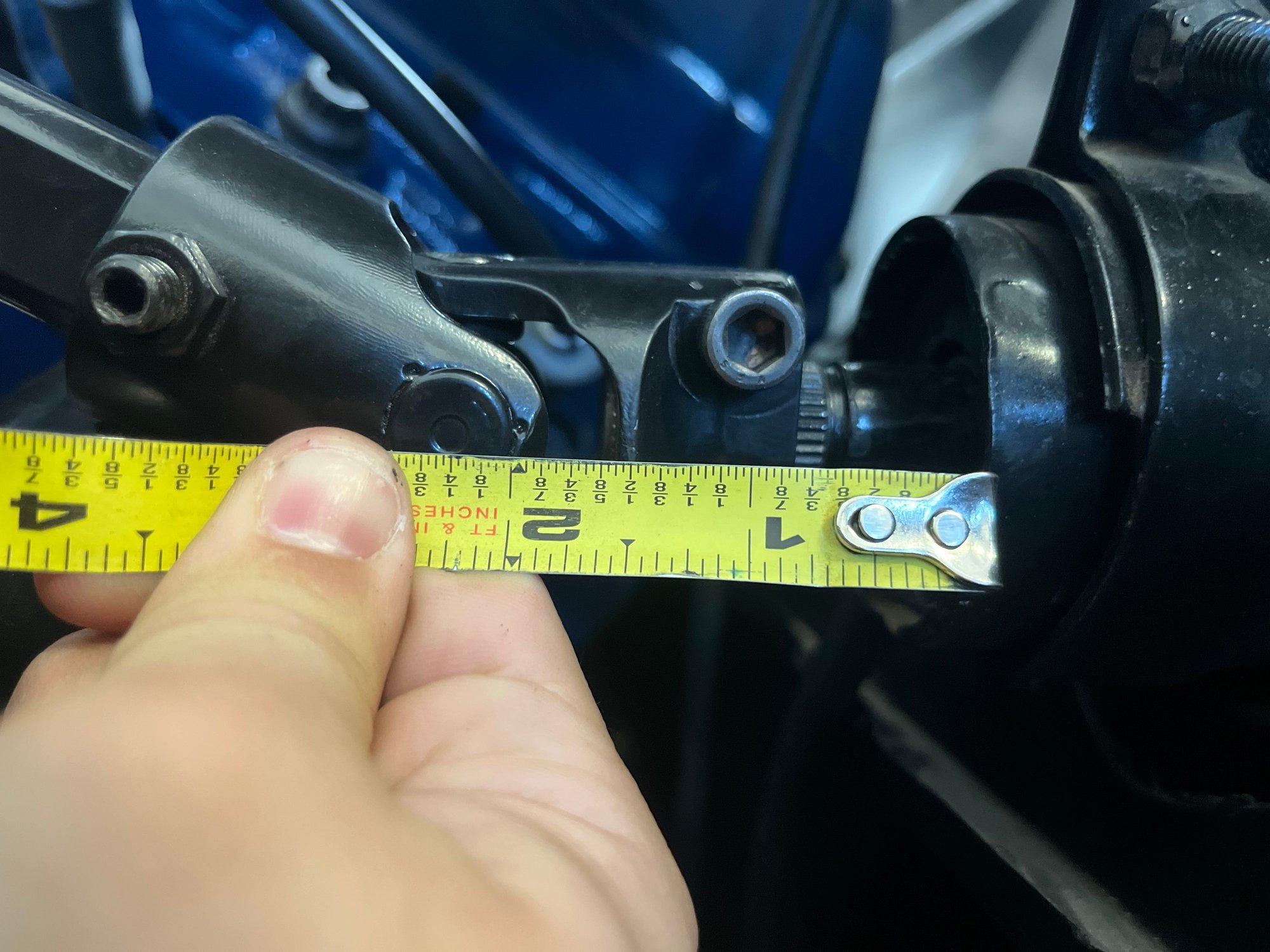

The clamp that holds the shaft from being pulled out wouldn’t be able to fit if I cut the shaft down so my options are
77.5-79 4wd col $500 and needs a rebuilt
or a ididit Col for $800

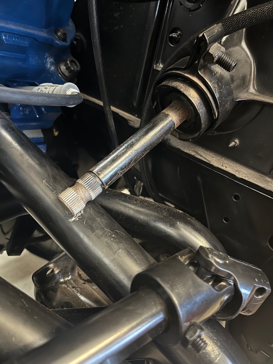

Looks like you done it in that second picture there in post 7.
Old May 16, 2023 | 08:38 PM
5speed65's Avatar
5speed65
Joined: Aug 2022
Posts: 39
Likes: 20
yep that’s what I got to get it to the steering wheel is sticking out of the column 4 inches or so

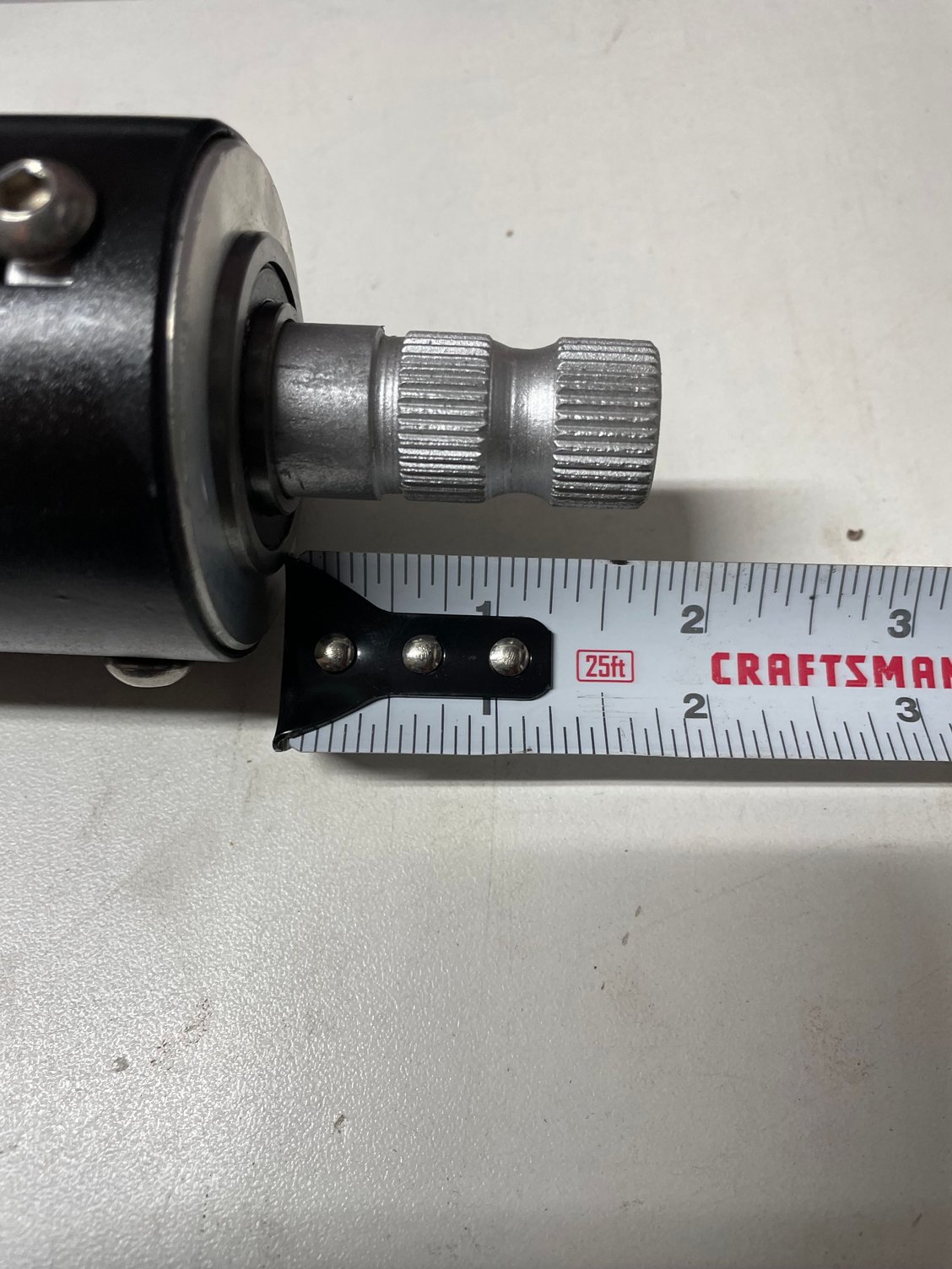

Seller https://www.ebay.com/str/2monkeyboys
is going to make me a column that should work

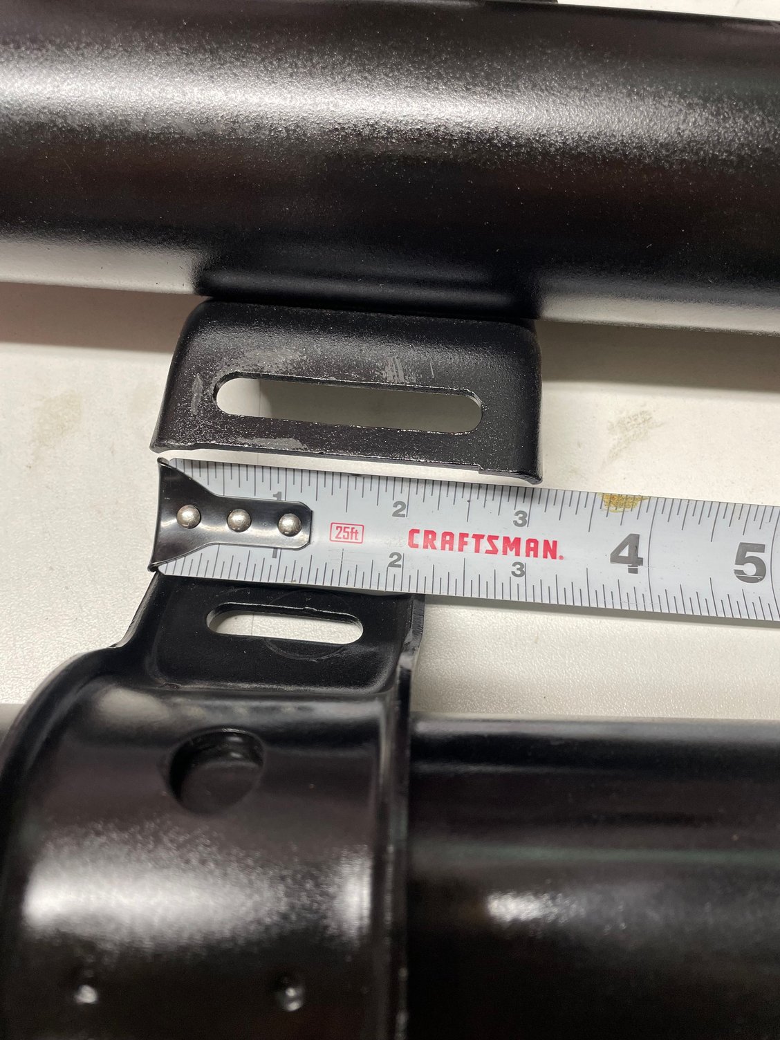

it will have a 74 column so I can still use my steering wheel and the base length with be like a 78-79 and the bearings are held in with snap rings so I don’t have to worry about the clamp.
to give me more adjustment if needed he’s going to put on the 78-79 power steering bracket on the column
Old Jun 6, 2023 | 09:01 AM
5speed65's Avatar
5speed65
Joined: Aug 2022
Posts: 39
Likes: 20
Solved if anyone else has issues. I will recommend that eBay seller for anyone who wants their column rebuildt. Came with turn signal switch, arm, new bearings and painted for a very low cost. I definitely needed the larger 78-79 power steering adjuster bracket and the column is just on the edge of the clamp but it is solid and clears perfectly
