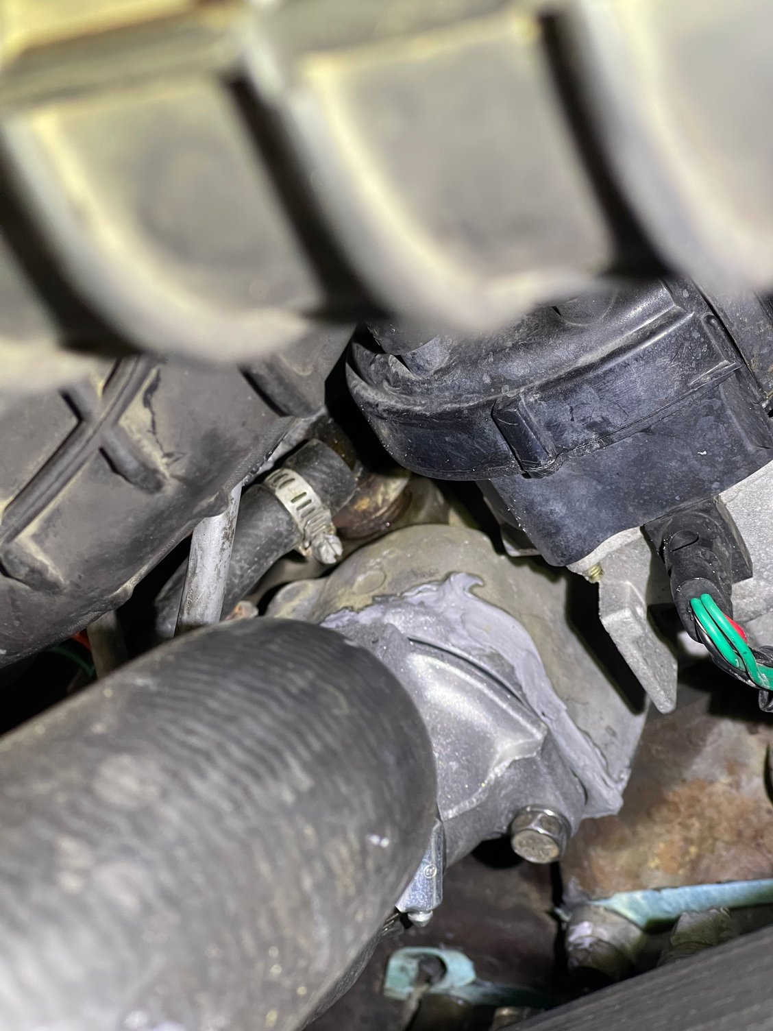

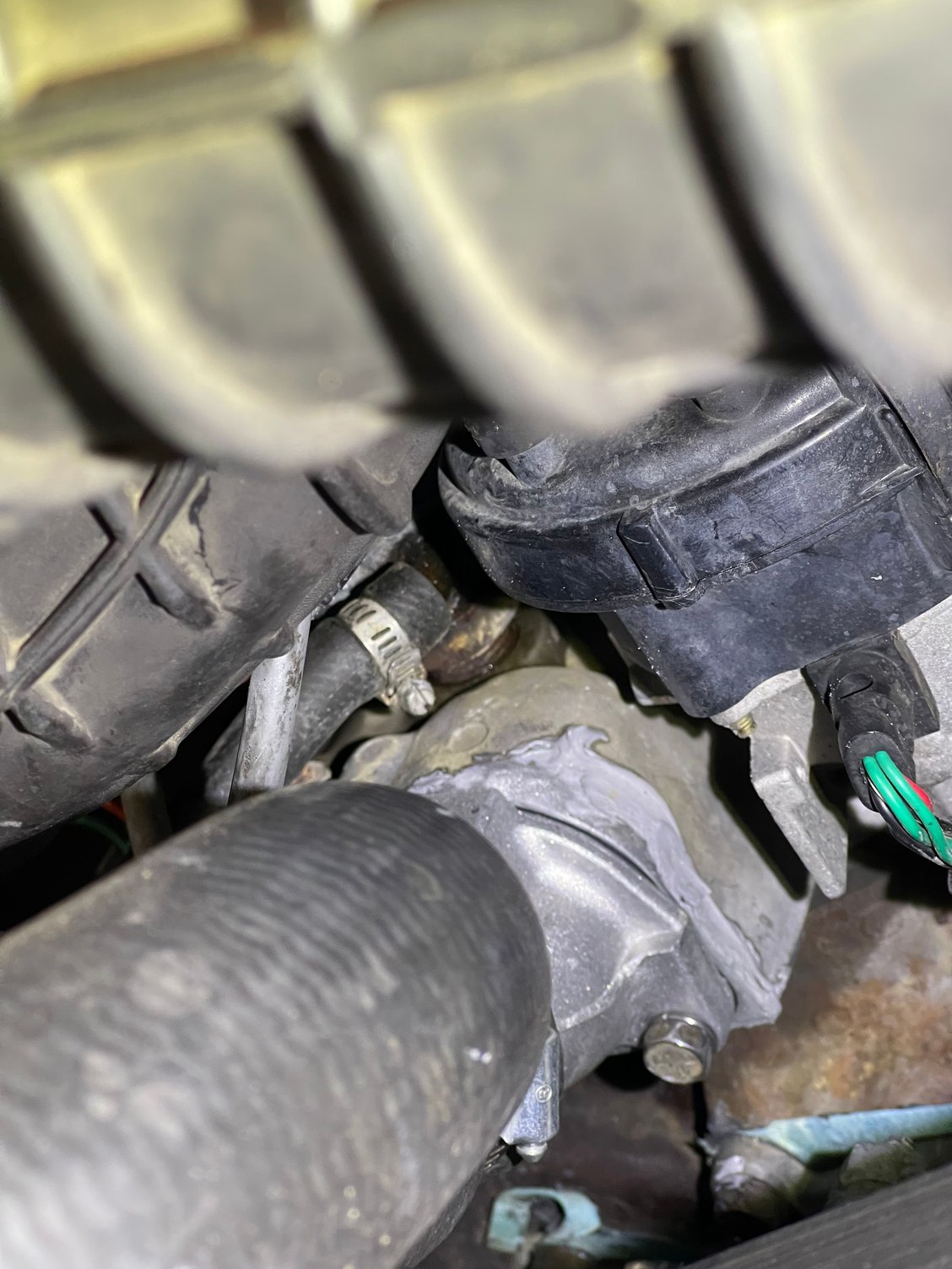

Afternoon all.
vic: 1993 F250 w/351w, M/t
on the intake manifold, just behind the thermostat housing there is a fitting, with a coolant line and sensor. Any ideas what it might be?
its next to the distributor and under the air intake hoses, on the side that they attach to the upper intake (IAC?)

Coolant temp sensor for the ECU.

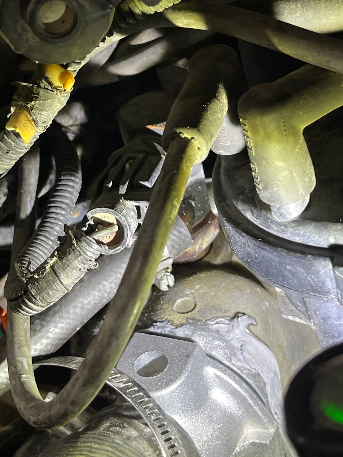

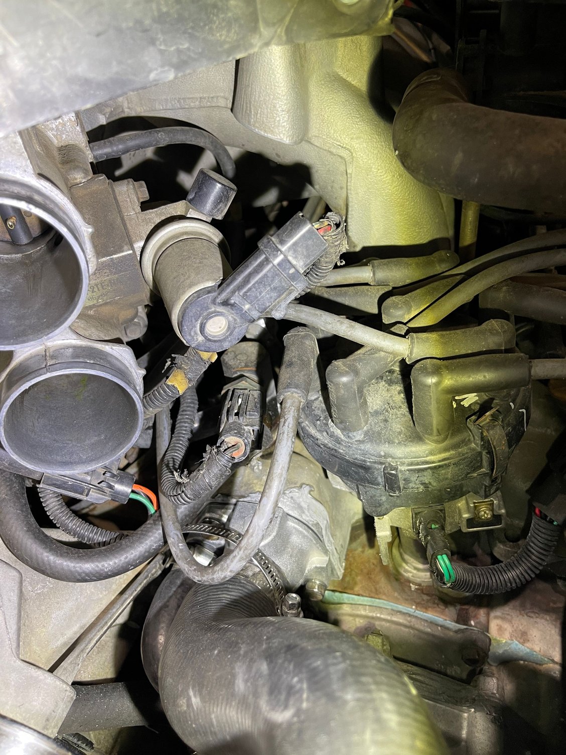

ah okay. Would you happen to know what the fitting its attached to it is?
that thread thats tapped into the intake manifold is starting to seep from corrosion.
since it has an outlet house for coolant, is it a bypass or just to filter fluid through to keep the temp accurate?

Either Motorcraft KT81 or KT84. The difference between the two is the shape of the tube for the heater hose.
ohhhh, makes sense. Well, its ordered, as is a new temp sensor as my luck with sensors coming out pleasantly isn’t the greatest. I also may review if I can run my temp sensor there. Too many fights with the thermostat housing to try and place it there again

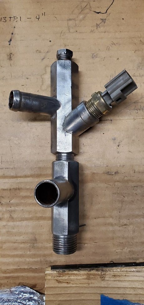

Sorry Scndsin, what I meant was for my autometer gauge. It took about 5 different attempts to seal the thermostat housing, the final answer was a new OEM housing from fleabay, gasket and t-stat. Not sure what the fuss was about but, I didn’t drill and tap that housing for a sensor because I wanted to test it first and leave well enough alone lol.
what ill look into doing is making a T or V fitting for the temp sensor so both are at the same location

Originally Posted by Scndsin
I had pics of a similar part off a 3.8 mustang motor that I've used successfully, but they're on a crashed PC
Here is one you posted in recent past:
Old Apr 13, 2023 | 09:56 AM
Scndsin's Avatar
Scndsin
Joined: May 2006
Posts: 12,324
Likes: 1,301
From: Central Mississippi
Thanks Randy.
HW that's actually 2 separate parts, I use the top. Useful for bleeding air out of the system.
If I recall the is another "flat", drill & tapable on the lower manifold, but that'd require removal.
Thanks Randy.
This is my Autometer mech water sender:
ah gotcha. Yeah that photo is where I originally had mine. I had too many issues with the housing and the sensor was just an extra pain to move. Started to wonder if I warped the intake manifold
