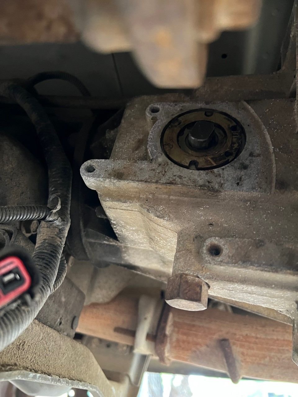

Update, the stub shaft was in the middle position and front driveshaft would not turn. I rotated the stub shaft CCW and she was locked up,I figure this is 4wd low. Rotated stub shaft fully CW (2 notches) and now the front driveshaft rotates freely.

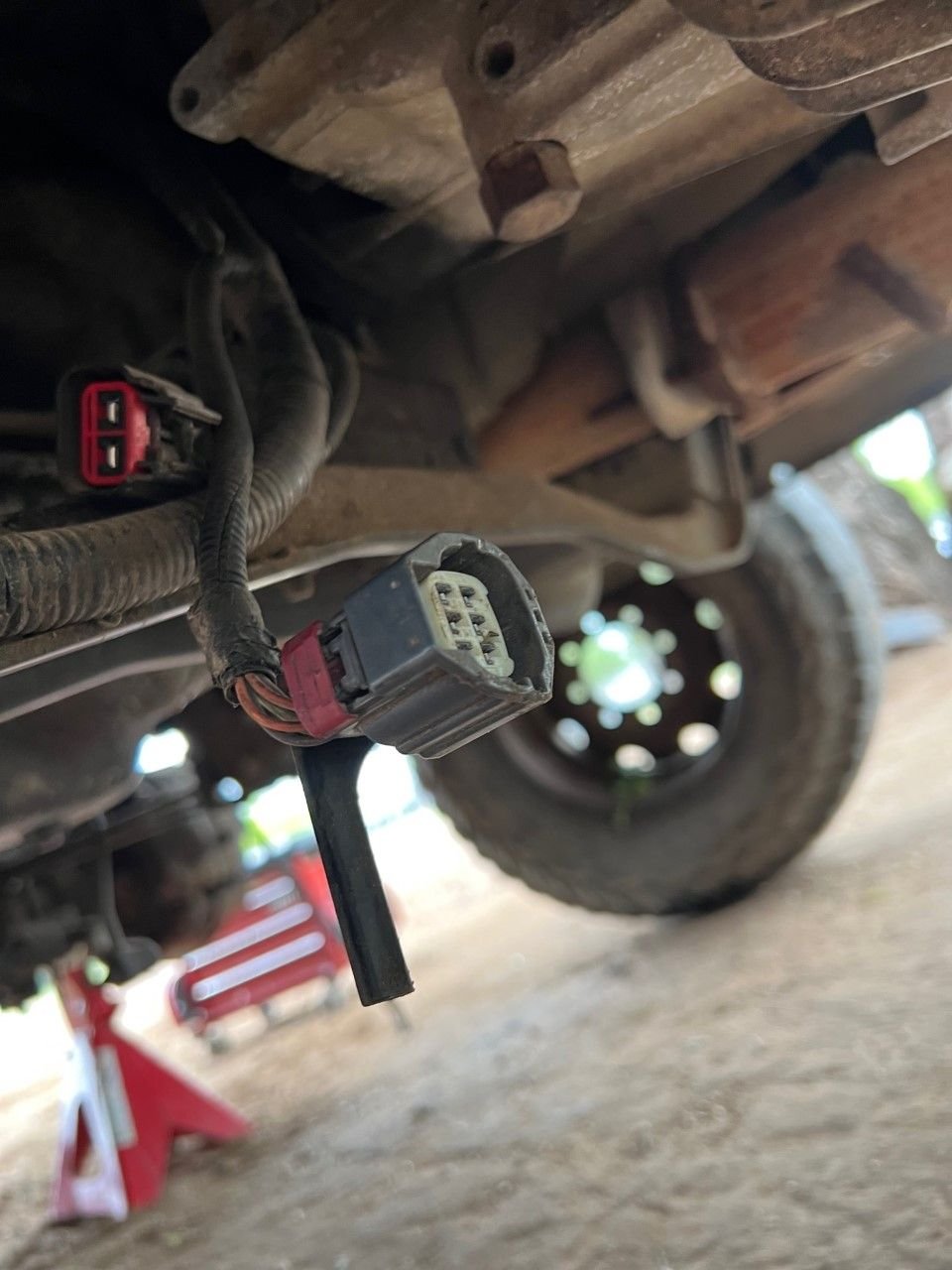

Heres a shot I took of mine, may help give a clearer picture. Keep the 9/16 wrench with you for shifting if needed until you get your shift motor assy. Just a thought on your noise. Inside the front hub is a needle bearing that supports the outer axle shaft, and also shares the weight of the inner shaft with the carrier bearing. When these wear out, you will get a rumble stirp kind of noise from the front end that comes and goes at highway speed. If this is worn more drastically, it could be contributing to your front end noise issues.
