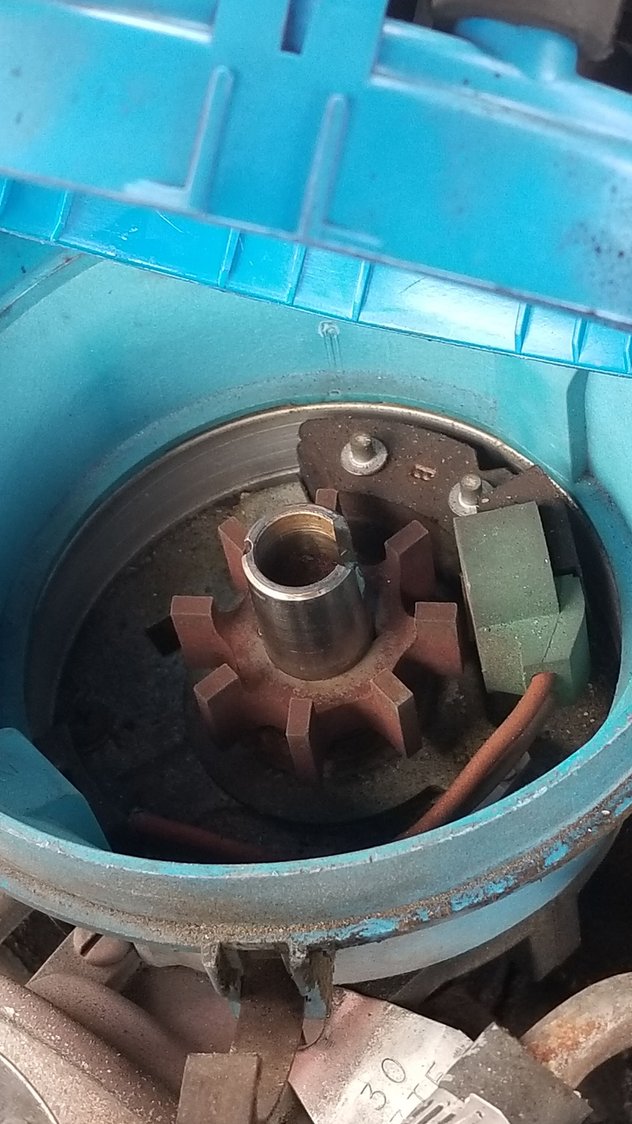

Considering an ignition upgrade. Currently running Motorcraft electronic ignition on a D7TE-12127-ADA distributor. 1977 came stock with points/condenser so someone installed the electronics version later. It ain't broke but I've heard that a Petronix Igniter III would improve performance/reliability. Pics of current distributor below for reference. Appreciate any advice here. Some questions:
1) Seems like the Petronix Igniter III is a go-to kit for this. Do I need to think any more about brand or model or just go with it? Is there something materially better?
2) The part lookup on the Petronix website is flaking out on me. Does anyone know for sure which model number of the Ignitor III is the right one.
3) Consensus is that Petronix gear wants a high end coil. I put an ACCEL 8140 Ignition Coil in it a few months ago (42000v, 1.4 ohm, primary). Is this a good fit for the Igniter III?

You wouldn't be getting any upgrade, just something different.
Any performance improvement, if there was one, would have to be seen on a dyno you're not going to notice it.

No, your truck never had points as far as I know. Was back 1976 they started with the electronic pointless ignition. It's at least as good as Petronics.

I am wIth the others keep what you got and I would also say that was factory.

Your vehicle should have come with Ford's Duraspark II ignition which appears to be what's in your photos. In my 460, I changed to Ford's Duraspark I ignition which was the high energy ignition Ford used in some engines sold in California to achieve emission requirements. I doubt if the change you are considering will provide the results you desire.

You don't need anymore than stock Dura spark. New parts are suspect. Try salvage yards for replacement parts. Nothing with new label. Ford used the parts for 25 years, early defective parts were weeded out under warranty. AMC used them also. The pickup coil moves every time the throttle moves. That wiring and other wiring about the only wear parts.
