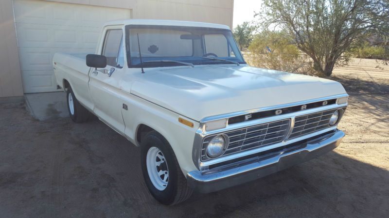

Old Mar 3, 2016 | 03:37 AM
usuallybowtie's Avatar
usuallybowtie
Joined: Aug 2013
Posts: 255
From: Terre Haute
Nice looking pickup

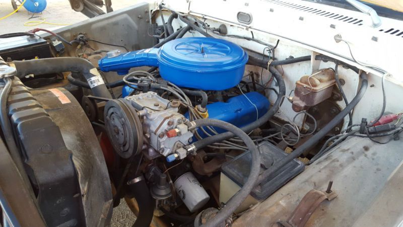

I have the exact same truck just without AC. Looks like someone put a new unit. Anyway to answer your question. I would go with an HEI distributor. I did, it gets rid of the coil and has more spark. Best thing you have to replace the dizzy and run ONE wire to the battery. You can check my gallery to see my engine. I got my Accel on off ebay for 80 bucks. Its billet aluminum and in ford blue.

I have a friend that has installed Pertronix in two different vehicles with no problems. I installed an Accel conversation in mine because that's what autozone had on the shelf for $76 with no trouble. It has an eye that look through a window like a unilite by mallory.

One thing to keep in mind is clearance. Those dizzies with the built in coils are quite large and you need to check the clearance to your A/C compressor. The dizzy out of a later model 302 will drop right in and Duraspark is not hard to wire in. 12 volts to the red wire and the white wire got to the "I" terminal on the starter relay. Duraspark modules are easy to come by too. Use the module with the blue grommet. If you start getting cross fire in the cap you can change to the late model large cap and rotor, still smaller than the GM HEI coil in cap design. As for the gear if you run a bronze gear you will have no worries, its softer than the cam so it wont hurt it.
