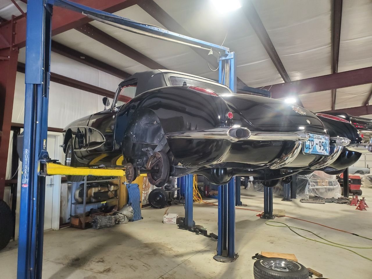

When I asked to have my TrueTrac installed, the shop has about 6 or 8 Two Post lifts.
I had to wait 10 days for the only Four Post lift to open up, because the Excursion is too heavy for a 2 post lift.
small stuff like this occupied the 2 post lifts.
