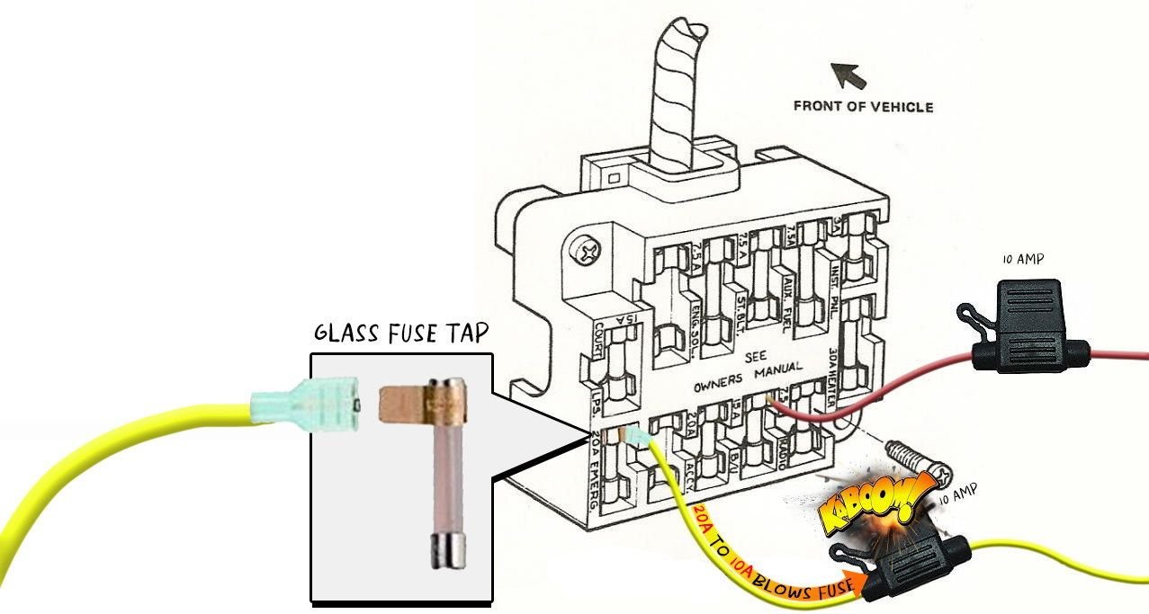

I can only imagine the thousand and thousands of 73-79 Ford trucks that got along fine with the open fuse box. But I like your idea for sure. What do you have going on with that fuse tap? You know that make a actual glass fuse tap.

That's just the wire going to my voltage gauge. That fuse location only has the clips on the supply side for some reason, so I just turned one of those fuse taps you show on its side with a loop of wire to help it lay flat in the slot.
Ok got it, thanks for the explanation. I was not sure what you had going on. At least is was not a live .22 bullet (kidding), or a spent .22 casing in the short fuse block.
