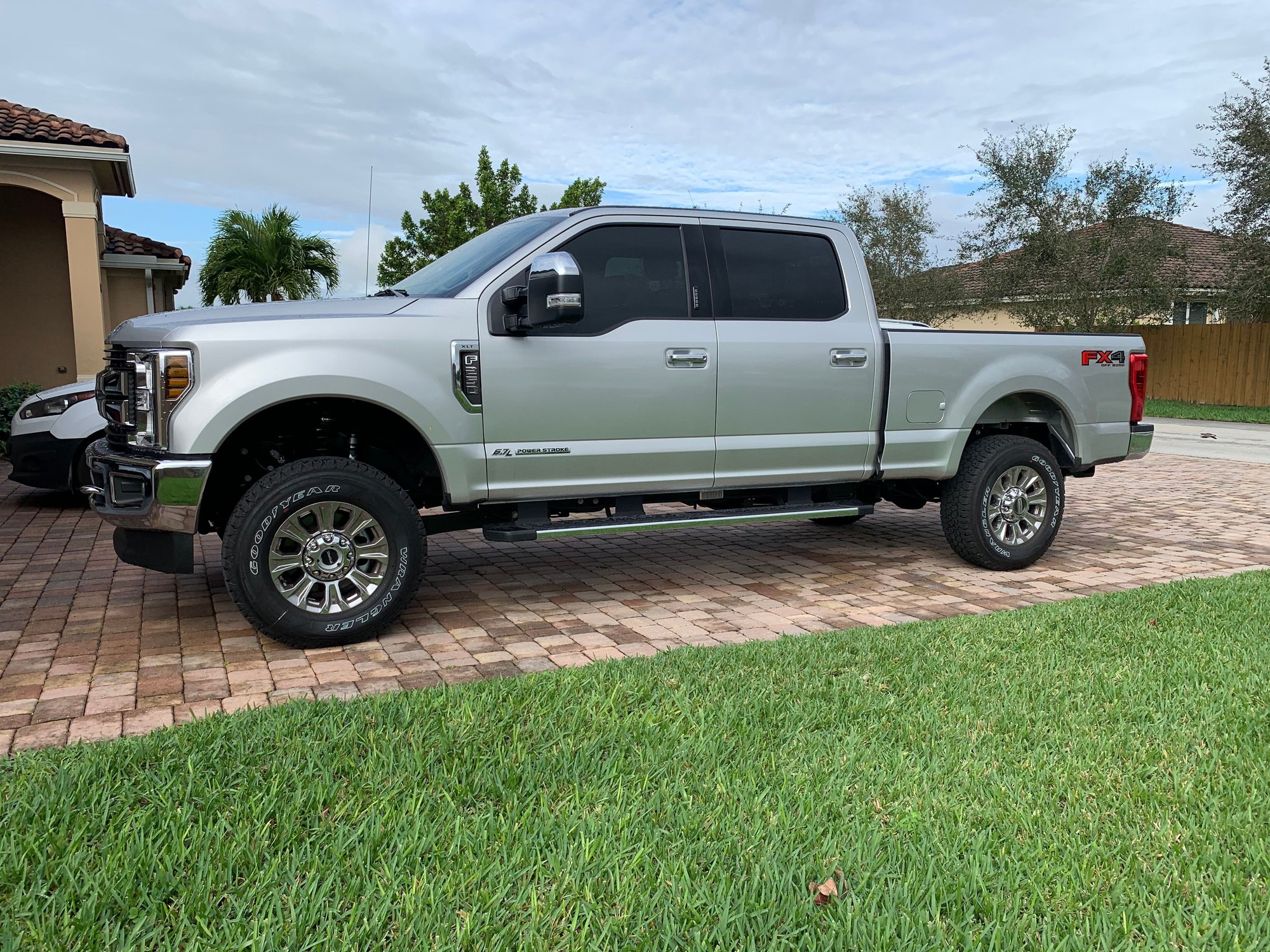

Got it done this weekend. Jack stands up front on the frame rails behind the bumper worked great. Readylift 2.5, with fox 2.0 and Carli brake lines. Just need to get the caster bushings, alignment and new wheels. Thanks for the help
