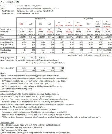

Old Mar 21, 2023 | 06:51 PM

Originally Posted by Kwikkordead
Those are supposed to utilize the intake duct built into the fender well. No need for zoodad. I tried one of those years ago and pulled the filter minder to the first notch with a brand new filter element installed going over Snoqualmie pass while pulling the 5th wheel. It came back out a short time later and the trusty old 6637 filter went back in. Ended up selling it to a friend with a 7.3.
No sir. The AIS pulls air from the front through a snorkel similar but larger than stock.
Originally Posted by Dan V
The filter is the restriction, not the box.
Not completely true. I performed testing. The box itself is a restriction which was helped by cutting a fender sleeve hole.
AIS Testing Thread
The filter minder can pull in on hard pulls in a hot tune but on normal driving it rarely goes past the first notch. This includes medium towing. I decided to sacrifice a little flow in the name of a quiet intake.
I performed the Secret Zoodad and highly recommend it. It’s completely invisible, no chance of rain/bug intrusion, it’s a straight shot to the snorkel, and should work based off the pressure principle at the front of the truck. I would not do the regular Zoodad personally.

IIRC some folks have made holes in the bottom of the box which have resulted in less restriction. That plus @RacinJasonWV data imply to me that the box is a big contributor to restriction vs the filter. It makes sense since Powercore filters are designed around air being ingested "from the front" vs radially. In the 7.3 the air has to "turn right then upwards" to enter the powercore filter, then upon exit has to make another 90 degree bend.
