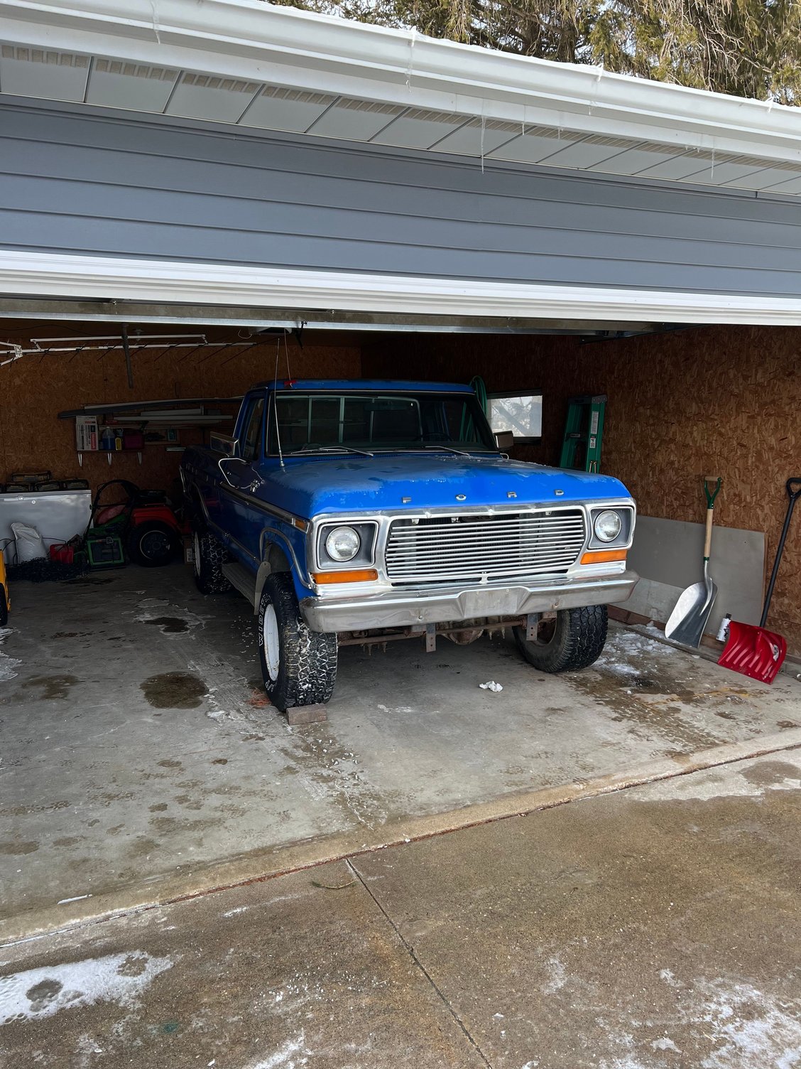

I recently purchased a truck to slowly fix up and hopefully eventually restore. It’s not original so I don’t feel bad adding a few personal touches. The body isn’t original and I’m scrapping a lot of it and starting with rust free components. I already have a cab purchased for it. I’m not going to paint it for a few years but I’ll do the frame since almost everything is coming off. I’m just wondering what components should be replaced now vs before it goes for paint. The perfectionist in me says to replace as much as I can but my budget won’t allow for everything at once. Any tips would be appreciated as far as what to prioritize and any other restoration tips. The frame is a 77 4wd frame with a 460 swapped in, it’s paired with a 4 speed manual. It’s gonna get a new clutch this spring when I put the new cab on. In the end it’s going to be dark midnight blue. For awhile it’s gonna have a lot of primer panels and a white cab. Thanks

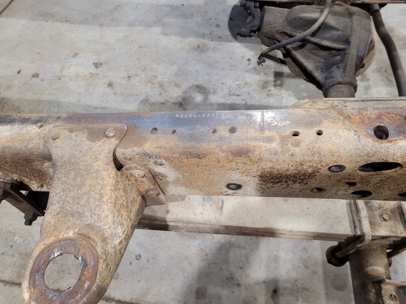

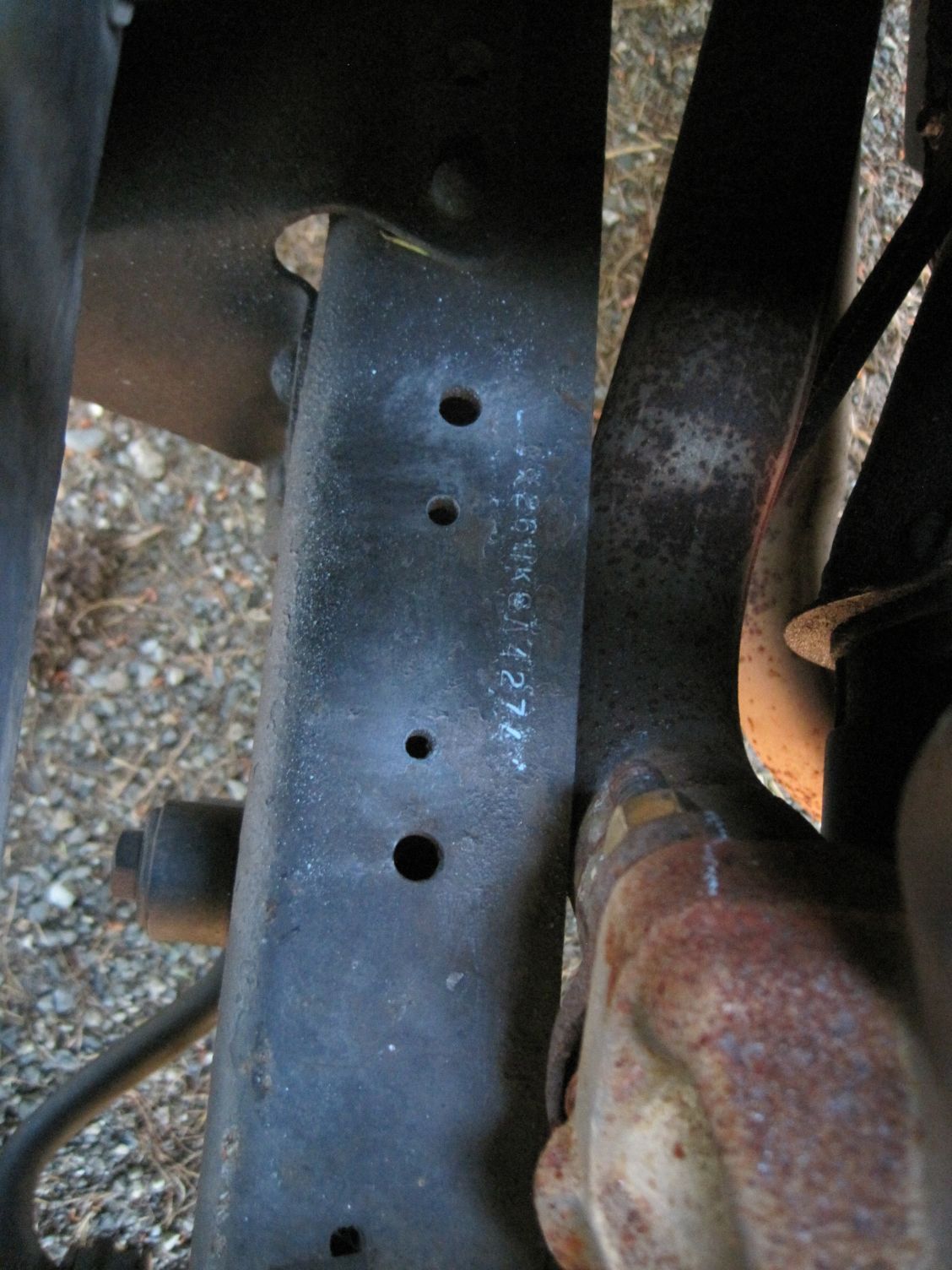

I should have mentioned it’s already on it’s second body due to Iowa weather and roads making for a rusty nightmare. The cab on it is from a 78 f150 2wd automatic truck and the bed is most likely from the same donor truck but both are shot so it’s gonna get a third body. Once I find the serial number on the frame I’ll use that one when it gets retitled. The state issued a vin that’s a non original ford vin since the cab and chassis don’t match. They want an investigator to look at it before I put the new cab on to make sure it’s not stolen. The dot was a pain when I went to title it but oh well.

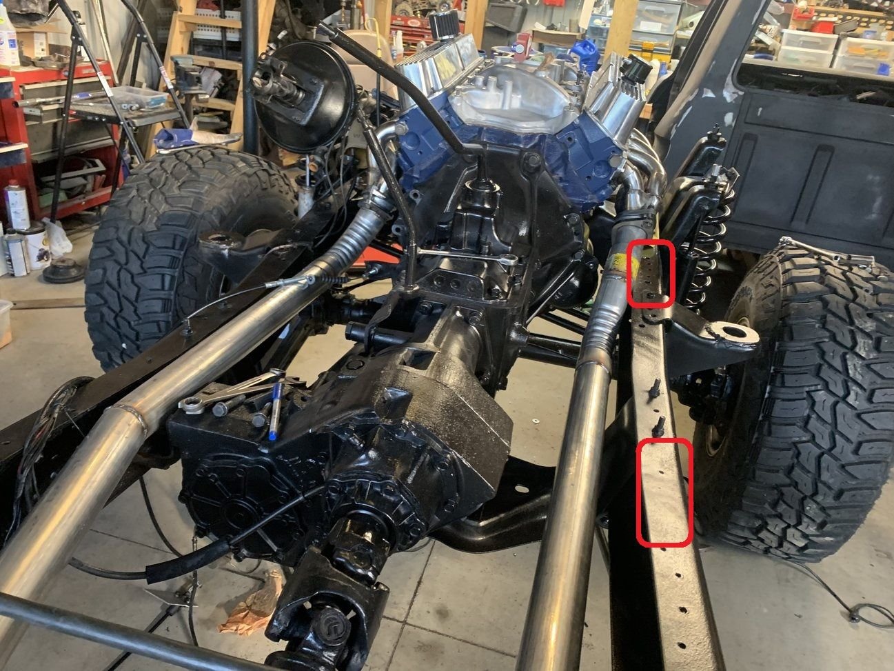

Just ask and you shall receive.
Passenger side, just in front of passenger side fwd cab mount. ON 4wd.

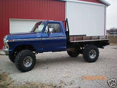

You can always flat bed it, cheap and easy. You like how I used only blue trucks? Lol
