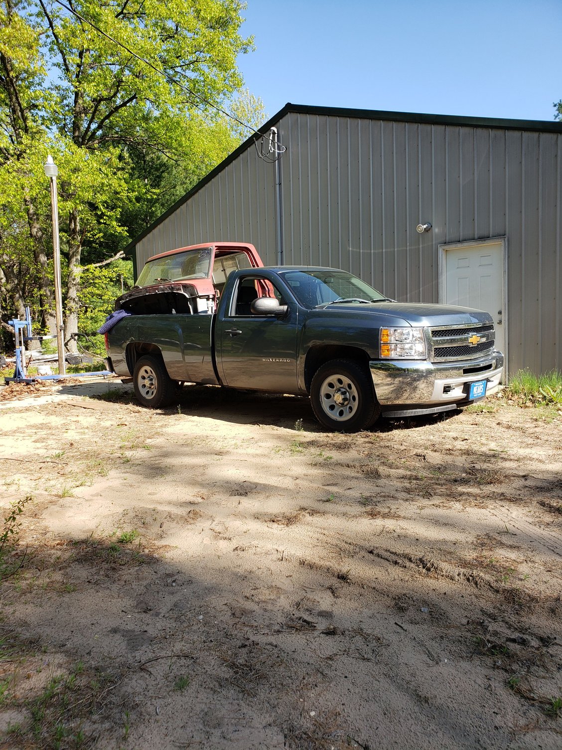

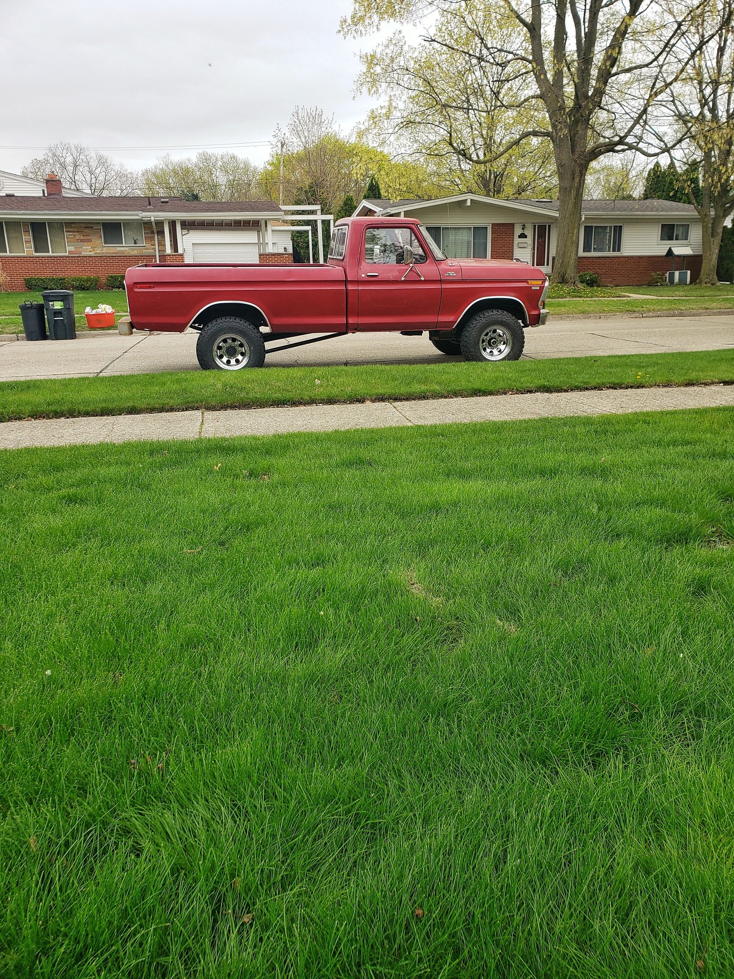

Here is a Pic of my truck as it sits today. This is her pretty side, the other side is primer grey as I was originally going to fix the bed.

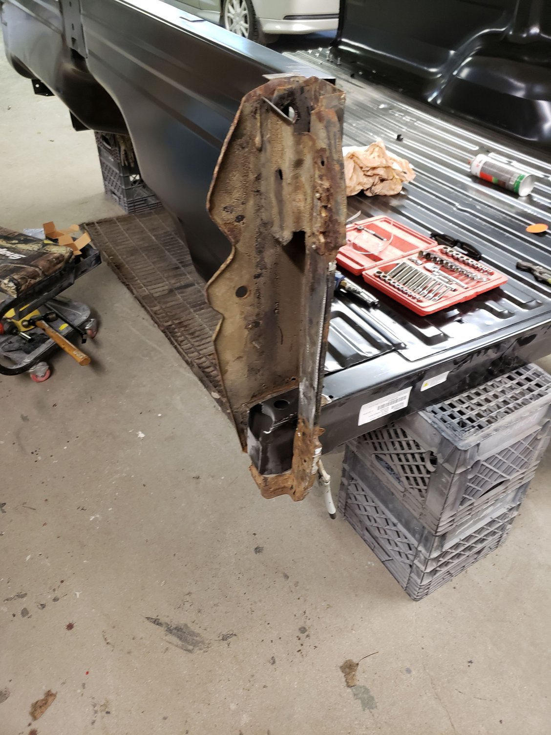

The tailgate pillar I couldn't find a reproduction unit. So, luckily the junkyard had a few dentsides to choose the best from! Picture is a mock up, we sandblasted them and welded some new metal in where it had rotted away.

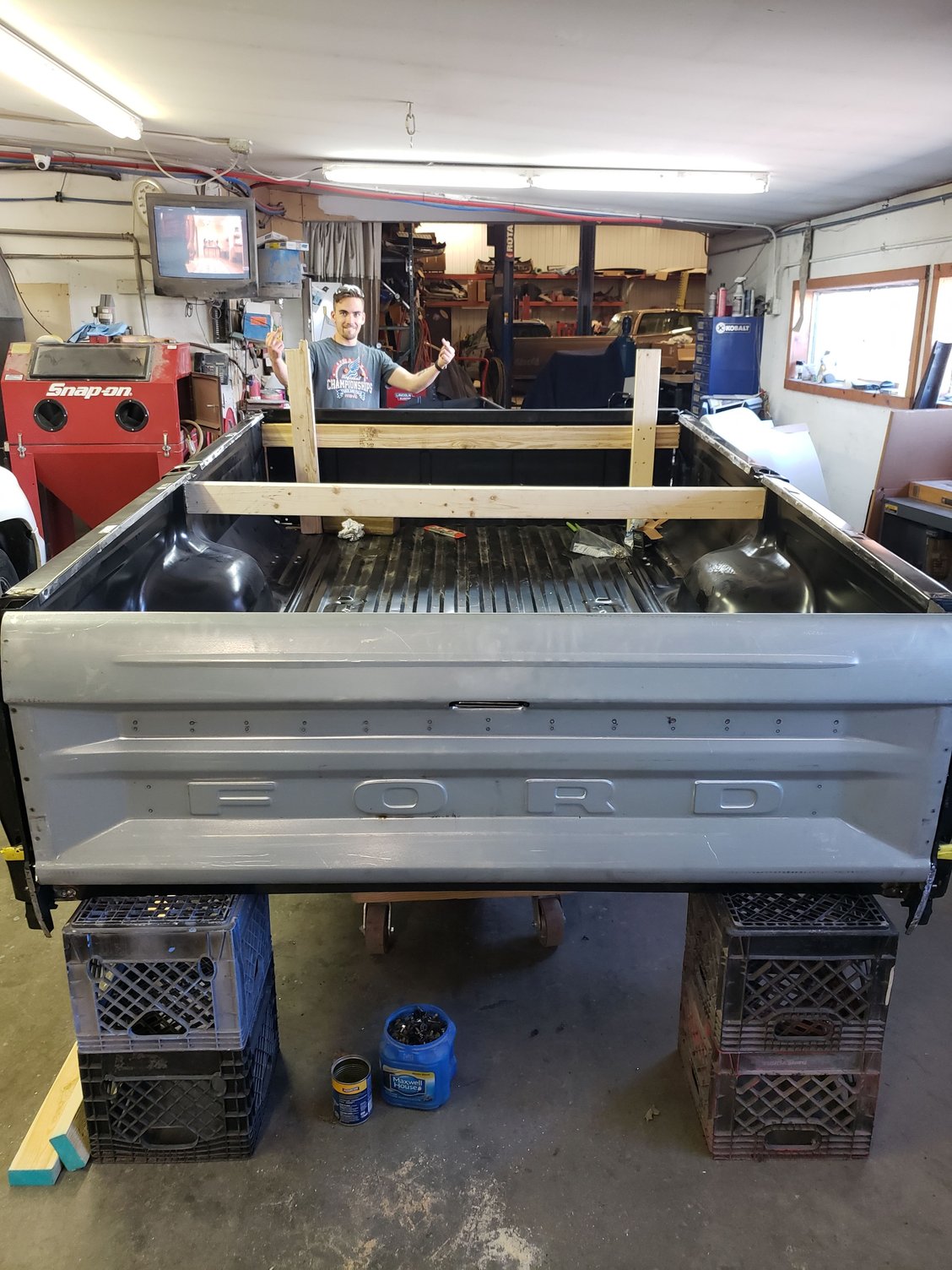

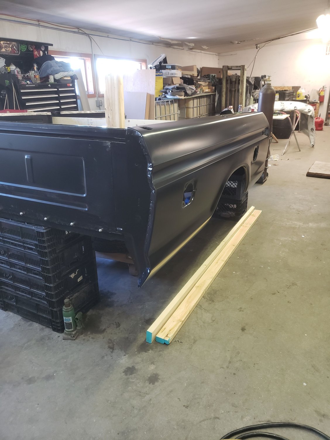

Using the tailgate to square up the end and a couple pieces of wood cut to length to square up the rest. My truck was on the other side of the state, but luckily the body shop had a dentside sitting outside to take a bunch of measurements off of. Ohhh, and my buddy saying this project sucks...he gets roped into all my big projects. He was a big part of the brains to this task! Very thankful he was here to help.
One outter boxside hung! not welded yet though

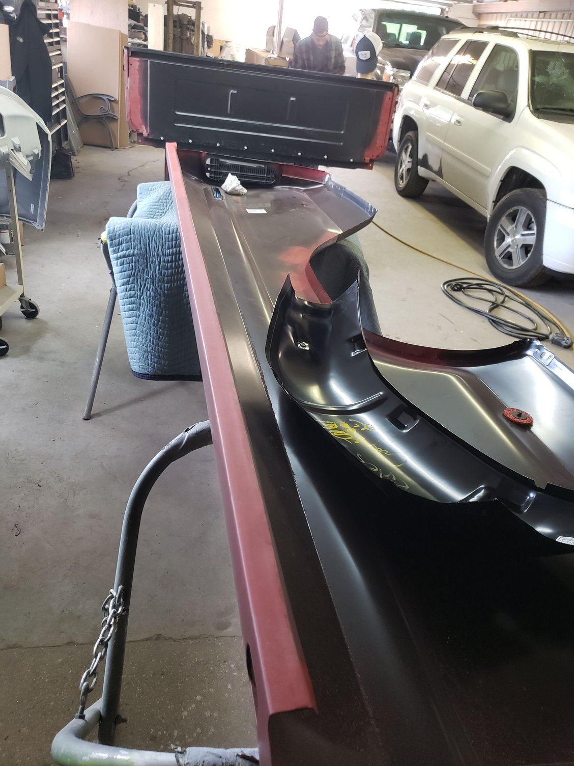

All the spots in red are where we had to grind through the E-coat as this is where we will be spot welding. The red "paint" is weld through primer.

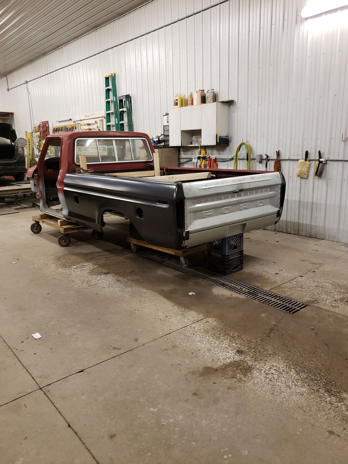

Here is the bed mocked up against the cab. I think it looks good! good enough for me any ways.

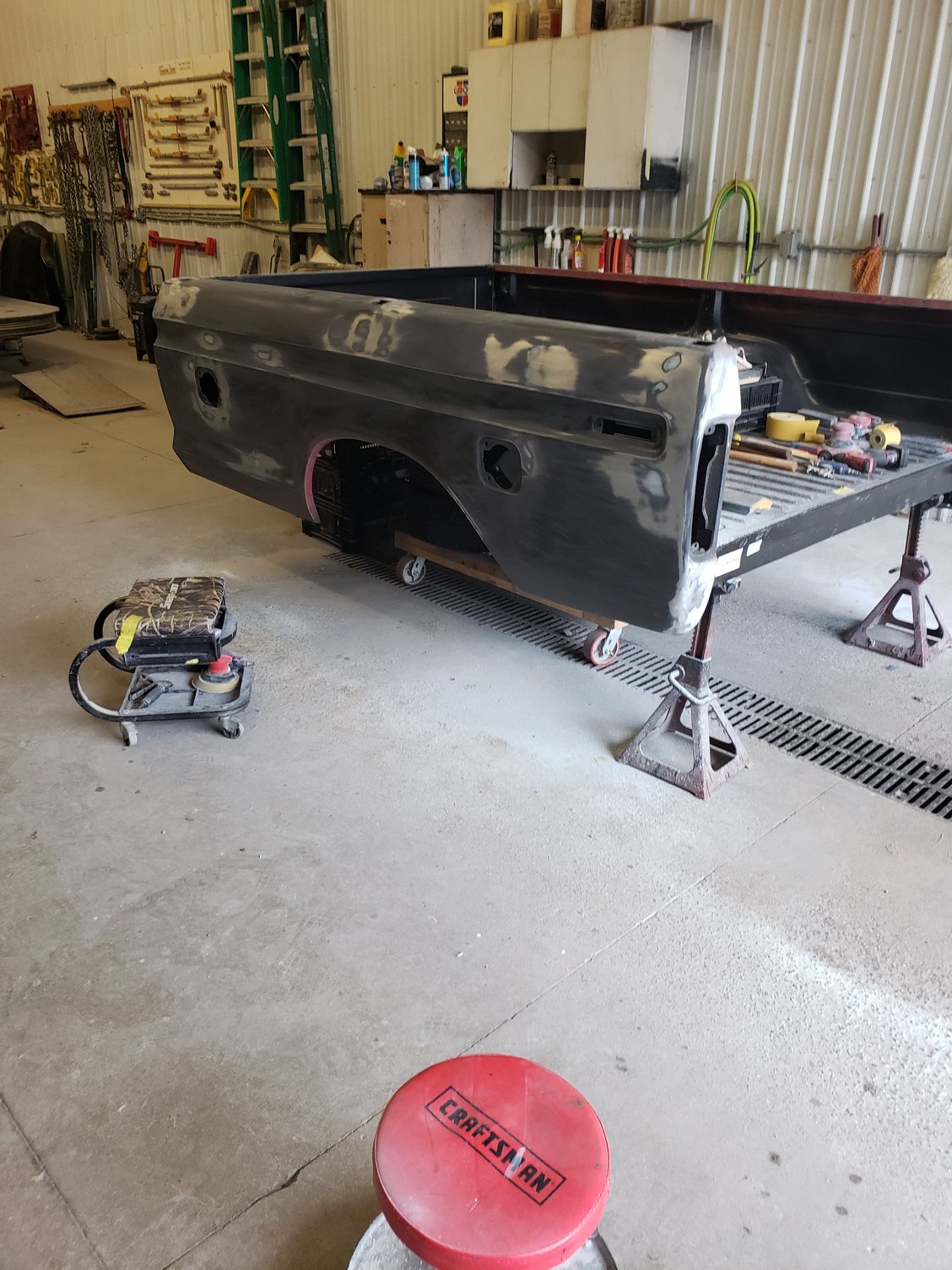

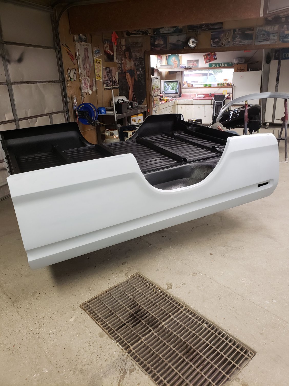

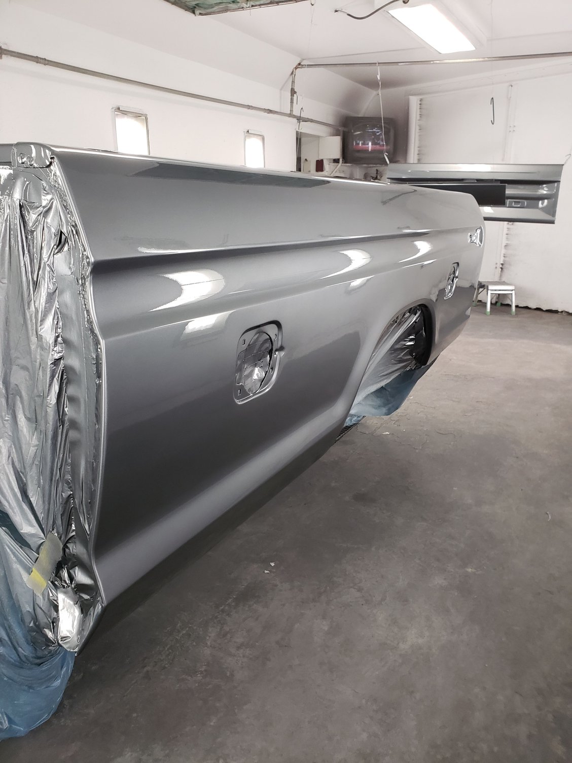

After it was all spot welded, we scuffed the entire box in 150 grit and then primed it. After that, we scuffed the complete underside and bedlined it. Looking pretty good!
A week had went by which let the primer cure and we then went to town blocking the primer down. 320 grit and then again with 600.
Here is my paint before it was all mixed up. Any guesses?

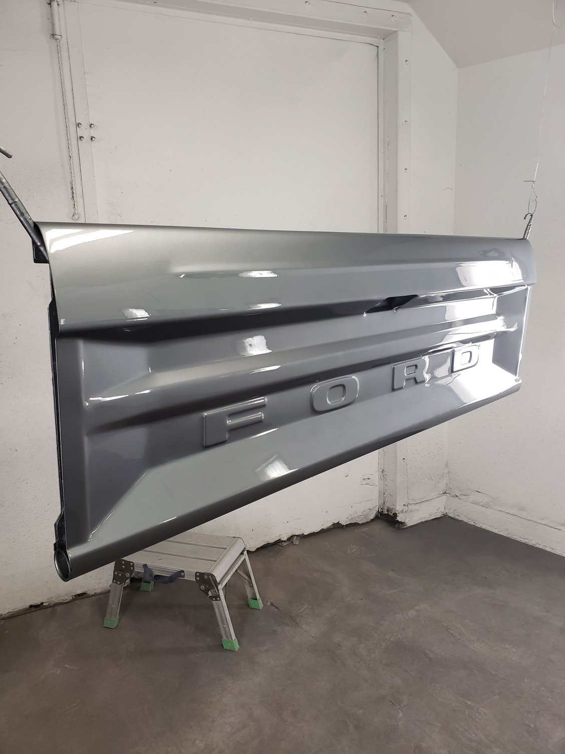

Did you guess grey? Kind of crazy how many colors going into a boring color as grey! Interesting enough it was much easier to pick a color than i thought. My buddy gave me 4 books about 2" thick with all sorts of different colors for exterior, interior, trim, wheels, you name it. However they were inch by inch squares. It may look good small but on a big scale who knows. I'm sure i would have been happy either way. Instead i looked at the vehicles at the shop. Ford truck, grey was too dark. Jeep Grand Cherokee, paint was nice but the flake was too large. Mercedes GLE, perfect, the shade i was looking for any fine flake. I ended up picking Selenite Grey which is the standard Mercedes grey i believe. I am beyond happy with the color!
Imperfections on the tailgate: The tailgate came spot welded together. I ground down the spot welds and filled them in with bondo to give it a better look. Guess my body work wasn't the best as you can still see all of them. Oh well, atleast its the factory look doesnt bother me too much.
Imperfections on the bed: I only saw one other than a bit of clear we have to touch up. Small dent on the bed rail. not too much of an issue as i plan on buying bed caps. Speaking of doesnt anyone know where i can find some? I have yet to find a supplier.

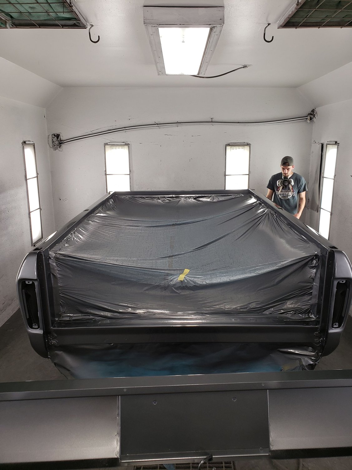

Since i have already gotten this question ill answer it. Why did we mask off the bed? We trapped in whatever dirt/oil was in there. Less time spent on wiping all the surfaces down and less of a chance for imperfections in the paint.

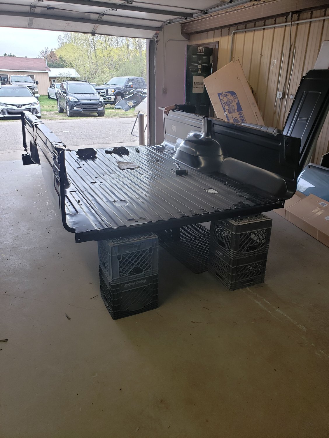

Now that my project is essentially complete, I thought id share my progress and what I thought of it.
I have a 1978 F250 long box regular cab that I originally bought in CT. I towed it to Michigan where i now live and began my restoration. I've since done the entire driveline and now im starting on the body. My bed could have been saved but like many CT/MI trucks, the bed has seen its fair share of winters which of course im getting at it is a bit rusty but saveable however i thought it would be a wiser move to build a brand new box out of reproduction parts. I ordered everything I thought i needed.
Bed Floor: $550
Headboard: $100
Inner boxsides: $400
Outer Boxsides: $500
wheelhousings: $140
tailgate: $500
accessories: $400ish (guestimate)
So i was already in the hole a bit over 2g. This process took multiple long days on the weekends and took over a month to complete. I don't think i would ever do this again unless i could get factory fit parts. The reproduction parts fit together absolutely terrible and require modification to make them fit. I knew this ordering but i thought people were just exaggerating how badly they fit, they weren't...
If i was to do it all over again i would find a bed down south have it shipped up here and repair it. I think i would have been money ahead and most likely time as well.
Overall I am extremely happy with how it came out. It definitely has its flaws but looks good enough to present to others. However my name is attached to it and not many people can say they built a bed out of parts.
