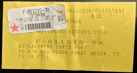

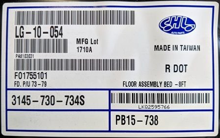

So I have one of these bed floors from NPD (guessing same supplier used by LMC) in my garage right now if anyone wants info.
Last night I grabbed calipers and measured the thickness of the cross members & floor panel and it showed ~0.063 - 0.064". Went over to my old bed and similar areas measured identically or slightly thinner (lightly corroded areas).
I was prepared for it to be a thinner gauge metal given what everyone says about the reproduction parts out there, but so far I'm not seeing it.
BTW, here are the labels on it:
