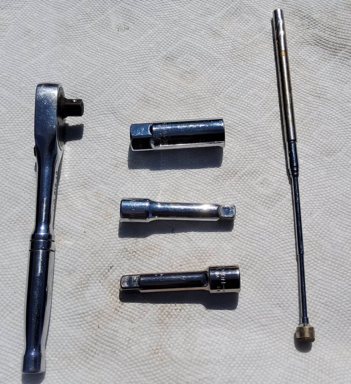

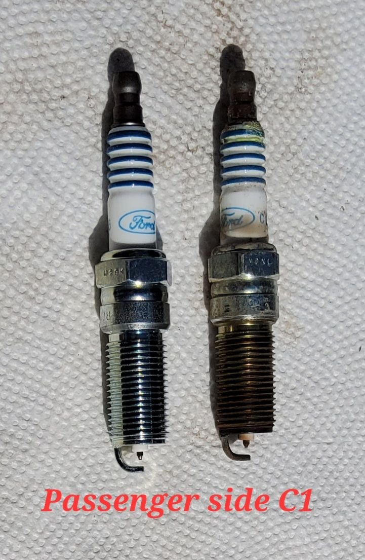

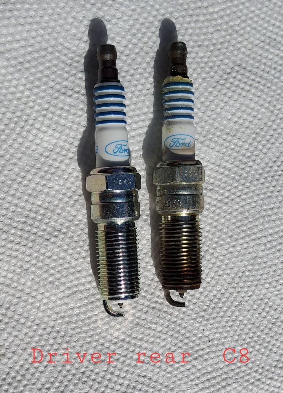

94,400 miles. Changed the sparkplugs this morning and what an easy job. It took 58 minutes and I was taking pictures of the individual plugs. For me the passenger side took a little longer just because you're working by feel. I didn't use a torque wrench just snugged them tight like I always did for sparkplugs on my other vehicles.

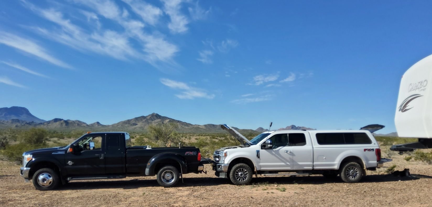

Backed the other truck to the front of the 7.3 working off the tailgate which was perfect.
These are the only tools used. 3/8 ratchet, 2 3" extensions, 5/8 sparkplug socket, extendable magnet.

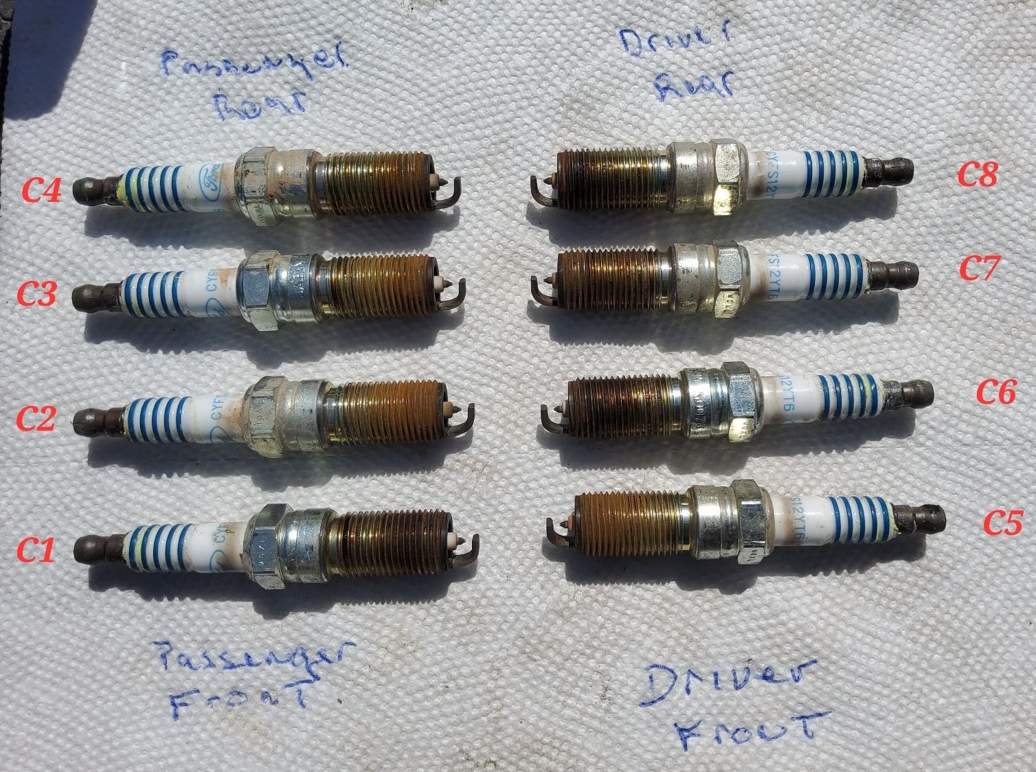

Old sparkplugs and they don't look bad at all. No problem getting them out at all.
Good for another 100k.

Spark plugs look pretty good for the mileage.
Thanks for the update.

I thought the samething of the plugs.
Here is a side x side shot.

Looking at the electrodes comparing old and new I would say it was time.
I'm going to change mine in my 6.2 this summer at 82K, I get a little rough idle at times so it will be new plugs and wires.

They look really good. Even the gap looks essentially the same as the new plug. Also based on what I can see it appears theres plenty of threads in the heads.
