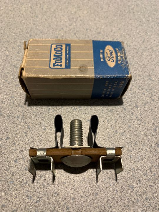

Not even phenolic - that may have held up well in comparison - almost anything would have been better. Here's an original style - although the bolt is larger diameter than original on this one - the materials are the same. Anything not metal is mostly made out of paper materials it seems like. My one 4x4 truck still has its original one intact. This is one area they could have done better.

Chevy was not any better. My 53 Chevy sedan delivery had one of those on each side of the radiator for the headlights. Water made them swell and break. Here they are and still available if they are helpful. Old clipboards were probably the same material.

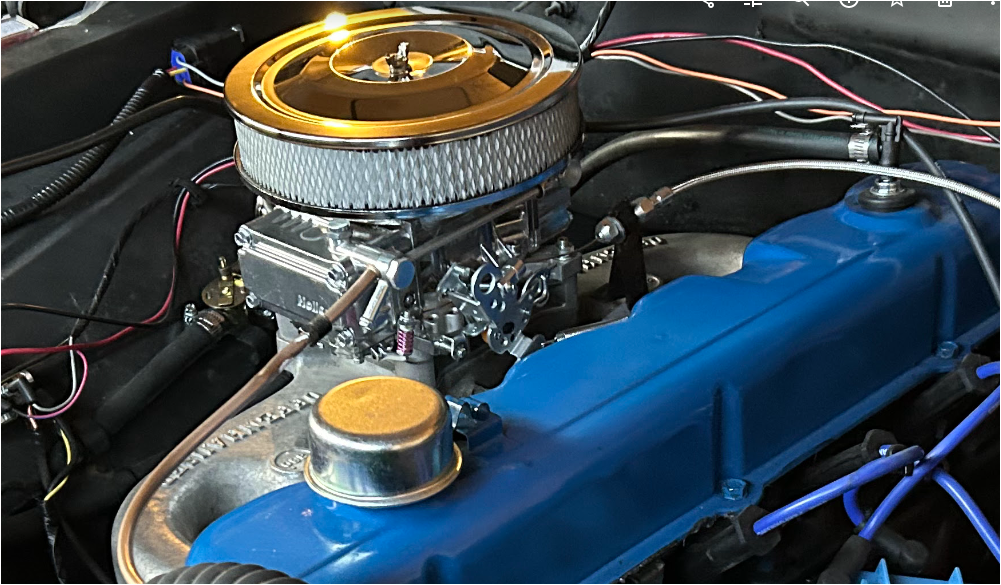

@Flameridge very nice progress so far guy.
I've been running a Clifford alum intake and headers on my 300-six-banger since 1998. No problems yet with either.
The cab-donor pickup I purchased had the Clifford goodies and a cracked engine block. I had to source a good block from another donor pickup.
I do have a spare 300 with a flat cam lobe from a 1-ton dually '71 which has the same alum intake as yours. How many years do we keep spares ? hahaha
Did you share with us where you sourced your new distributor ?
You'll be under the dash soon.
Below is a shot of my 300-inline Six in my '77 F350:
Don't laugh as it is dirty. I have a fuel filter cut in the steel line between pump and carb.
Nowadays before leving the house I will normally pop the hood to check fuel hoses to make sure one is not split and spraying a fine mist over the engine.

Decided to invest in a new carburetor. Figured out the old one was seized up and a new one looks nicer and no worries that way. Working on the fuel line and installing new throttle cable. Then it's back to wiring!!
