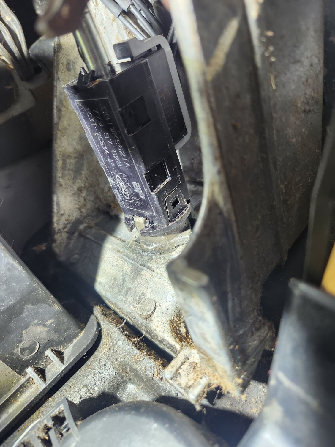

Some of you may recall that Brandonpdx was nice enough to send me a couple of clutch switches that didn't quite fit his truck properly. I installed the OEM Ford one, and because my pigtail was cut and spliced together I bought a new OEM Ford pigtail and redid my clutch wiring so that I could attain factory high idle. Which has been working great. But, the other day my truck didn't start. Pushing the pedal in and everything, nothing. But I reached down and grabbed the clutch pedal switch and twisted it and it locked back into place like it popped out of its socket or something, and it worked great, truck fired right up. I'm just curious because, I think I have mine on upside down but, that was the only way it fit properly. I recall looking at a few pictures that a few FTE members posted and if I recall correctly the plug that hooks into the clutch switch came off the bottom. Mine comes off the top. The switch is clicked into place and everything, but it only would do so upside down if I'm correct. It also seems that the pedal bottoms out on the clutch switch before hitting the pedal stop. So I think that's why the switch bumped out of place. From pushing the clutch in too far and it popped the switch out of its socket. Here's a picture of the way mine is set up. Is this upside down? If so I must need a different model switch. Or move my seat back and not push the pedal in so far....
You can also see, that the switch is set directly over the centering tab like it appears it should.
I also thought that maybe the auto parts brand hydraulic parts I used for the clutch could have the centering tab on the wrong side or, maybe it was installed upside down. So I was maybe like a few pictures on which side the centering tab is on some of your trucks. If it's on the top or the bottom. Thanks 👍

That's the way mine is.

Interesting. Maybe the bushings in the pedal are just wore out and that's why the pedal is hitting the switch. Or it could be the aftermarket master cylinder rod is the wrong length. Or maybe it's because I removed the big return spring. I don't really know. I can't think of any other reason why the pedal would hit the switch.
Well either way, I am glad that the switch is on the right direction, thank you for verifying that.

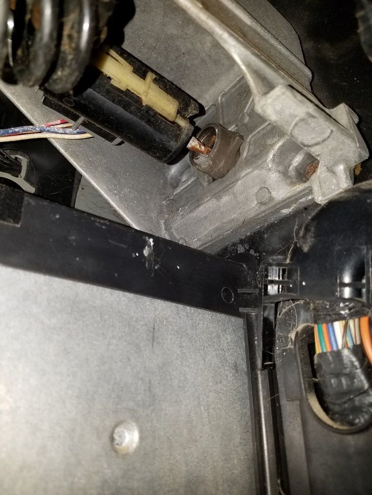

Tristan, based on some pictures I took in August of 2018 when the master cylinder retaining clips broke which raised the clutch pedal about a foot. This happened about 300 miles from home, but luckily the mechanism was designed in a way that I could still use the clutch pedal.
Image source = https://www.ford-trucks.com/forums/1...l#post18162535
​​​​​I had a customer and buddy of mine have the same issue with the master cylinder rod coming way up after the clips broke. But, IIRC that is caused mostly due to the heavy return spring. Mine broke and fell out, and I love it now that it's gone. Much easier clutch pedal to. So, when the clips broke on my buddy's truck, and the pedal way almost hitting the dash, I removed the return spring and, the pedal went back down and he hasn't had any problems scince. Seems like it's common for those clips to break when that return spring is still installed. Thanks for the pic, Im sure I have it on correctly now. thanks!
