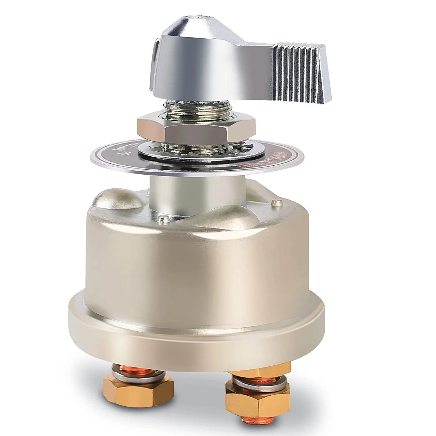

Maybe install a Master Switch under the hood and he can just turn it off.
This is 200 AMP and at Amazon for less than $20.

Please do not use one of those disconnects.. You did not specify what year, truck, or engine combination so just guessing on this fact.. Glow plugs alone draw about 80 amps before even cranking the engine so you are already near half the capacity of the switch. Those switches may be ok for a RV for main power disconnect to the house batteries but not much more.

All heavy equipment uses those master switches. Graders, bulldozers, frontend loaders, etc and they have no problems. The example I gave was a bad one. You are right that you'd need one with more capacity. At any rate I would choose it over a solar panel. It might also work to simply disconnect the battery grounds and that would cost nothing.

The switch is more than sufficient, its rated for 200A Continuous duty, the 80-100A of 30 seconds or less of glow plugs every start won't even bug it, nor the 300A+ of the starter when you wing that over. We used them on k whoppers and freight shakers and those were way bigger power hogs and much higher continuous power flow even when running and the starters draw 4x the power. on a semi you could chase a ghost power draw for weeks, disconnect made them so they could start on their own in the spring after 3-4 months.

that means his ECM is gonna have to relearn sensors every time he reconnects the battery…..why not fix the actual problem instead of Mickey Mouse “fixes”. Start to troubleshoot before any parts are ordered. Once the problem is found order the part.
