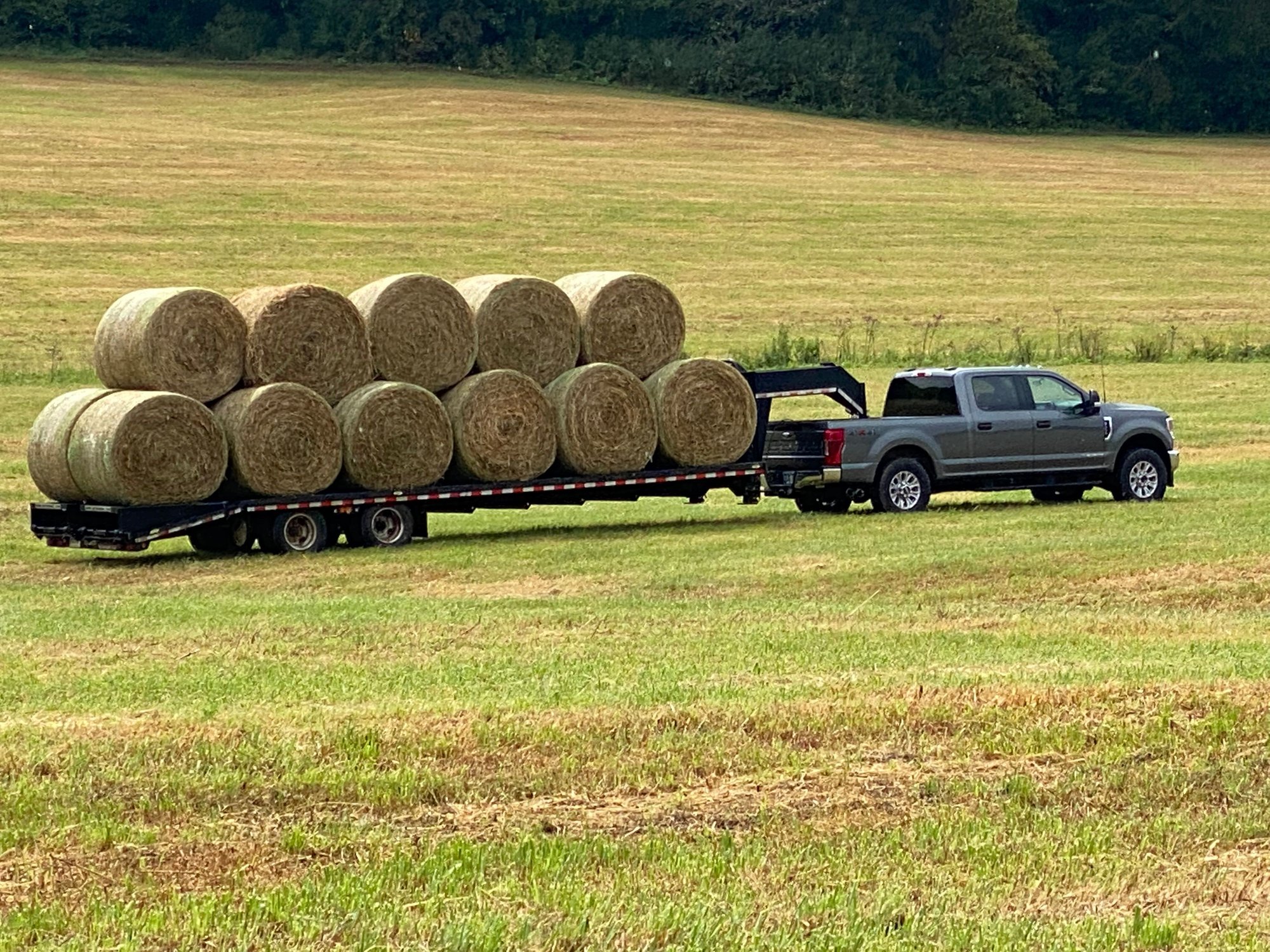

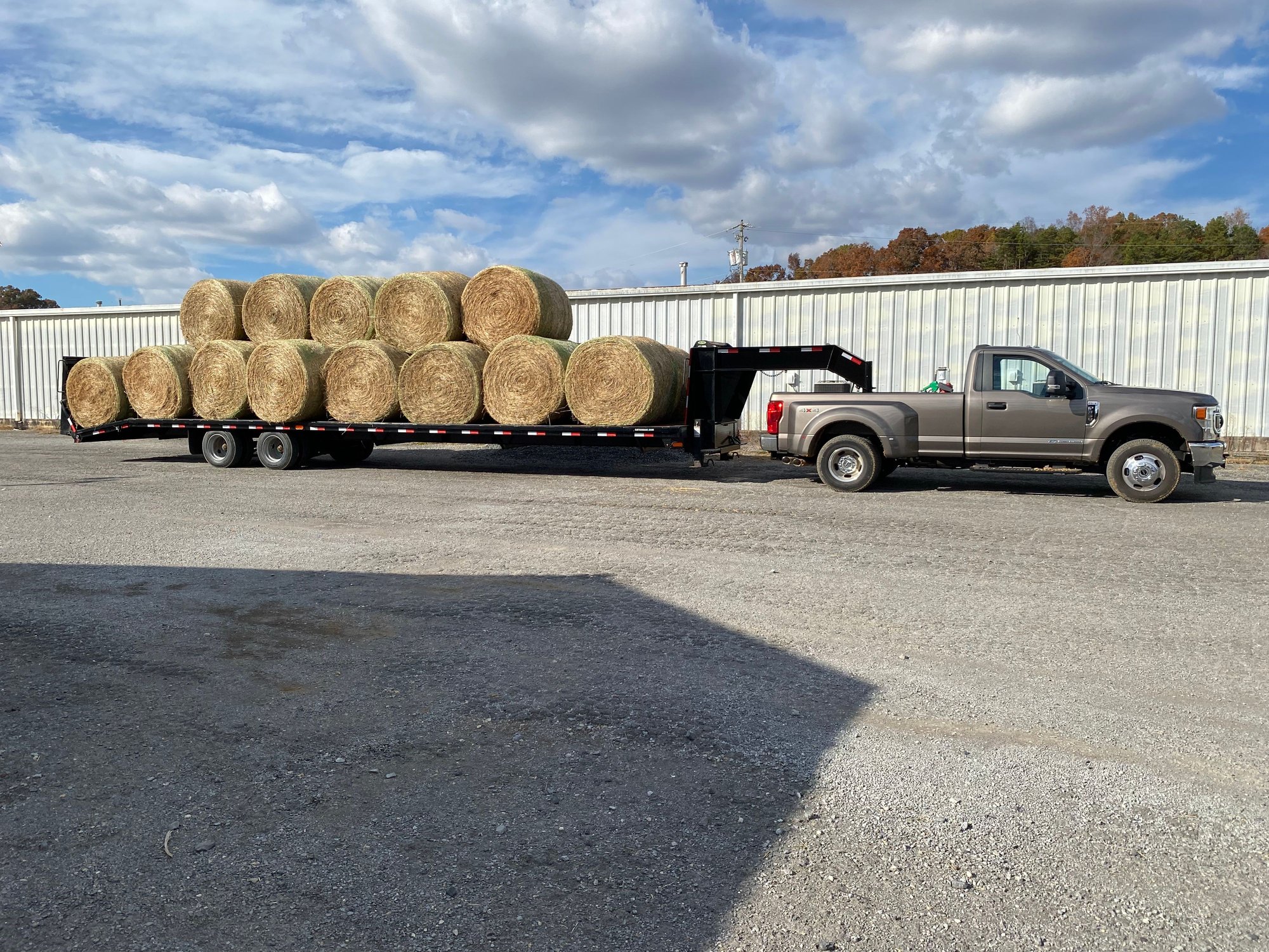

I do not know. Approximately 22,700 pounds total (865 pound bales of hay and 8,000 pound trailer)
Of course there are limits. We use a dually with the bigger trailer

Wild guess, but 5700 pounds of pin weight. With the span between pin and front axle, there is at least 25% pin weight.
