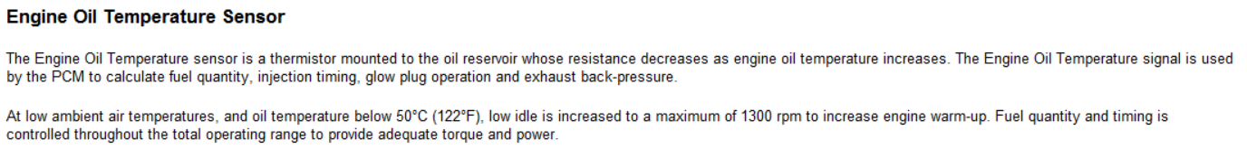

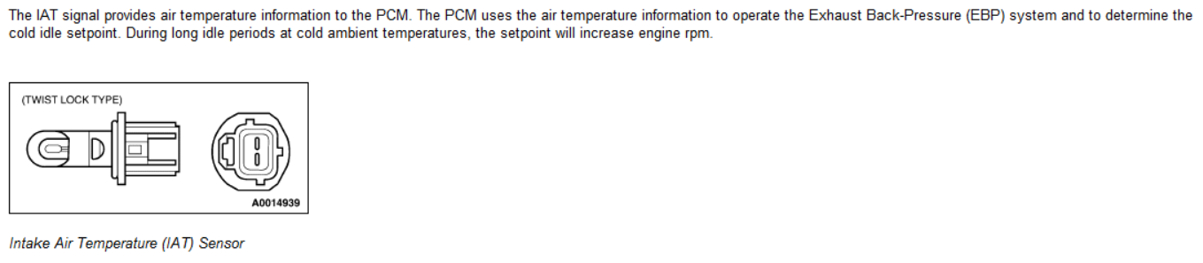

Originally Posted by udsuth78
I'm pretty sure the IAT sensor has to register a low enough ambient air temp to necessitate the high idle.
Edit: Unless you have a tuner w/ that option of course.
To your point, please see the snip from the PC/ED volume of the Ford Service Manual.
Also...
Based on some very, very light further research. The auto truck must be in park and the manual truck must have the parking brake light ON. In addition, the high idle is activated by the PCM based on the input data from the EOT and IAT sensors. For the ZF6 truck, the service brake or the clutch being applied will cancel the high idle if I remember correctly.
So, any one of the criteria above not being met will not allow the high idle to kick in.
Lastly, it takes a couple moments for the high idle to kick in. It does not start to high idle immediately after the engine has started.

udsuth78's Avatar
udsuth78
Posts: 6,129
Likes: 1,919
From: Ponca City, OK
So if oil temp is above 122 then no high idle regardless of ambient temps. Interesting, I'll file that one with the rest of the strange facts and nearly useless trivia that rattles around in my hat rack. Never know when that nearly useless trivia is the difference between getting home or calling for help. Any idea what IAT threshold is?

Sous's Avatar
Sous
FTE Leadership Emeritus
Joined: May 2014
Posts: 27,352
Likes: 5,946
From: Lake Hartwell, GA
FTE Emeritus
The only details I could find during a quick look were... I'll look a bit more for IAT input range in conjunction with the high idle more later.

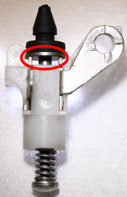

Originally Posted by Sous
Yes, the "parking brake" light must be functional in order for the "high idle" to kick in on the ZF6 trucks.
A failed bulb (if that is the issue) could likely stop the high idle from starting. Although, be 100% sure the little switch under the dash (parking brake switch) is making good contact and is functioning properly. I used a modified version of the Y2KW57 fix for the POS switch on the pedal mechanism.

Originally Posted by Dan V
What is this @Y2KW57 fix?
Parking Brake Pedal Pin Switch Fix
Parking Brake Pedal Pin Switch Fix in different thread
My version of the mod is identical to his, except I wrapped a piece of uncoated copper 24 gauge wire between the contact posts and the plate in the red circled area below. This way, there is a bit more height on the contact posts for the plate to make a connection. I did this 6+ years ago and it is still working as intended.
