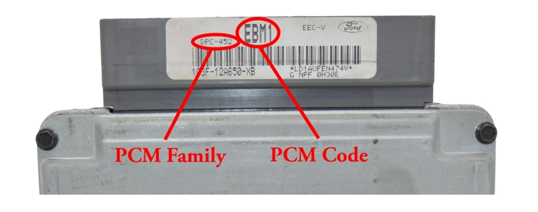

Tristan, you can find the PCM code on the case as shown below.
You can also attain some details about the PCM from the FORScan software, but I am not sure if you will find what you are looking for, I cannot remember for sure what is displayed there.

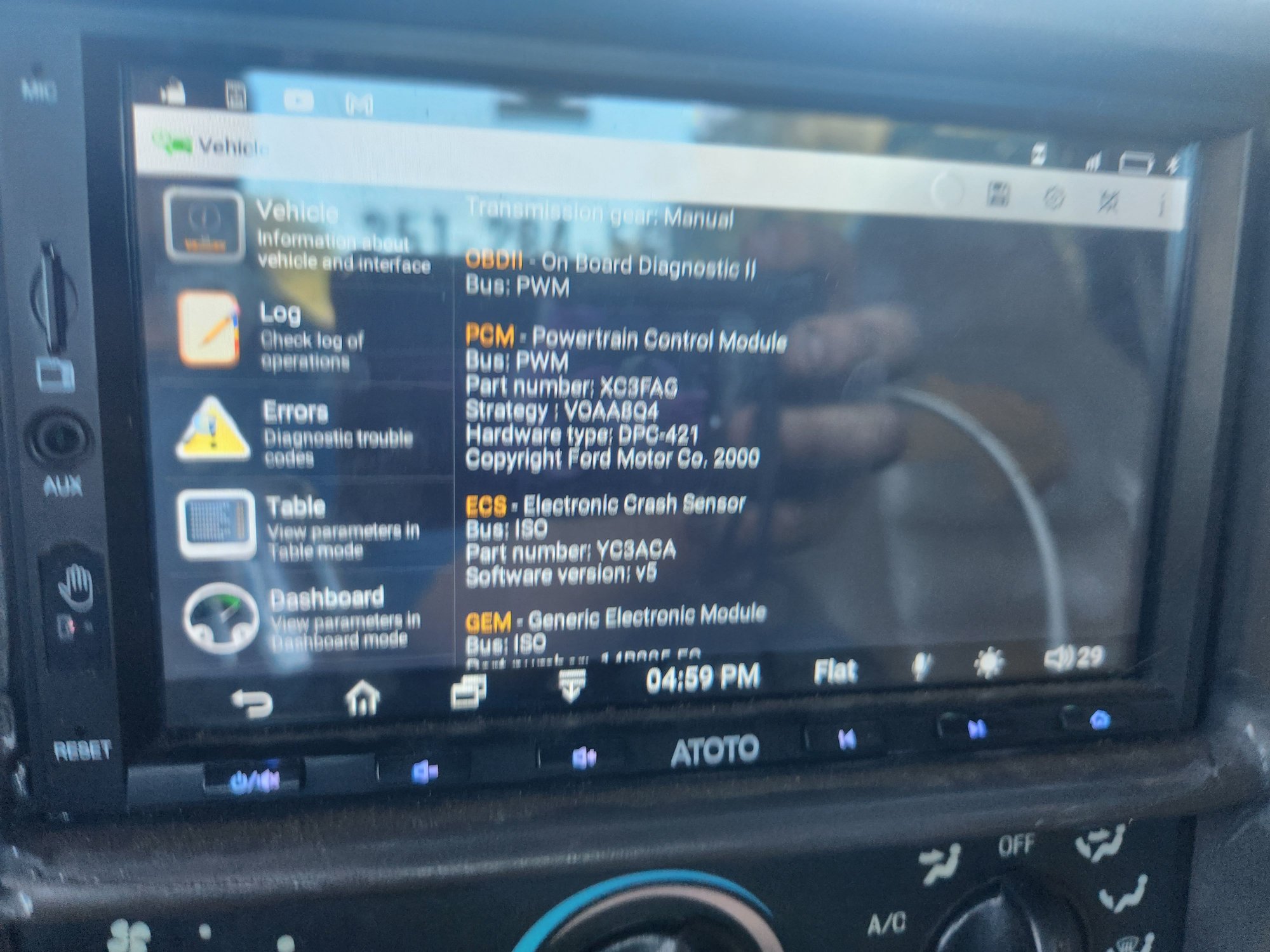

I have not been able to stop and look up at my PCM to get the part number yet but, here's what forescan says about it. I don't think it shows what y'all are looking for.

Likely xpc4 pcm so it should have factory high idle. PHP recommends the dac3 voaa7p6 hydra tune strategy for this on their hydra flash program.

Do I need to take the connector off the PCM to see the code? I sure can't see it. It's in a really tight spot to get to. I've got a mirror on a stick but I can't see anything.
Edit: found a video on YouTube of where to find the code. Give me a few minutes

XPC4. I couldn't see it from the top because of the direction the wires were going. I found it through the wheel well. Took the lower bolts loose and popped it out a little bit.
You can just barely see at the top left of the picture. But it's there
