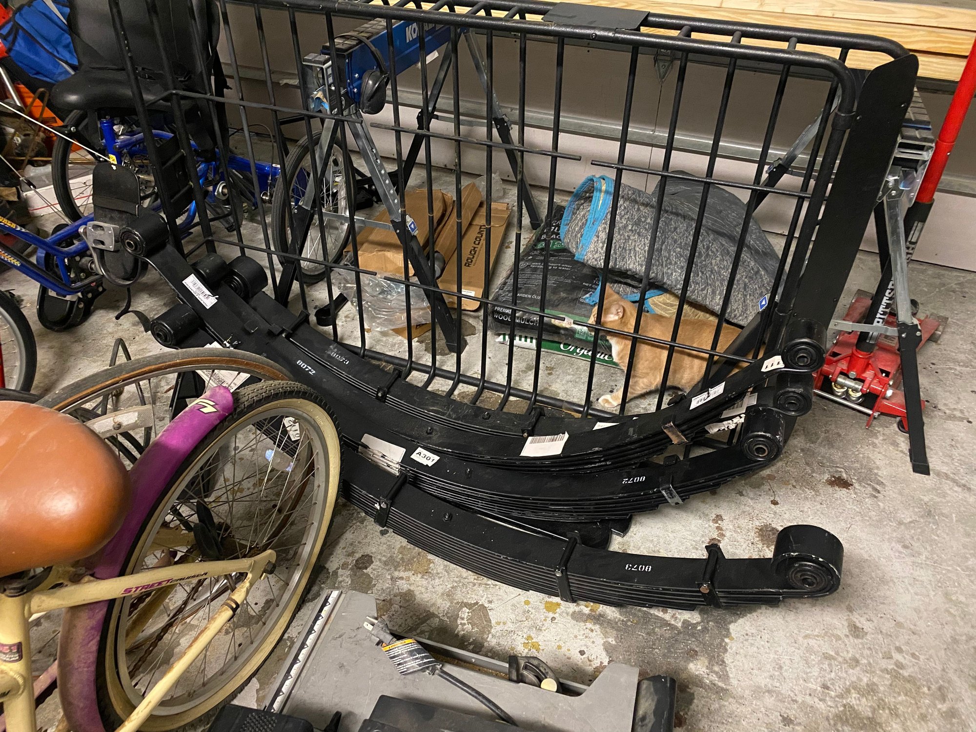

It is not the lift I was planning to go with, but got this 8 inch f250 rough country lift from Facebook marketplace today for $1250

Rough country stuff works (I've used them a few times over the years), but its on the budget end of the lift kit range. You know that kit, new from Rough Country with free shipping and original purchaser warranty, is only $1600.

Yeah I know, the kit was brand new never installed. My thought process was it was way less than what I was going to get and if I hate it I’ll just buy the one I want next and sell this one.

An 8 inch F250 lift will probably result in about 10-12 inches of lift on an Excursion.
It should look pretty good at least, assuming you put some appropriately sized tires under that much lift ( thinking like 42+ inches).
Probably won’t be much good on twisty roads or towing though, but everything is a compromise I suppose.

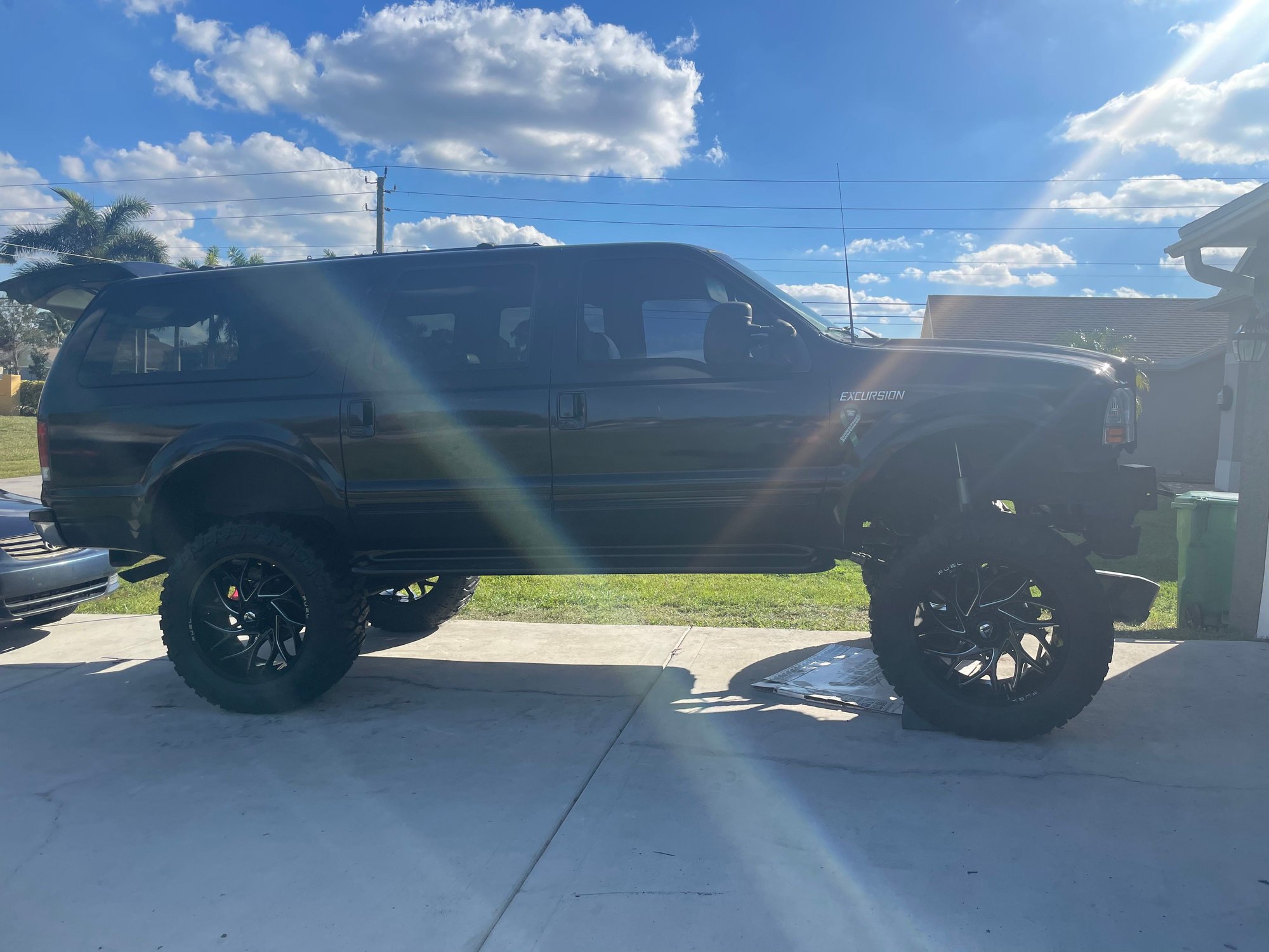

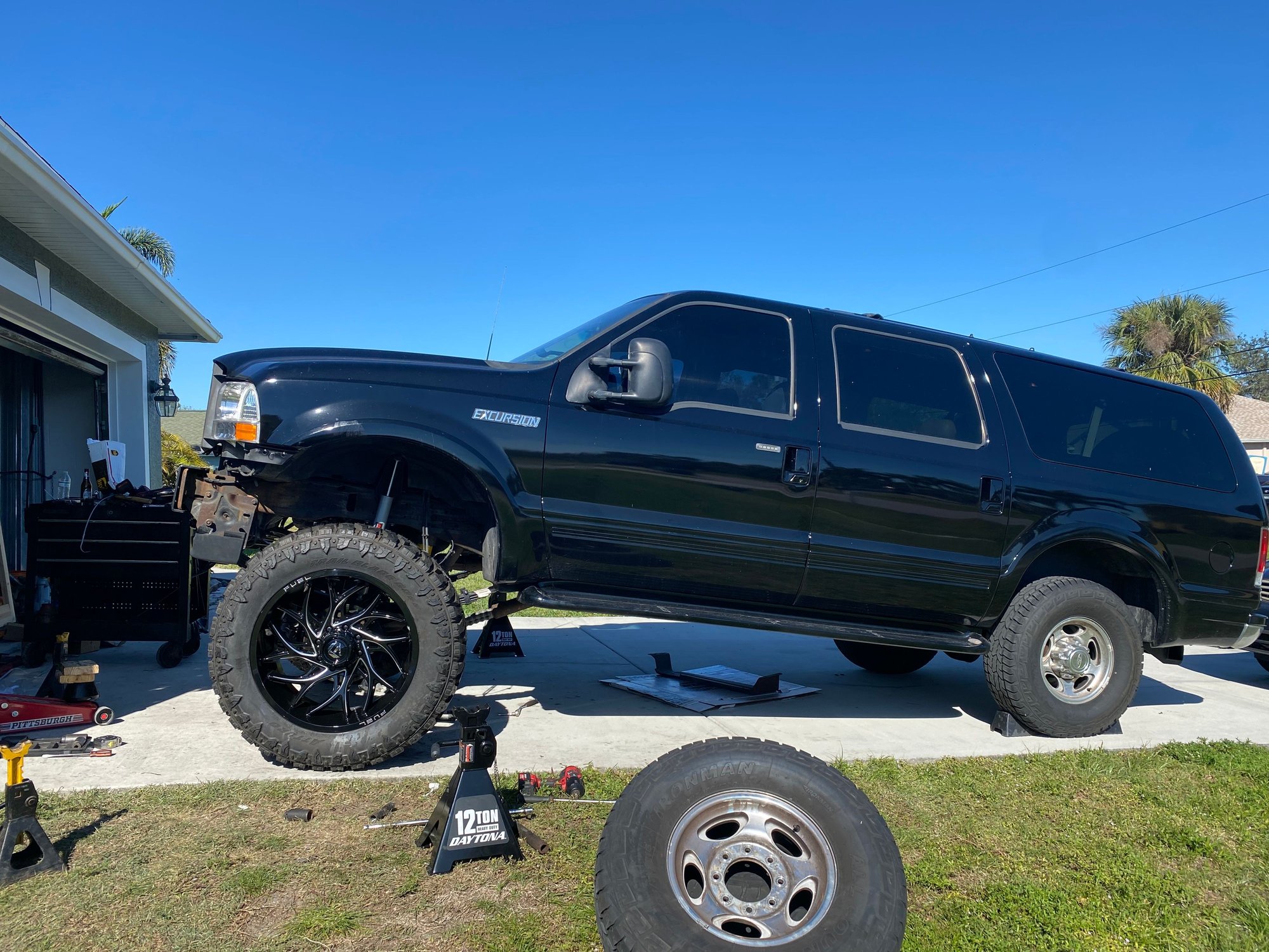

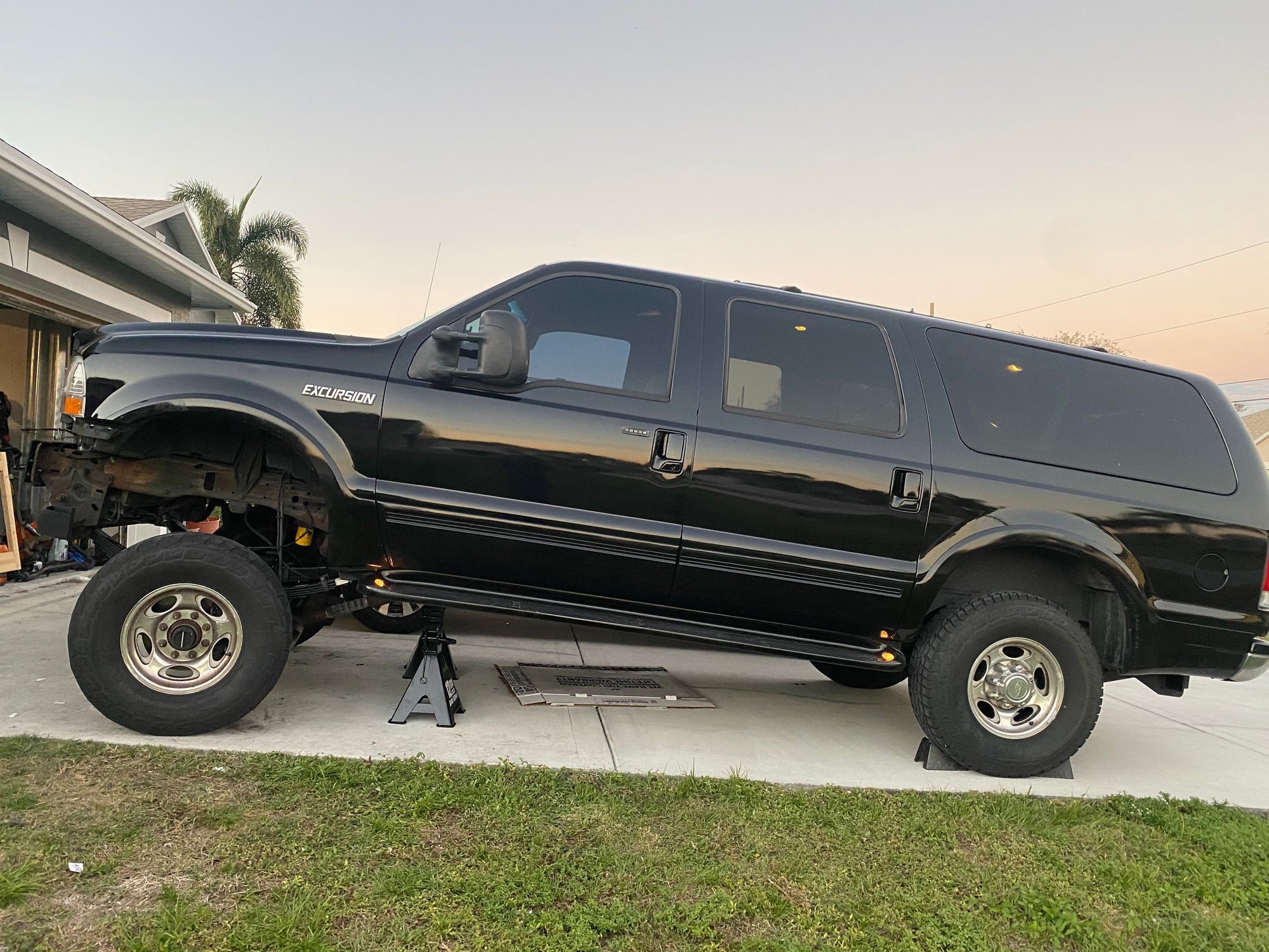

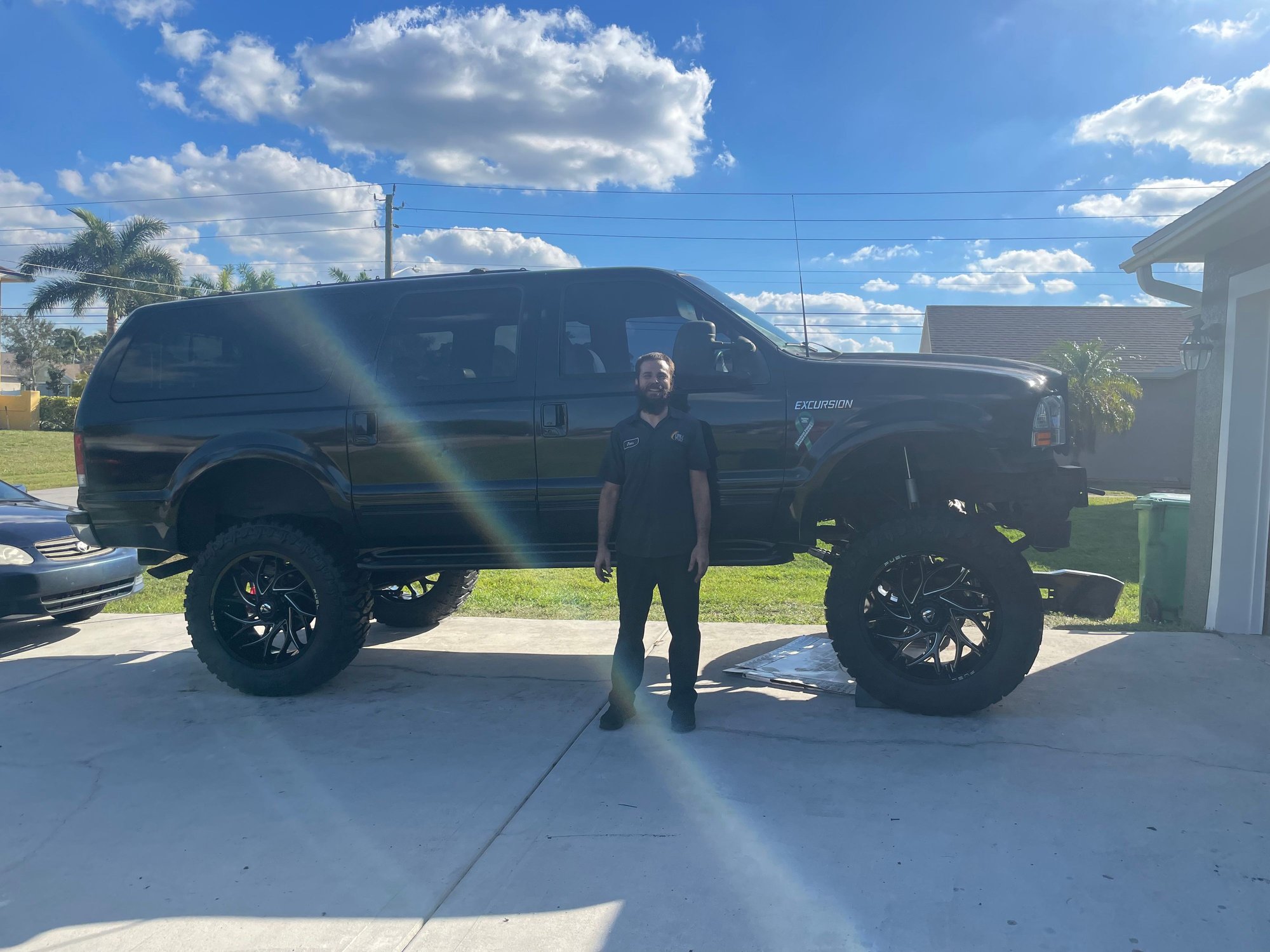

So, a bit of time has passed but I have done some work. I have installed the 8 inch f250 lift and I went with 40x14.5x24 tires. I also installed front and rear Tom woods driveshafts. For the rear aftermarket sway bar I installed the lift rough country links they sell for the f250 kit. I had t trim the front bumper plastic a small amount to keep it from rubbing. It rubs a little bit on the leafs at full lock, so I might put spacers on it.
edit: do you guys think the rear is a little squatted, maybe come up an inch or so?
edit 2: I also installed a mishimoto trans cooler. Currently has a 2 degree shim on the front. No shim on the rear. The rear drive shaft is now a dc shaft. I need to research how to install longer pins to accommodate the 4 degree shims. I was thinking about getting custom angled blocks for the rear from pmf to get the driveline angle better.

Was not sure if I had to use the factory blocks, I did lol.

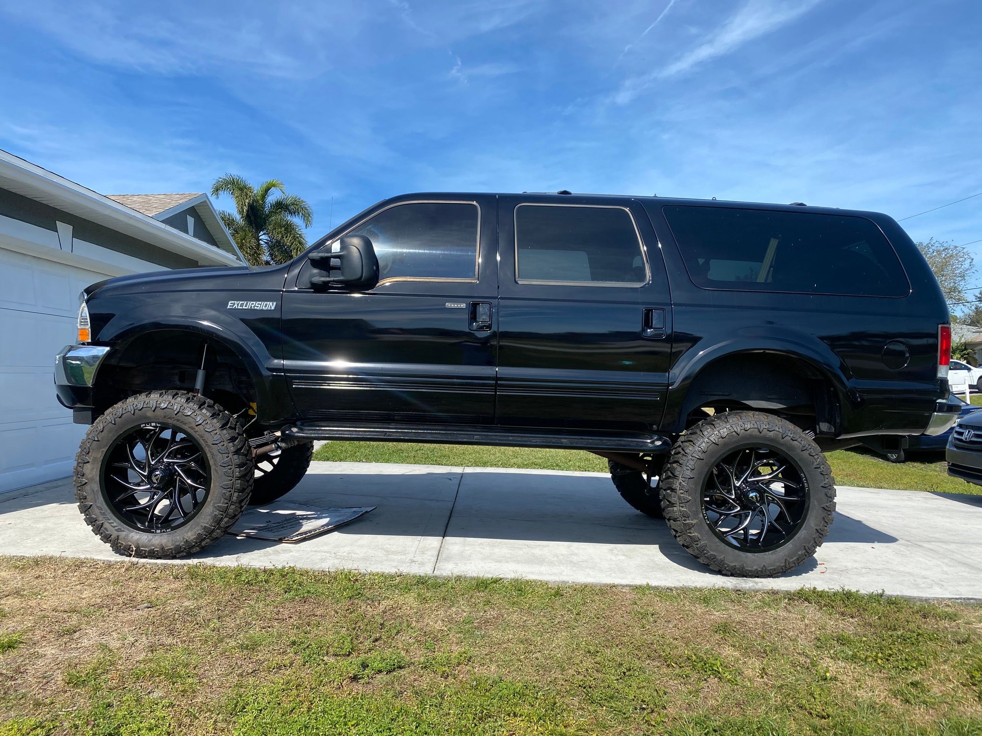

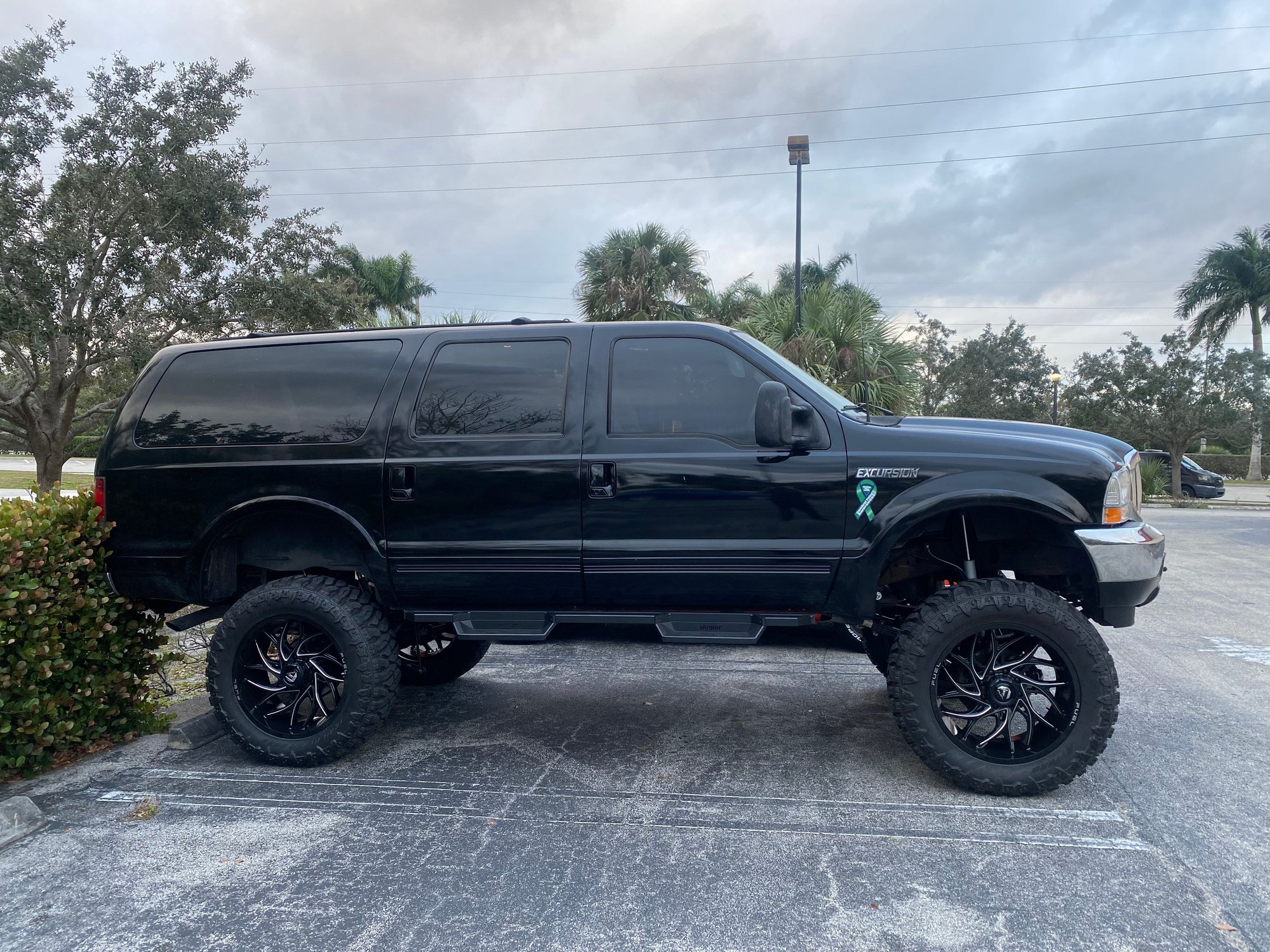

Is it just an optical illusion from the picture angles or are the wheels (especially the rear) not centered in the wheel well? Looks like both axles (again, more so on the rear axle) have been slid forward.
As for if its squatting or not, a tape measure will tell you for sure without guessing. However, leaf springs do tend to settle in after a bit, so you may want to drive it around for awhile to let everything settle in before you start correcting level.

it isn’t as dramatic in person but the do appear to be off center a little bit. Idk.

yeah, I’m going to have to agree with you based on the photos. It looks like they’re slightly forward.
For the rear, you could utilize these components from PMF to scoot your rear axle backward AND pick up another inch or two to achieve the stance you want.
PMF - Lift Blocks
PMF - Alignment plates
As for the front I think it’s advantageous to be a bit forward. Right now my 37s are EATING the rear portion of the wheel well when I go into compression. Frankly they’re just too damn big with leaf springs. Nevertheless, I wouldn’t try to slide the axle back, Instead go to an aftermarket front bumper. Typically they’re cut/clearanced at an angle that negates the visual appearance of it being slid forward.
