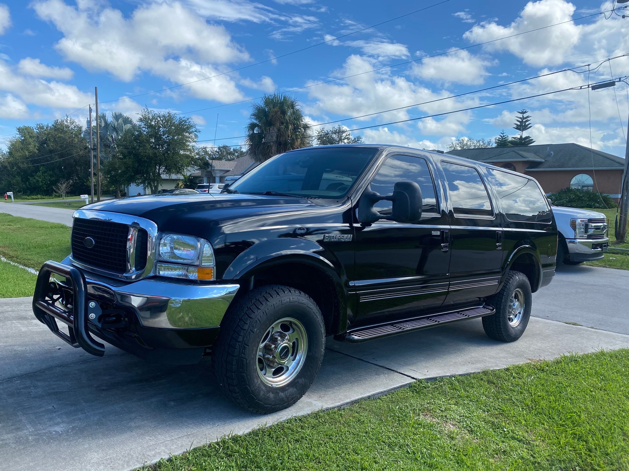

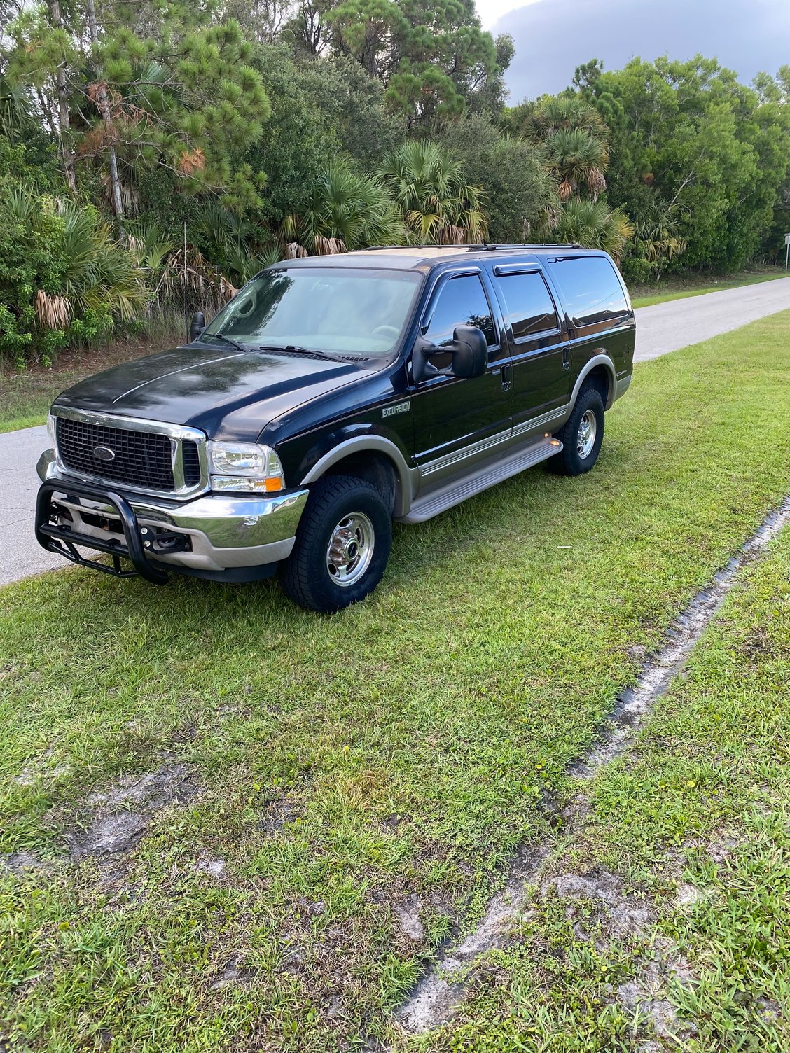

I purchased my 2001 excursion limited v10 4wd about a month ago.
it started like this, roof has some sand colored gunky stuff on there, so I had to get rid of that.
Got it back today from the paint shop today.
next, I want to lift it, I am in Florida so the bigger the better.
I want to do the BDS 10 inch lift. I know I will need longer drive shafts, is there any other common things to keep in mind?
I’m thinking of doing a 37-40 inch tire? Any thoughts?
I can get Firestone destination mt2’s for half off due to employee discount, so that’s why I’m thinking 37 inch tires.
I want something capable off road (mud) but not ridiculous on the street.

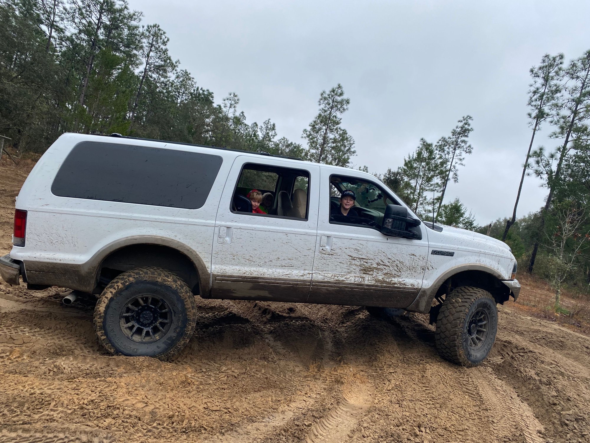

Excursion on 40s photos
