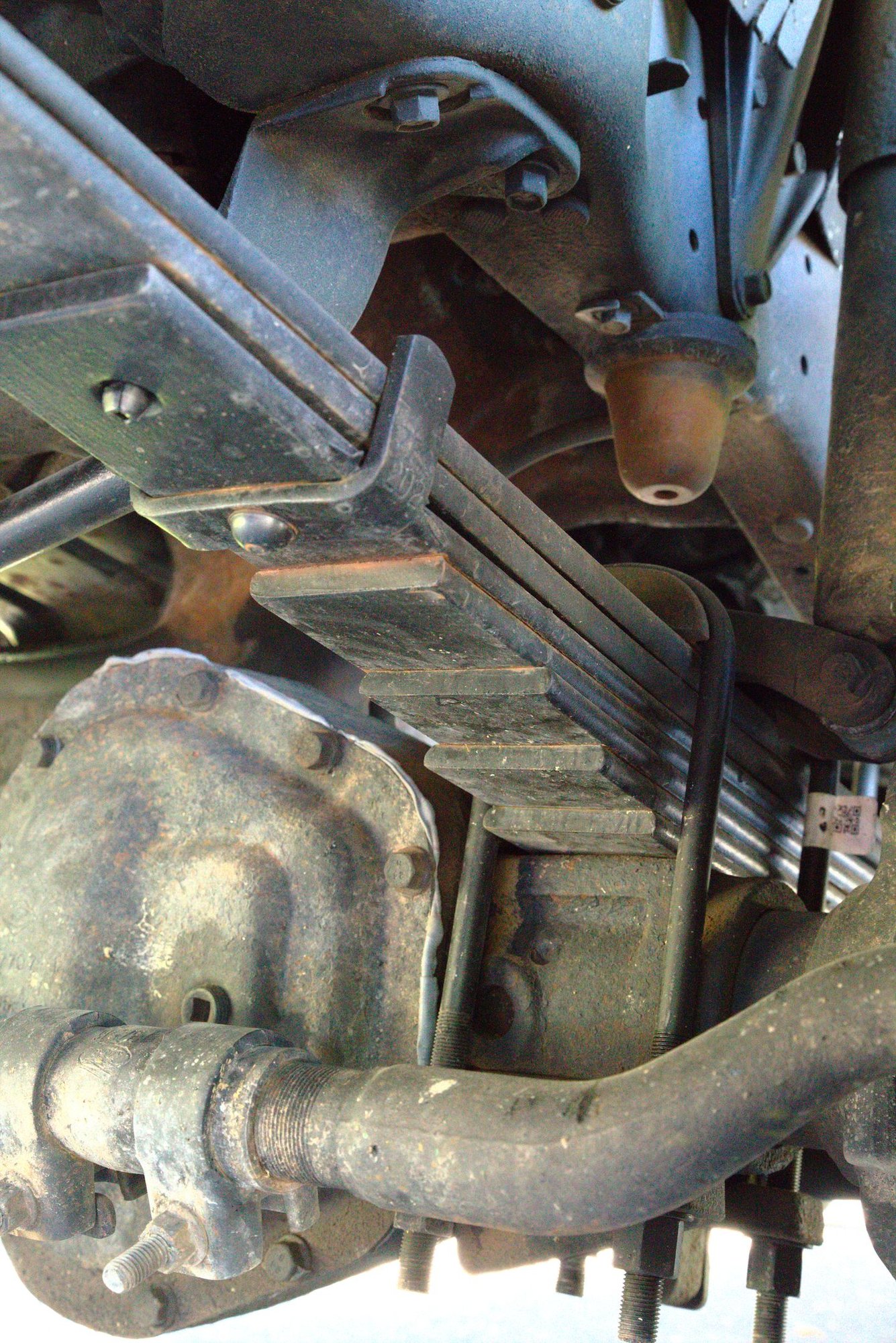

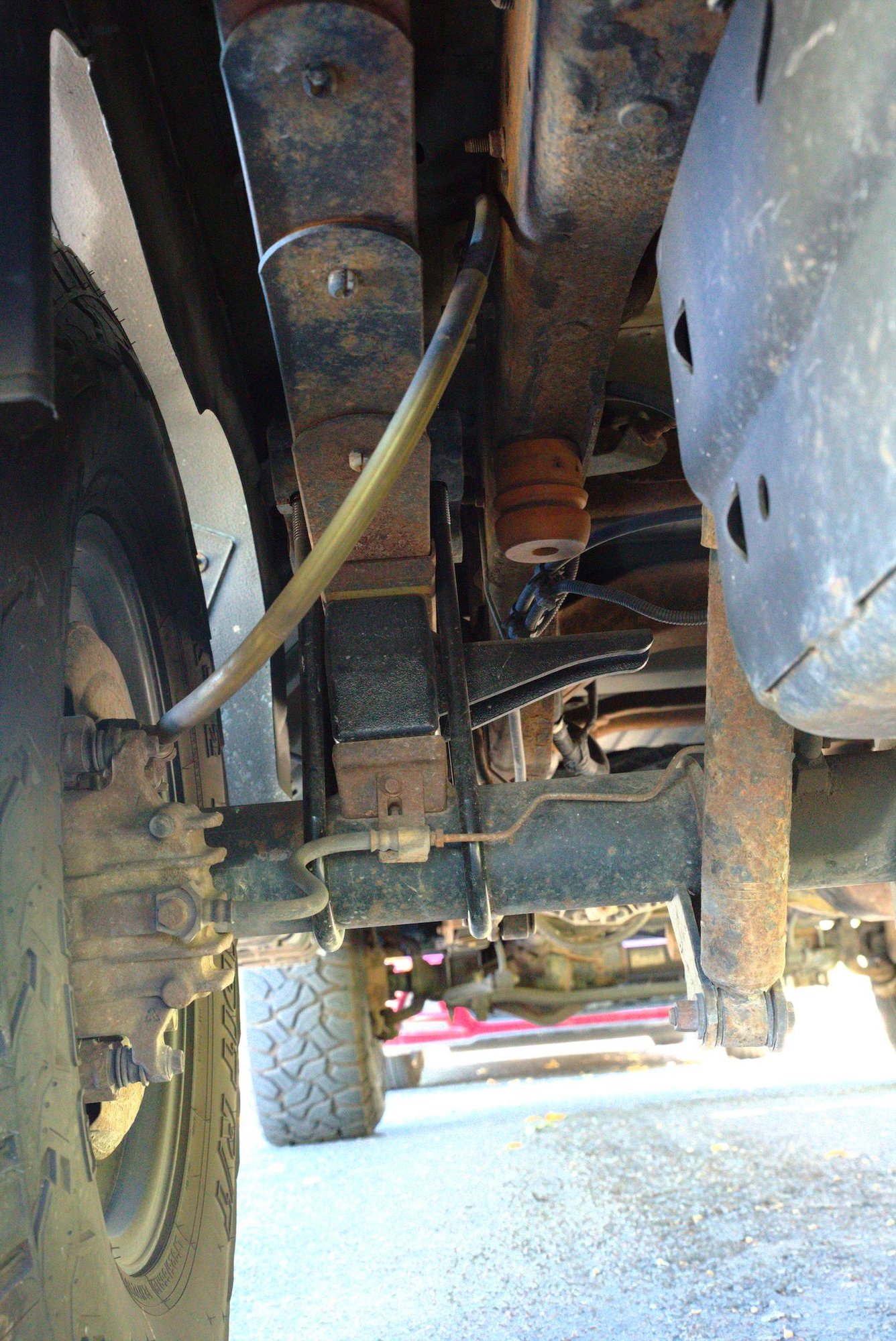

Bought my Excursion from a dealer who lifted it, not sure why but they set it up so the front is an inch higher than the rear. Maybe to try to clear the 35 inch tires in the front. I plan to put smaller tires on the truck and drop the front some to try to level the truck.

What are your goals here besides just wanting the big wagon to sit level?
Do you not want to run 35"s for some reason?
How is the current setup ride?
Swapping out the rear lift blocks for a set with an additional inch and the correct taper would be much cheaper and get the rig level.
What are the hub center to wheelwell lip measurements from all four corners now? This will determine how much lift over stock it has on it now.
Besides that droopy butt, I think your EX looks great!

My front is 27 inches center hub to fender and 26 inches in the back. Right now I have 325 65 R18 tires and It just touches in the front on turns with bumps. The speedo is off about three MPH and the mud tread on the truck is pretty rough on pavement. With the current setup there is some bump steer, but nothing I can’t handle.
This will be our highway hauler for trips with wife kids dogs and luggage, maybe a small camper in the future. I have three F350 crew cabs so my heavy hauling is covered. I don’t mind 35s and I would put Two more inches in the back, but not sure what angle would be needed to set the pinion right.
