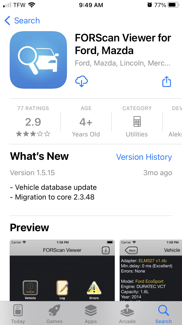

I’m not sure where to look for the sync or anything I just clicked on the sensors to watch them, I also haven’t seen anything on where to do a buzz test at or how to set it up. I know there’s a few different apps to use for FORScan right now I’m using car scanner and it has a engine on the front. I downloaded the FORScan app and it wouldn’t connect to the scanner

I don’t think so no. I’m not sure if I have the right one or not.
This is the app I have now.
This is the first app I had and couldn’t get it to connect to the scanner. I have the Kobra ELM 327 interface. And it was telling me it was unable to identify the vehicle.

Car Scanner is a separate APP. Just like buying parts, the software programs are all different. Some APPs may use the same adapter as others, but then again some adapters may be VERY specific for a specific APP.
For a smartphone, you need ForScan Lite.
The version for a laptop has a few extra features and is handy IF you already have the laptop.
We can tell you what works, but there are a lot out there that don't work ...... and not many people (if any) are up on all of those software options.
If you don't like ForScan, then get Torque Pro. DieselTechRon has a video for that APP.
