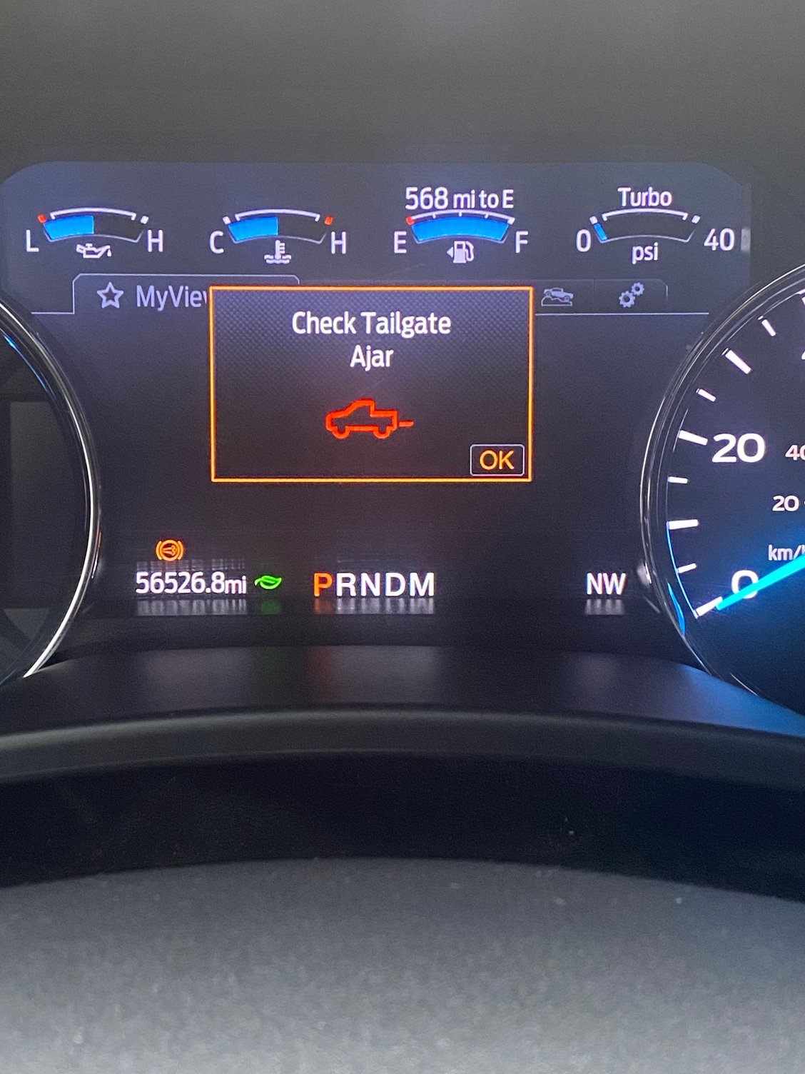

My tailgate dropped on its own today, this is what I saw….

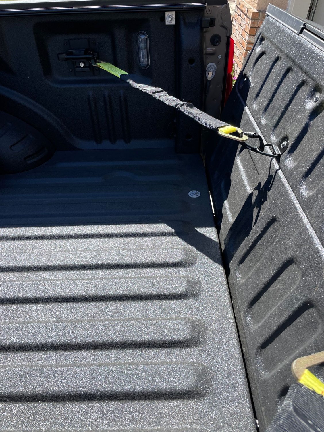

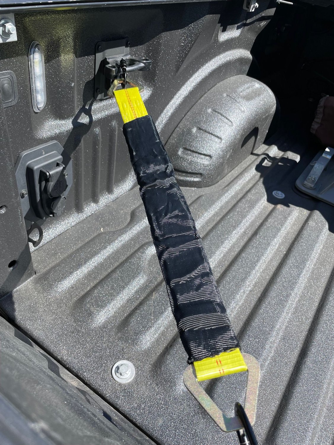

I have not yet had issue with this, and hope I never do. Especially while towing. Having read on this site that this is a potential problem for some owners, and we all know how difficult it is to get parts, I decided to be proactive and attach these straps when I tow

Super dave 71 what truck do you have? Year model.
Mine has opened 2 times and i never saw this on the dash.
Do you mind sharing what parts you bought and where you got them. I would definitely like to do that while pulling my 5'er

I have a 2022 CCSB Lariat Ultimate. I’ve only seen that message twice, and only when I didn’t intend on having the tailgate open. If I open it from outside, inside button or fob truck on or off I do not see the message.
Not at all.... Amazon, about $55 total
Amazon Amazon
Amazon Amazon
Amazon Amazon
