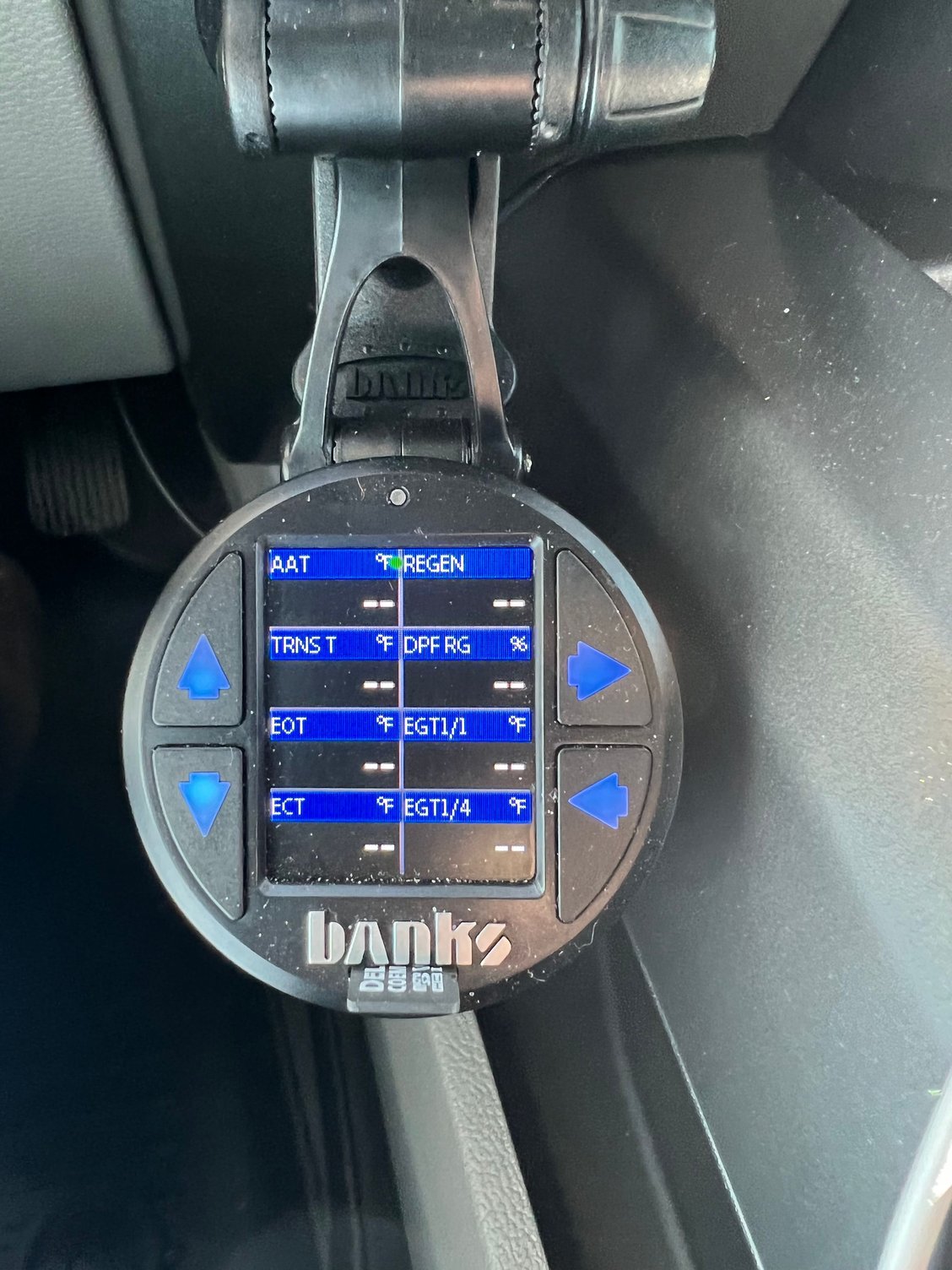

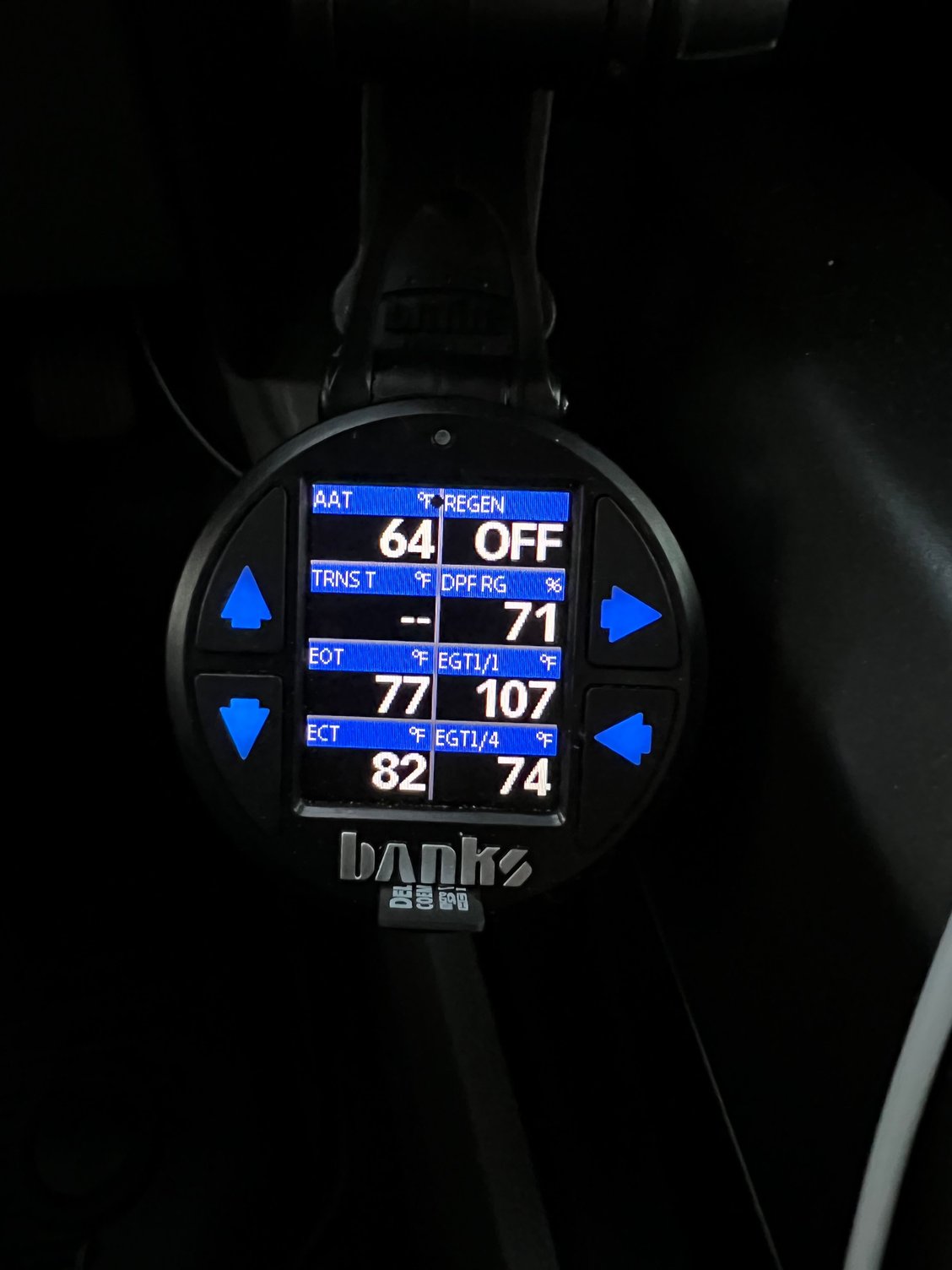

So I bought the Banks iDash Data Monster November 26, 2021. I ordered it from direct from Banks. It arrived shortly thereafter and I installed it in my 2022 F250 with 6.7L PSD. It shipped with the most recent firmware version at that time, which is still the most recent (v.1.23.0). Under vehicle settings I chose Ford 6.7L. I set up 4 different pages with various PID's. All was well...
Then sometime soon after I started noticing that sometimes when I would get in and crank it up, the transmission temp PID would display "--". So, I would actually stopped the truck (if I had already started driving), shut it down, then waited for the iDash to shut off, and then cranked it back up. This always "fixed" it... but it got to where it was doing this fairly often...
Then, about 2 months ago, one day I looked down at it while driving down the road, and the whole thing was just dark... I reached down and felt that the cable was still plugged firmly into the OBD2 port, so I held the down arrow button on the iDash to force it to come on... but then every PID on each page displayed "--" except the battery voltage, which actually displayed a numerical value and looked to be accurate. So, I just reached down, unplugged the iDash from the OBD2 port and then plugged it back in. This was while driving down the road. It booted back up and all PID's displayed appropriate values. Then I noticed that this happened again... and again. At this point, in the last 2 months it's probably not come on 8 or 9 times now. As well, on occasion it still has issues displaying the transmission temps...
To make sure, I rechecked the iDash's firmware version and confirmed that it was still the most recent. After this, I emailed Banks and described to them what I described above. It took them 8 days to get back to me... and when they got back they really focused on the fact that my firmware needed to be updated. The person explained that the transmission PID was a known issue on previous firmware versions, but the most recent version (v.1.23.0) fixed it. The person never mentioned anything about the fact that the iDash wasn't even coming on at times... Besides all of this, I very specifically stated in my original email to them that "I had checked the firmware and it was the most current version." Honestly, this kind of bummed me out that I waited 8 days to get a response, and the response told me to do something that I specifically stated was up to date in the original email... I don't know if the person that responded even took time to actually read my email...
So, I responded back and informed them that everything was (still) up to date. And now I am waiting for another response... which I don't expect to get for a long while now, especially being the 4th of July weekend. That's fine I guess... it mostly works... but for something that I paid $400+ for just 7 months ago, I would hope that this isn't just something I have to live with. For kicks, I did go ahead and download the most recent version and replaced the same, most recent version that I already had on the iDash for a fresh version... but the very next morning, the transmission PID displayed "--" again, so yeah... that didn't work...
Just curious, has anyone else had issues like this with their iDash?
Most current version. V.1.23.0
All PID’s display — after forcing the iDash to come on when it didn’t automatically come on when the truck was cranked…
… but the battery voltage still displayed a value.
More often the transmission temp displays — instead of an actual value.
Last edited by chadstickpoindexter; Apr 14, 2023 at 12:13 PM. Reason: Updated title

That's what I did, thinking the same thing. But the very next morning, the transmission temp displayed -- when I cranked it again. Maybe they need another update for this version with 22 SD's? I dunno...

My issues are somewhat similar... but not exact. I started having the trans temp issues from the moment I installed it, with or without the SD card installed. For a few months I did not install the SD card because of the location I have the iDash installed, which is near my knees and I feared that I may hit the micro SD card with my knee and break it off inside the iDash. (Which is another issue I have with the Data Monster... the SD card sticks out way too far IMO.) But you are right, it was after I had the SD card installed that I started noticing that the iDash sometimes would not come on at all, however, when I would hold the down arrow down to force the iDash to come on, it would not correct itself and eventually begin working. The only way I could get it to work correctly was by shutting the truck off and turning it back on, unplugging the iDash and plugging it back up, or by going into the settings and choosing "Ford 6.7L" under vehicle selection, which would force it to reboot.
And to update my original post... FedEx delivered my package to the wrong house... but it eventually found it's way back to me! I stayed in touch with Banks the whole time and they informed me that we would have to wait for the issue to resolve with FedEx, but that if it wasn't found, they would ship me another one without charging me for the lost one... thankfully though, it was found and made it to me!
The day I got it, I installed the new one, set up 3 pages that mimicked my original one (I left one page off that was a bit redundant), and took off! I drove a couple of miles to get some dinner... then when I got back in, the trans temp parameter was -- ... and this was the new one! So, I got back in touch with Banks and let them know I had finally received the replacement and mailed the original iDash back to them, however, I also let them know I was experiencing the same issues with the trans temp occasionally not displaying. We both agreed that it was most likely not the iDash, or the cord at this point, and most likely was either just a software bug with the "Ford 6.7L" option (although, no one else has reported issues so far), or something about my specific truck... He said he would file it and speak to some of the guys at Banks to see if there was anything they could find that may be specific to the newest MY trucks, and if they find anything they will get an update to correct it...
So, for now, I will just deal with the occasional non working trans temp PID. But, so far, the iDash has turned on every time I have cranked the truck, so that is a good thing, but if it starts not coming on again, I will try pulling the SD card out for a while to see if it makes a difference. But, if that does become the case, it will really make me wish I had saved the $$ and just went with the regular Super Gauge... and at this point, I kind of wish I had just done that anyway.
But, they did take care of me in the end, which matters! And if I have anymore issues, I will just go directly to calling them to deal with issues rather than sending an email... despite the super long wait times (but at least they will set you up as a call back so you don't have to sit on hold for an hour or more!) Until then though, I am hoping that the trans temp issue will either work itself out, or they will put out and update that fixes it... at least in my case!
