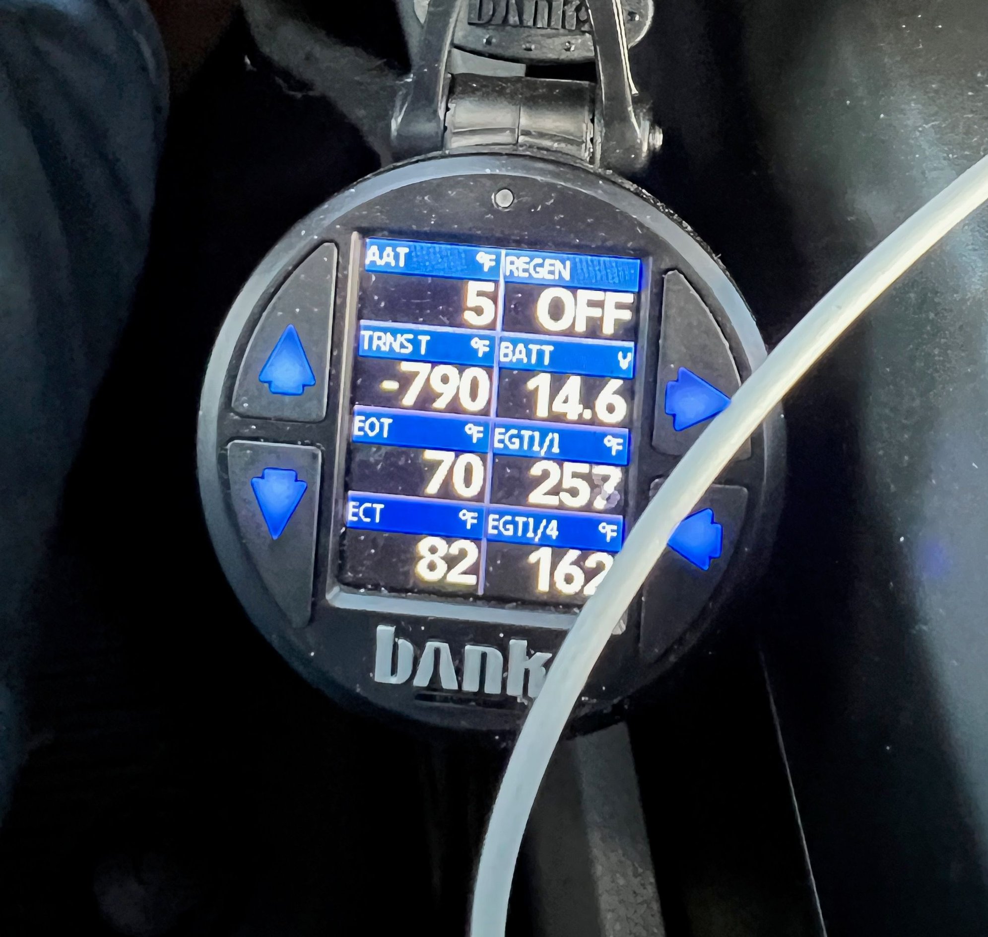

ANyone have an issue where the idash wont power up with engine start, but if you unplug the ODBII and plug it in with the truck running it comes alive? It did it a few times before, but now that I forscanned and set the auto regen checkbox active, it doesn't come on at all on engine start, only by unplugging and plugging it back in does it turn on.
the idash comes on by monitoring the battery voltage drop . Voltage drop signals the idash that the vehicle is being started.
there is a setting to set the sensitivity
also, you shouldn’t have to unplug and reconnect the odbc connector…pressing the up or down button will wake up the idash.
Yes, I've had the same issue. One day after starting the truck and driving off I noticed the gauge was off. I tried pushing the up/down buttons but didn't work. Pulled over, killed engine, restarted.... still nothing. I unplugged and re plugged and it came on. I messed with the wake up sensitivity in the settings and it seems to have helped. But haven't driven the truck much since then, so can't say if it's a definite fix or not.

I have had the issue where it wouldn’t come on at start up on 2 different iDashes. And if I hit the down button to force it on none of the PID’s would actually read values… they would all say “- -“. For a while I would simply unplug it and plug it back in and that would get it to come back on and actually report values, or I could shut the truck off and back on and that would most likely work. When I called Banks they of course sent out a replacement, but it also does the same thing occasionally. They never even mentioned to me to reset the sensitivity settings, I assume because even when forcing it on it wouldn’t read correctly. Also, mine still has issues reporting trans temps pretty often, which has been an issue for a while. According to Banks, the update to v1.23.0 that came out last March (2021) addressed that issue on some models. It must not have applied to the 22’s though.

Mine on the rare occasion will do that, but not often, but like fritz said, pressing one of the buttons will wake and turn on the iDash.
I was having the same issues as listed above before I set the sensitivity setting to low.
Go to settings...
Go to other settings...
I switched mine to Low as i had the same problem...

Mine would be dead, pressing buttons did nothing, only unplugging and plugging back in WITH the truck running turned it back on. I set the sensitivity down like above, so will see if that helps. I just find it strange that it started acting up after I did a forscan change for the regen checkbox.

Just for giggles I went in and changed the sensitivity setting on mine to low as well the other day. Then getting in the truck this morning it didn't turn on and when I forced it on all the values read "- -". So (as I expected) it seems that the sensitivity setting wasn't the issue with causing mine not to turn on. I still think it's a software glitch with the current version of iDash and the 22's, or maybe it's just my truck... but with others reporting similar happenings, I am kind of leaning towards a software glitch... Saying that though, it happens so infrequently that it doesn't bother me...
On another interesting note, when I got in my truck this morning the trans temp PID indicated that it was at more than -800F! I snapped a photo but it had dropped down to -790F! LOL... It finally switched over to normal at about 32F...
