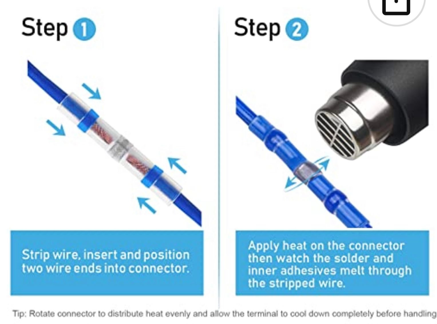

Another option is to make it a permanent splice but leave extra wire to make another splice in case you ever need to replace the lamp. Since they’re led lights, it is highly unlikely you’d ever have to touch them unless they get damaged but leaving some extra wire length won’t hurt. A couple of solder splice butt splices would do the job and eliminate the need for shrink tubing. Here’s a set I found on Amazon but I know others make and offer them as well.
Amazon Amazon

I'm going to try one of these. It's 3" long x 1" diameter. I attached a piece of aluminum 1.5"x1.5" angle under the bumper as a bracket for the number plate. Will tuck this up under the backside of the angle and transition to the tail light wiring. It will need a dab of silicone on the gland washers because they won't squeeze small enough.
