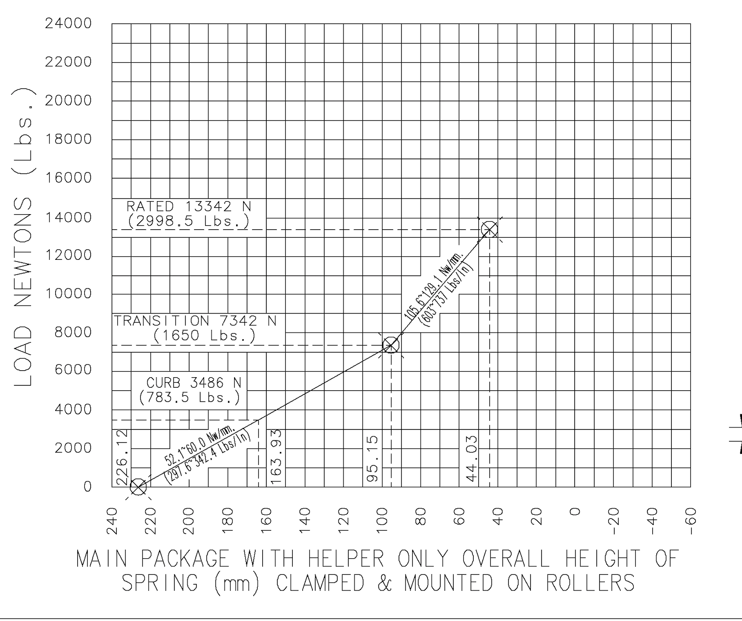

you didn't "mess up" but your travel numbers are off a little bit. the stock f350 spring the 23311 is modeled after has 5" of travel on the primary and 2" on the secondary.
but your aproximation was close.
what I mean by you are the engineer is you are setting the bump stop position and therefore limiting the uptravel which ultimately determines how far the spring bends and equals the capacity.

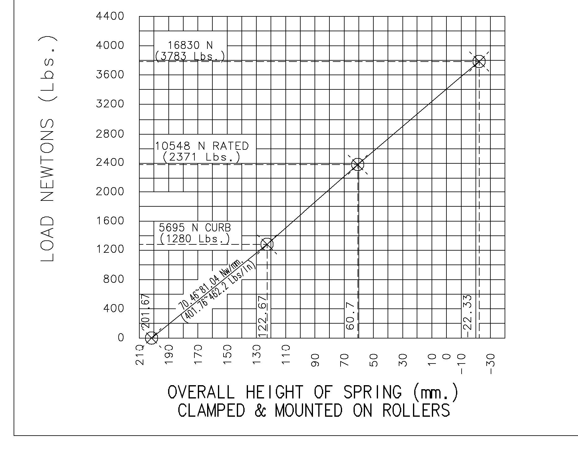

as you can see by this graph of the F350 rear spring ford chooses to limit the travel at a height of 44mm
the second graph is the stock rear Ex spring, ford limited the travel at 60mm giving a "capacity" of 2371 lbs
but if you set the height to -22 the "capacity' would be 3783
