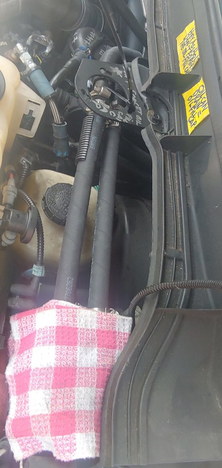

Emptied my can today. Took a couple pics of where I have it and extended lines.
I have the can on a piece of 2×6 that's on top of the fuse box on driver's side. That's a rag to prevent vibrations plus I have a piece of tube that I cut a slit into that is on the fender to prevent vibration that caused noise before I had it there.
Enough slack in the lines to go behind the SNAPP filter for the S&S DPK kit when in.
