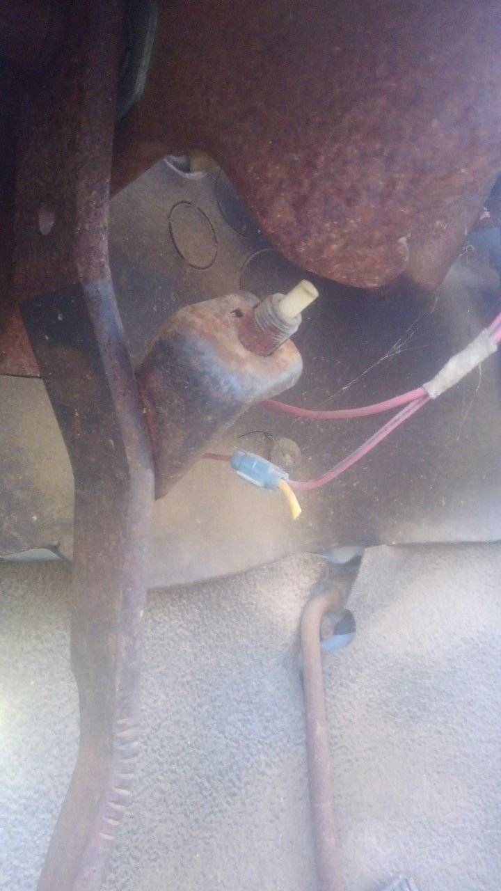

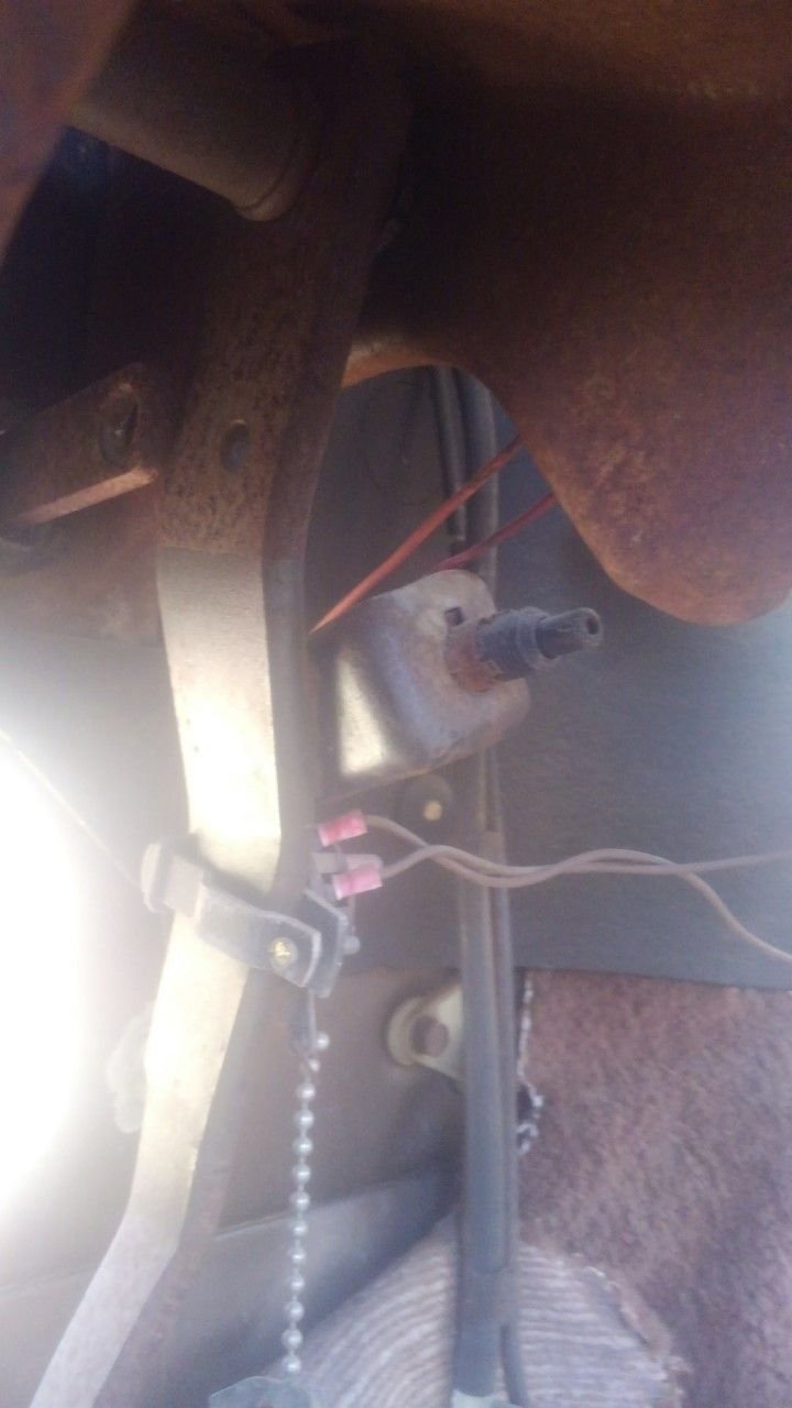

Do you have a switch that looks like this? Pay no mind to the aftermarket cruise control switch attached to the pedal. X2 it should be easy to replace the damaged wiring and give you more slack, so it is not getting pulled tight.
I am not sure honestly....I did not get all the way under the dash yet to check that out

That part is not really way up under the dash, it should be right there just up from the brake pedal.
I just couldn't get the angle...between family's cars visiting for easter and stuff I could not even open the door halfway...I am gonna check it all out later
