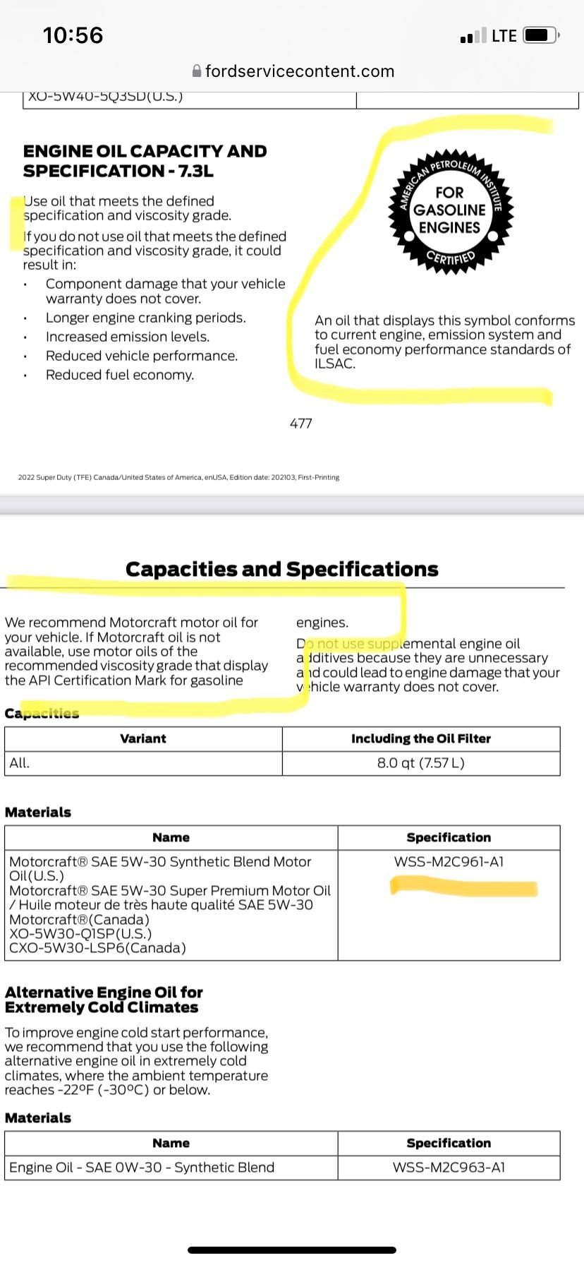

Originally Posted by IADiver
Is Mobil 1 on the approved list? I didn't thin it was. Just asking, not judging, I have used it in almost every one I've had in the past.
Per the manual, an oil with the “API certified for gasoline engines” symbol meets the needs (noted by yellow marks).
However, the manual also states the Specification as Ford WSS-M2C961-A1. (noted by orange marks)
Mobil1 Advanced Full Synthetic 5W-30 has the API symbol, but is not listed as meeting the specific Ford spec.
Mobil1 Truck & SUV 5W-30 full synthetic IS listed as meeting the Ford WSS-M2C961-A1 spec.
I’ve not used Mobil1 Truck & SUV before so don’t know how widely it’s available on the shelf in my town. Having seen a couple posts about 7.3 engine failure, it’s probably a smart move to use oil that meets the specific Ford spec just to be safe and CYA. I need to do some more homework on oils that meet that spec.
