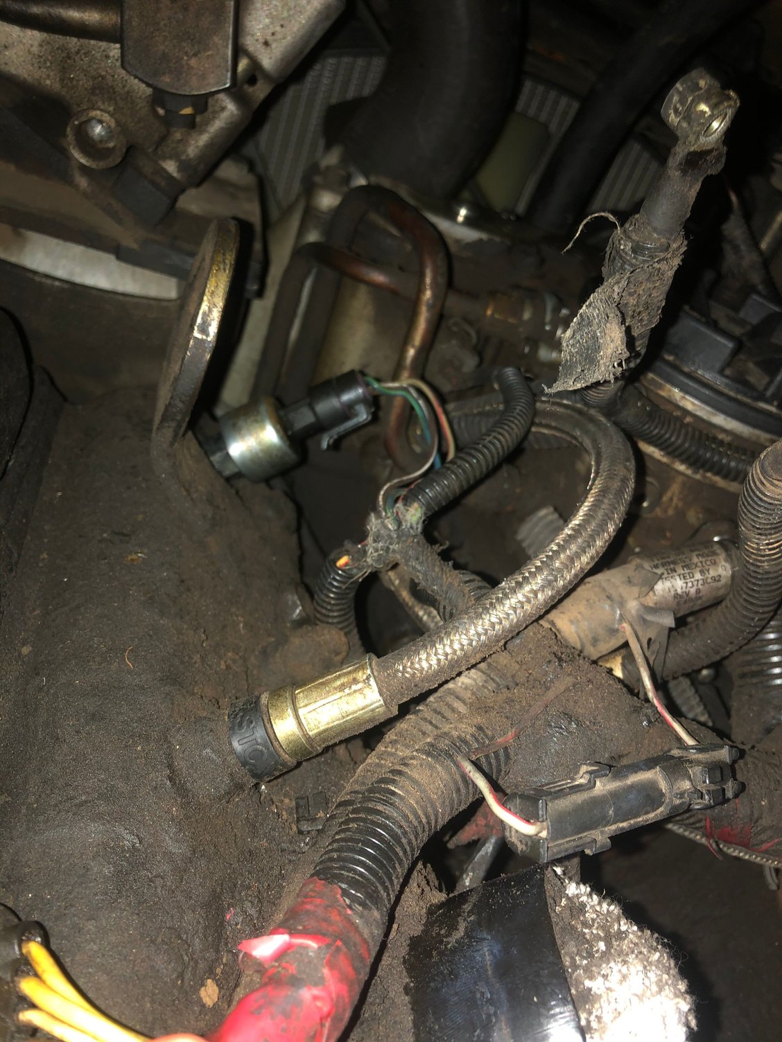

I don't know how hard the h-pop lines are to get to in a van but if they are still originals with the STC fittings I would highly recommend changing those out with riff Raff or CNC fabrication h-pop lines with jic fittings. I think the riff Raff lines come with a rubber coating on them to prevent chafing so that is a plus. Just figured while you have the stuff out of your engine it might be easier to get to. When these lines blow at over 2,000 PSI it will make one helluva mess!! Then you will probably be stranded on the side of the road...

Actually, great idea. I’m going to look into that today..... now that I’m thinking about it, it has braided steel lines for the hpop. That’s not stock is it?

I would say those are most likely not the stock h-pop lines so your probably ok. Just inspect them real good

Also, what’s the difference between STC and JIC fittings??

Braided steel is OEM in HPOP lines.
HPOP side of lines is buried good in a van.
I have driven 50k miles with weeping drivers side head quick fitting.. (holds still 3200psi ICP)
STC = OEM quick connection
JIC = Common tapered hydraulic connection

Thanks for clarifying the hpop lines Finnish, it has been quite a while since I've had stock Hpop lines so couldn't remember . I think the international h-pop lines I ordered a long time ago came with wire loom on them but legalizechey might have had the wire loom deteriorated off of them by now if they even came from the factory with wire loom. Legalizechey if you do replace the h-pop lines ( would recommend the jic fittings) you will want to remove the check valves that rest inside the h-pop where the lines go in. These look like little springs and you can pull them out with a small pick. This will help equalize the oil pressure to the heads.

very good, I checked mine out today. They are OEM
Will do if/when I change them out, mine don’t seem to be leaking as everything around them looks like old grime. They did have split loom on them. I took the one off for pictures
