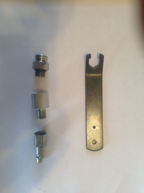

You could use that apparatus to charge the oil rail with air pressure but most of us just build our own kit. Here's mine including a circ saw tool that I modified to remove the HPO hoses. Or you can spend a bunch of money to buy a nicer tool to do the same thing. One of our members named Cody devised this test so we call it 'The Cody Test' and it identified a lot of weak injector O rings. One thing about this test though, you only have about 100 PSI of air pressure and if your O-rings don't fail until the get...say...1000 PSI of oil pressure, that test won't find the leak.

I ended up removing the turbo from its pedestal. Just not enough room to fit hands and tools at the same time going through the front. Made a lot of room removing the turbo though. Pulled the IPR no problem after that.
