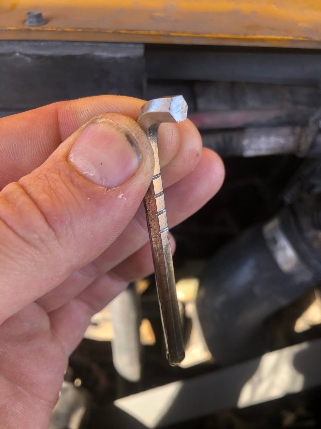

Hello everyone, I have returned with an answer on the hpop res leaking. It does indeed leak.
I used a file to make the notches on the 3/16” Allen wrench. The bottom one is an inch from the bottom of the wrenches elbow....
Friday, I filled the reservoir in between the second and third notch. This morning, I checked it and over the weekend, we’ve lost 1/2 an inch of oil
Old Mar 7, 2022 | 12:16 PM

As you saw from my thread, I'm suspecting the same issue. I'll have to go back and read your symnptoms. My valley did have wet/damp areas when I worked on it the other week, but I assumed that it was fuel and/or from the leaking CCV o-rings. Assumed that I fixed it, but now I'm wandering if I actually did.
Good idea on the homemade dipstick. I might have to copy that in a few days.

I am curious to hear from those who know, if that is an acceptable drop in oil level or not. Off the cuff, it doesn't sound too bad for that period of time.
